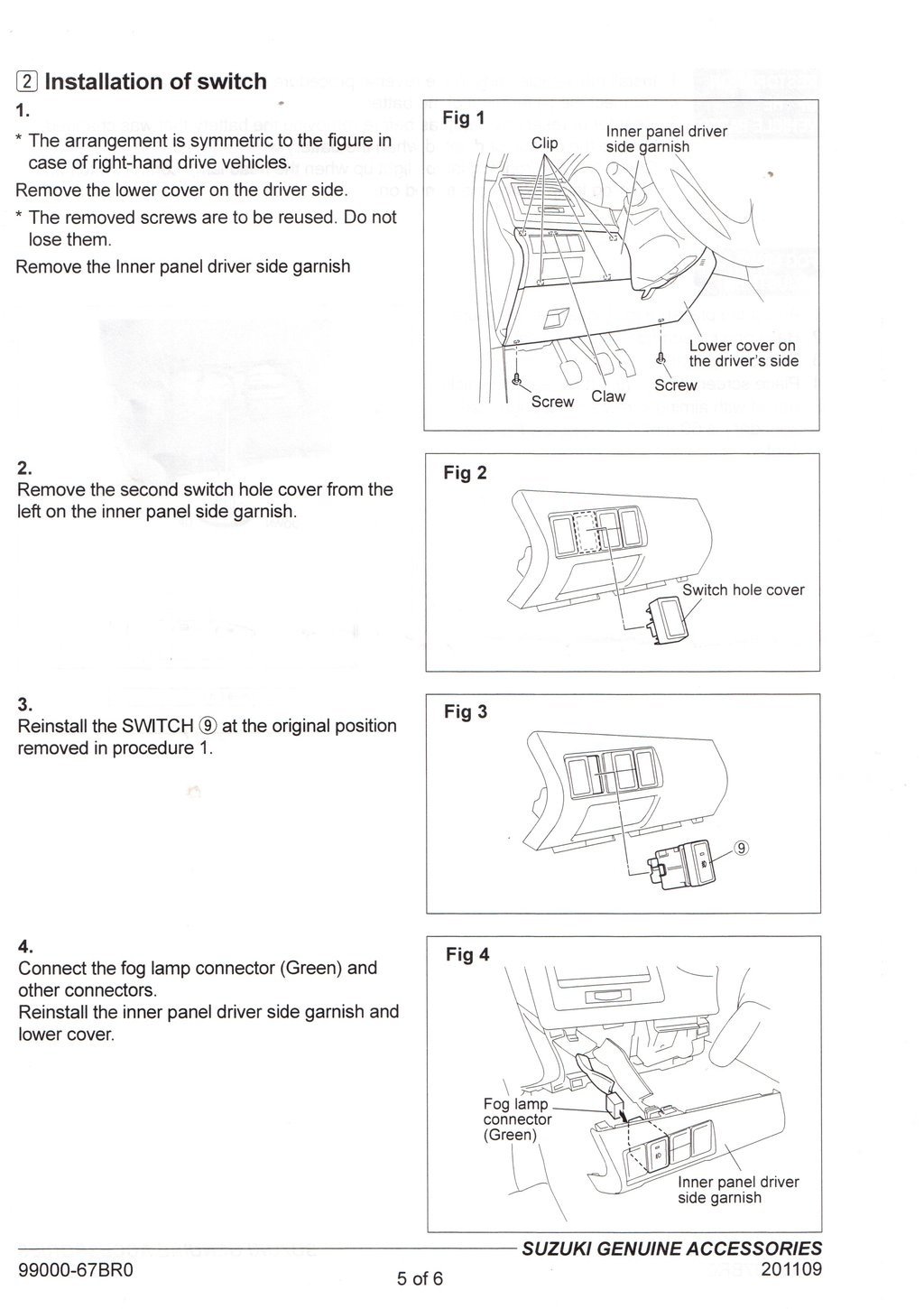

Hi, Could someone tell me how to remove the blank plates where the esp & fog light switches are do they come out from the front or the back behind the dash, i knead to remove one and put a switch in one spot, or do i knead to remove that part of the dash. thanks

I don't know if this will help but here is a page from my oem fog light kit.
I haven't installed them yet but from the pix, it looks like it comes out from behind.
Hope this helps!
