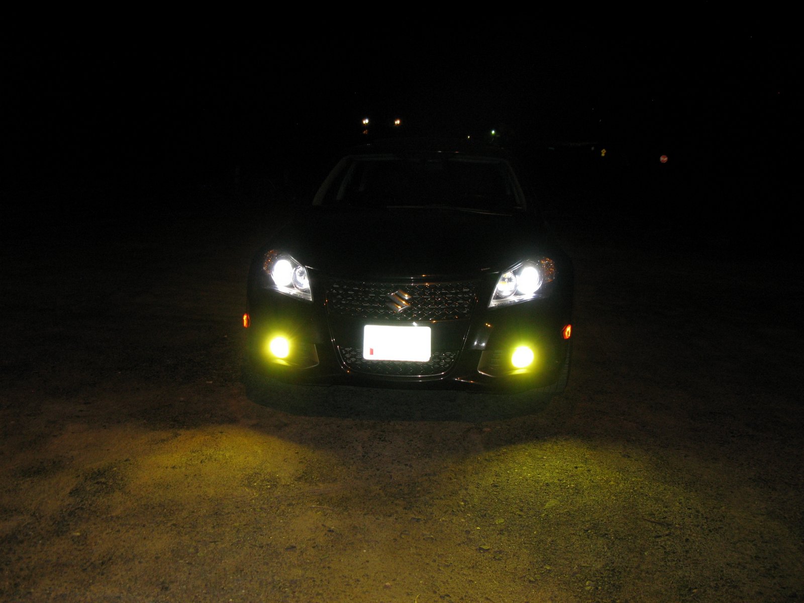

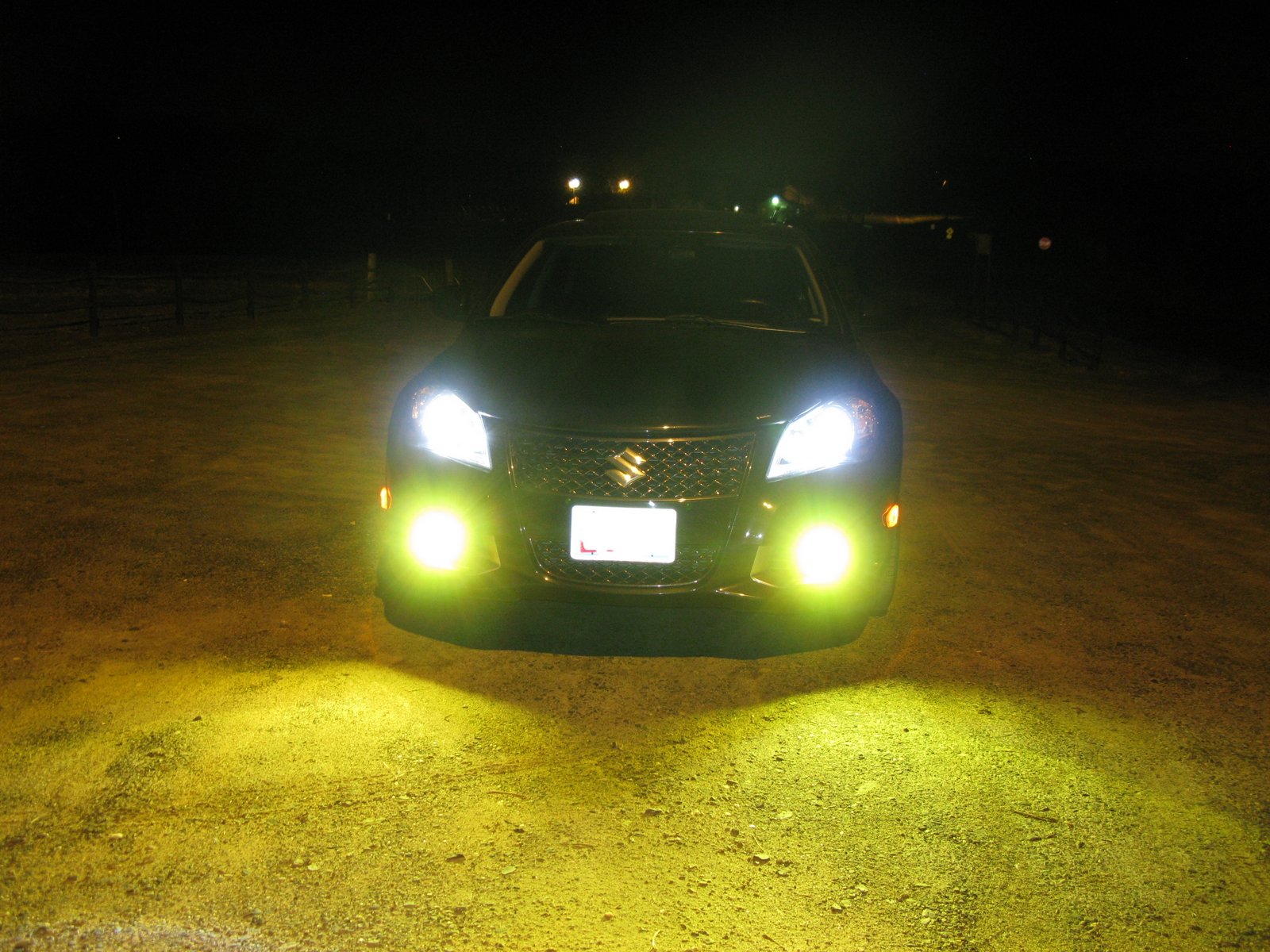

I aimed my fog lights 3-4" higher and what a difference! They're actually useful now. I recommend this before trying H9 bulbs.
No fogs (don't worry about the dark spot, it's the camera being weird):
Fogs:
Factory aim:
Adjusted:

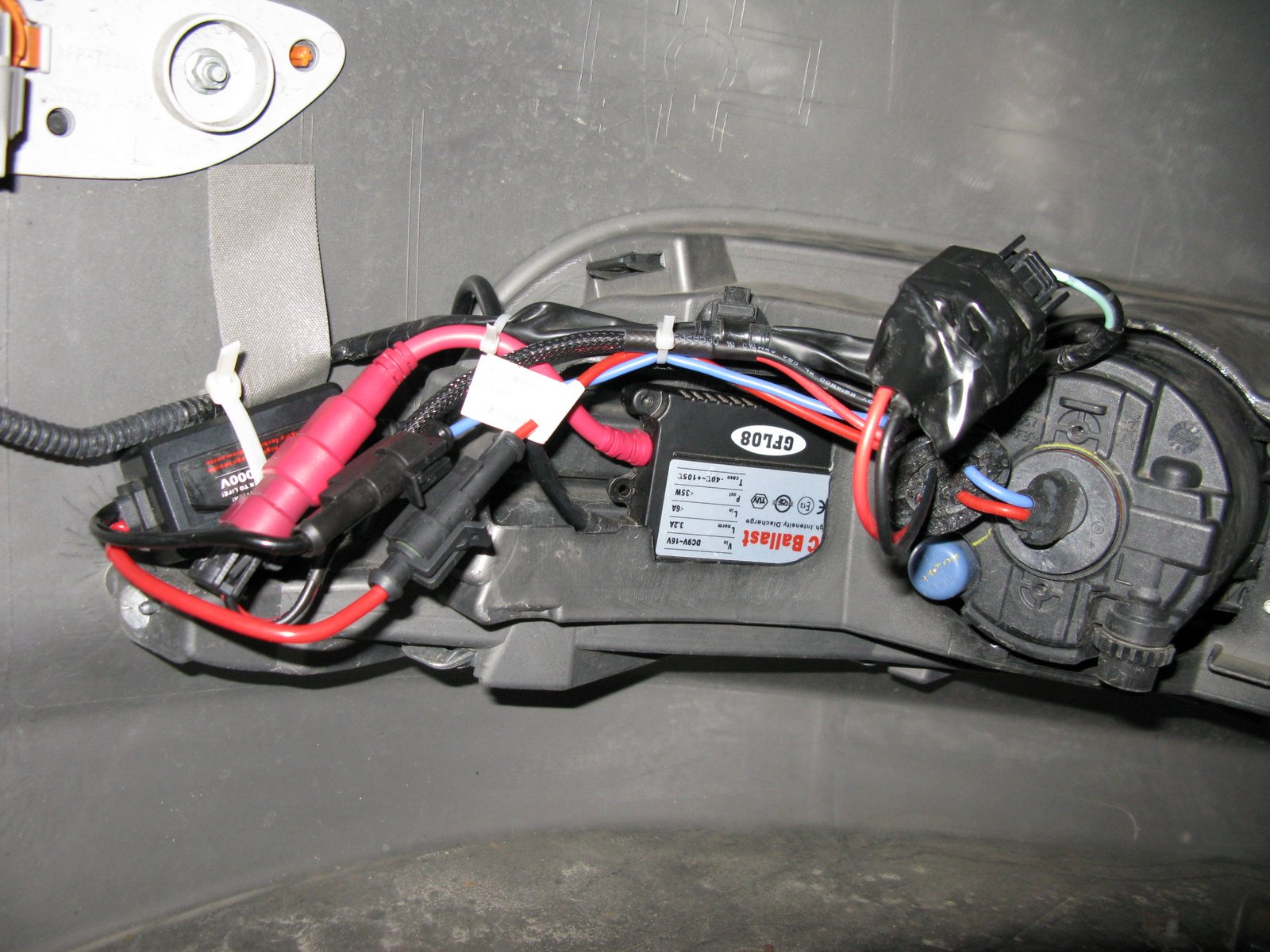

Back on topic: My Morimoto HID H11 bulbs arrived. I installed them and took photos and will discuss it further in my fog light thread sometime later. However, I've come to notice that the bulb color is different, much like the last set. These Morimoto bulbs are still better and now the RHS actually outputs light, but I'm thinking the color difference may be due to the ballasts. The RHS and LHS ballasts differ a bit. I'm not sure what the situation was when the previous owner installed them.
When I have more time, I'm going to test my old low beam ballasts and try to use ones that work well.
I don't want to spend more money on these lights so I'm going to try avoid having to get new ballasts from Morimoto. These new H11 bulbs only cost me $20.
I put in the old ballasts and now the fogs have the same color output. So I'm basically running my old low beam ballasts on the new Morimoto 3Five 3000K HID bulbs.
Here's what the HID set-up looks like as mounted behind the bumper. The bumper actually has a cavity next to the fog light housing that acts as a convenient ballast pocket.
025 edit.jpg (210.11 KiB) Viewed 7672 times
028 edit.jpg (338.36 KiB) Viewed 7672 times
