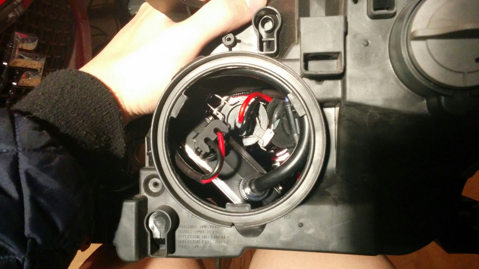

I happened to be inside my headlights today so I snapped a picture of the ballast crammed inside the headlight
Posts: 5270
If you get a kit with the relay harness, you won't be able to seal in the ballast into the headlight like Bootymac's kit. I have a Morimoto kit which uses a HD relay. My headlight's low beam cover has a hole in it with a rubber grommet running wires out of it. The reason being that the ballast is outside the headlight. I could fit it inside, but it's pointless as the HD relay harness has to attach to the ballast so drilling a hole in the cap to allow for that is still necessary.
It's basically a call to make over convenience vs. reliability. The HD relay basically allows for the HID kit to be powered directly by the car battery instead of just the pre-existing OE headlight harnesses. This helps to resolve flickering issues often seen with HID kits. It also helps stabilize and equalize power issues from the ballasts to the bulbs. It consequently helps the bulbs look the same in output and color from each other.
The setback is the extra wiring and harness routing which makes things like putting the ballast in the headlight moot because wires will still have to run out of it. A kit like Bootymac's is solely powered by the pre-existing headlight wiring inside the headlight. Therefore, if you can fit the ballast in there, you can seal it up and have the headlight powered by the single main connector.
