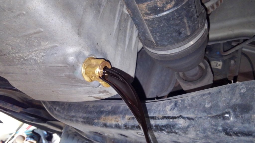

The drain hole for the F-106 will face the same direction as the hole in the oil pan. Therefore, it will always face the rear of the Kizashi. As for the lever, it wasn't hard to get it in the upward position. The washer provided with the valve is felt and allows for some variance in tightening. This way, I was able to position the valve so the lever was perfectly on top after tightening by using an adjustable wrench.LPSISRL wrote:How do you ensure when tightened properly, the drain faces down and the lever up?
Given how well it fits on the Kizashi with no issues, I now somewhat regret not installing a Fumoto valve much earlier. I'll report back on how it drains and seals again once it comes time for an oil change but my prior experience with one on my Impreza was very good.
I should also note that there are different types of these valves. You can get some with a nipple so you can attach a hose. This allows you to easily direct the flow of oil. There are also some accessories like lever clips to better prevent accidental movement. However, I opted for the cheapest version which is the standard valve. Given the Kizashi is a low clearance vehicle with an engine undercover, I didn't feel the need for the options like a hose attachment or clip. After all, it's unlikely the valve will get directly hit by anything and the lever allows for controlling the rate of flow. This not only makes it easier to drain oil, but easier to keep splashes and spills in check.
http://www.fumotooildrainvalve.com/?tar ... lId=472111
I recently changed the motor oil using the Fumoto valve. Given that I installed it at the last oil change, this oil change was the first time I used it on the Kizashi. The valve worked very well and was easy to open with the lever. The lever also controls the flow rate of the oil so you can really prevent splashing and spilling which is hard to do with just a bolt. The oil flowed out smoothly when fully open.
What's also nice is that you can easily close the valve to contain the oil for other steps like the oil filter removal. Given most oil collection pans aren't large enough to cover both the drain hole and the oil filter locations, it's nice to be able to quickly close off the oil drain temporarily to remove the filter. Once the filter comes off and the filter/housing is drained, I then open up the valve again and more oil comes out. The Fumoto valve just makes the process much faster and convenient with less risk of spills and creating a mess.
I only regret not getting one sooner, especially given how well it mounts on the Kizashi unlike my old Impreza.

I've got one of the F-106S valves with the short connector on the end for connecting a piece of rubber or vinyl tubing. Car goes up ramps, under body shield comes off, short length of tube goes on with opposite end in empty 5qt jug, open valve (wait). When its all done, pull of the tubing, cap the jug, minimal mess, and I can use my oil pan to do the filter while the car is draining.
Nice. I was thinking of getting that but I got the F-106 given it was cheaper (maybe on sale at the time?) and posed the lowest risk of clearance issues. I think there are 3 different types per model. I also typically don't have an empty oil jug until the fresh oil goes into the engine so I use an oil collection container. It's after the oil change is complete that I then pour the used oil from the container into the jug and then take it for recycling. I also occasionally get my Mobil 1 from Costco which sells them in a case of six separate quart-size bottles.bdleonard wrote:I've got one of the F-106S valves with the short connector on the end for connecting a piece of rubber or vinyl tubing. Car goes up ramps, under body shield comes off, short length of tube goes on with opposite end in empty 5qt jug, open valve (wait). When its all done, pull of the tubing, cap the jug, minimal mess, and I can use my oil pan to do the filter while the car is draining.
