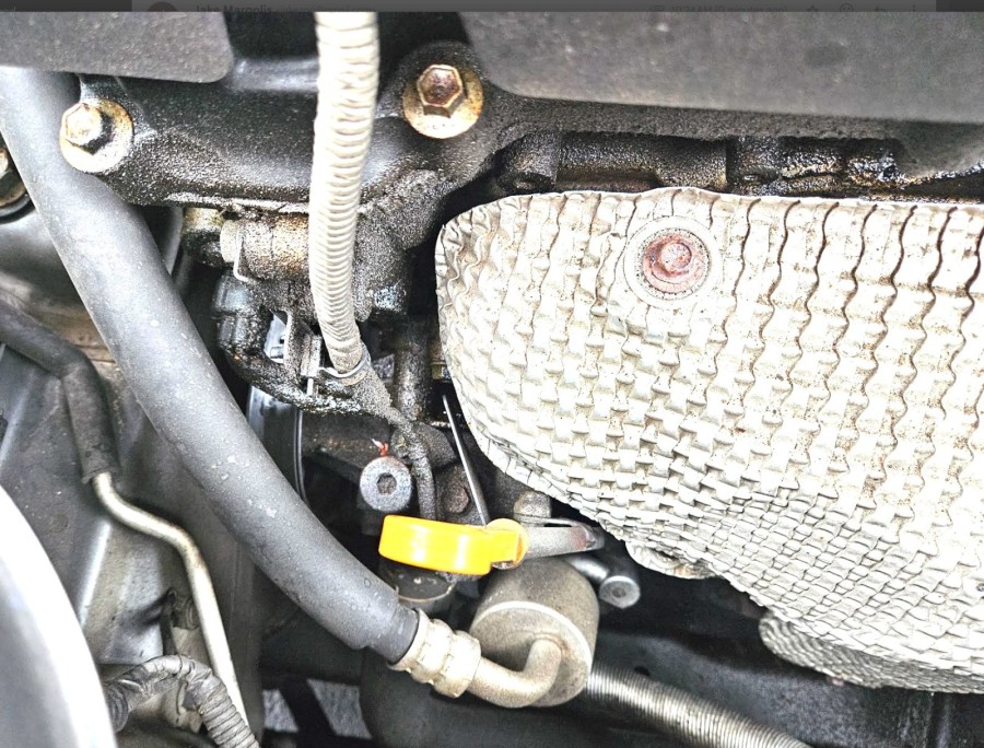

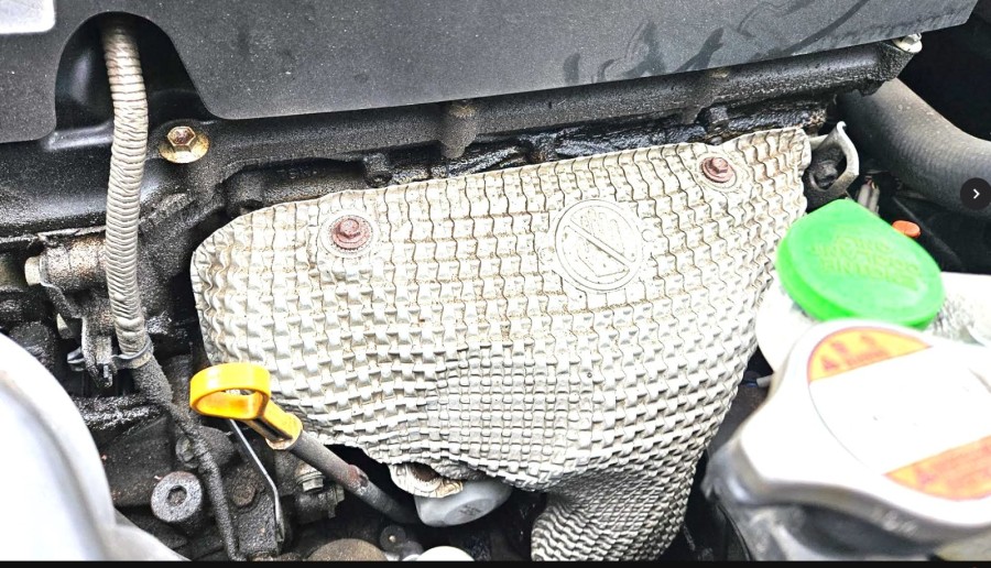

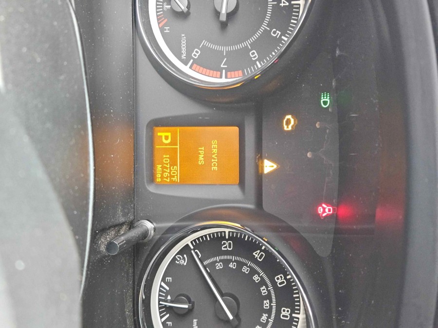

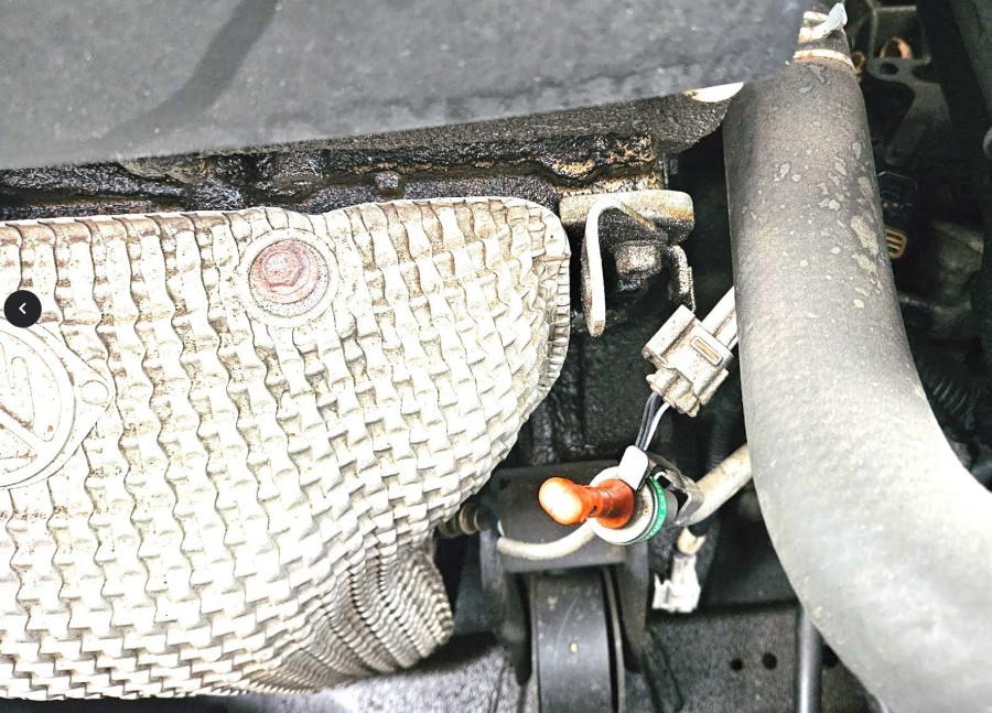

Here are some pictures. My mother just had a min-stroke in PA, so I may come up this week anyway. If I get this thing on a truck on Tuesday, I assume it would be there Wednesday, and you think I could be driving back Friday?

old tech wrote: Fri Jan 17, 2025 10:34 pm Use my quote for price comparison. I deal with the Kizashi's daily. Your primary pulley is jamming . Transmission needs overhauled . Oil leak is oil pressure sensor , valve cover gasket , front crank seal, and or vvt solenoid. I would be replacing what was necessary one or all if needed and combining with the large transmission job for a deal and with a year warranty . All needed parts on hand here . I think Ammco will be over twice my quote and take 2 weeks or more due to parts .You seemed desperate and I'm trying to give you something to go off of . There is a chance that it's a stepper motor but not likely. A quick look into the pan would tell us a lot. I know that you're a long way away, but wanted to make it worth your while if you are willing to make the trip.
