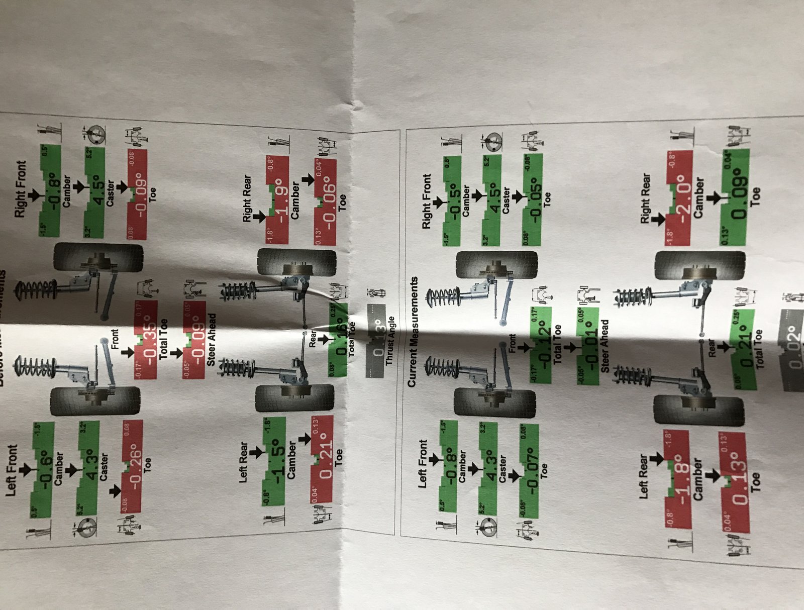

So looks like the tires that were on the front are wearing more on the inner side. Which is exactly what happened with the last set. all even on the backs. Still don't understand why the backs are down to 7 already

I attached my last alignment sheet does it look right?

Scar
Posts: 1
Joined: Mon Apr 03, 2017 1:58 am
jadeng97 wrote:So got my inspection done today. Passed. But, tires are already down to 7/32 after only about 6k miles. Last set only lasted about 15k before they had to be replaced. I know they are known to wear fast but this seems a bit ridiculous especially since it cost almost $700 to have them installed. Anyone else wearing this fast?
What kind of tires do you have?
Also, how are the tires wearing? The earlier Kizashis (MY 2010 and 2011) came from the factory with bad alignment at the rear. This lead to rapid uneven wear of the tires. Suzuki has since issued revised specs for alignment.
My OE Dunlops wore out at about 33,000 miles and the insides were thread-bare. I've since replaced them with Michelin Pilot Sport A/S 3 tires which have been excellent and wearing evenly. I also got an alignment job to correct the factory issue a while before and also when I got the new tires. I have about 30,000 miles on them now and they look like they will make it to at least 45,000 miles.
Anyone know what the new alignment specs are?
viewtopic.php?p=10208#p10208
Thew new specs should be in the machine they use to do the alignment. They're updated regularly. This was only needed when Suzuki first released the change, it's been five years now, everyone should have it.
