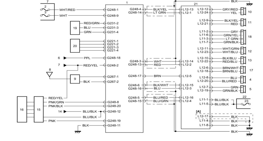

I received the amp and I have a question, If you look at the picture you can see some wires are in a bundle:
Can someone with the Rockford Fosgate setup tell me if the gray wires run trought the car, seems like they are extra isolated.
Klaa$vaak
Verzonden vanaf mijn iPhone met Tapatalk
@Klaa$vaaK, those are audio in of AMP and covered with shield signal connected to body ground all of this info is shown in the wiring diagram. you need to read the service manual for more information and signal description.
