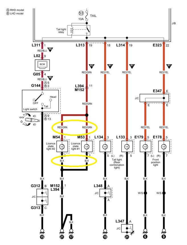

Power for rear tail light and license plate are the same, came from Fuse 53(TAIL) on J/B so if you have no problem with tail light fuse has no problem. my guess is lossy connection on tag light try to use multi meter or voltage tester and check both power(RED/GRN) wire and also GND(BLK) wire.
also LED bulb usually has polarity, check it.
this is wiring diagram
New Bitmap Image.jpg (76.41 KiB) Viewed 7940 times

Awesome! Thank you. Thank you for the diagram.
