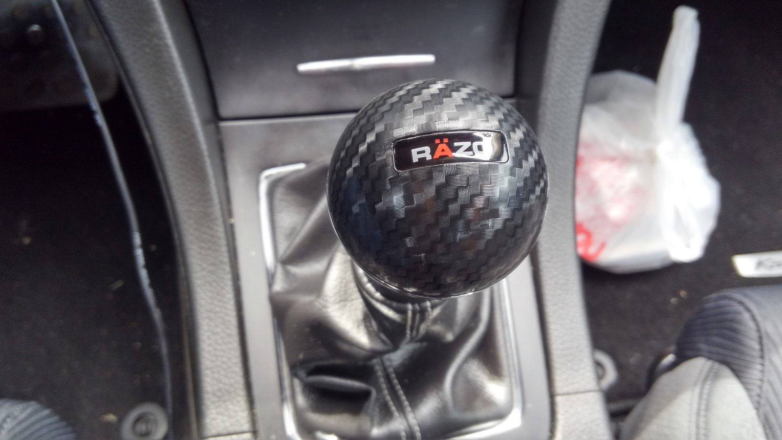

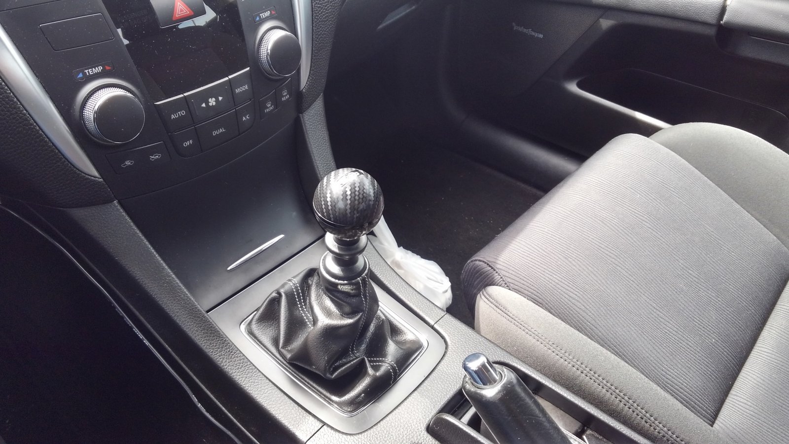

M12xP1.25 - That's the threading for the shift knob. I know this because I have a custom knob and looked into the matter about 5 years ago. I ended up getting a universal shift knob that came with adapters in Japan. The only issue was that the shift collar position varies from car to car so it's not like the shift knob can be fully screwed in and everything work perfectly like the knob was specifically made for the car like the OE knob. Fortunately, I used some Gorilla glue once I found the perfect fitment and it's been solid ever since.
I've posted about my knob in the past and here's a picture from then. It looks exactly the same today. No wear or tear, largely because I avoided a leather or metal one; having had both in the past.
Metal ones get f*^king hot in the summer heat and also get scratched up over time. Leather ones wear out and get ugly wear patches. Mine is a weighted resin with a textured finish.
