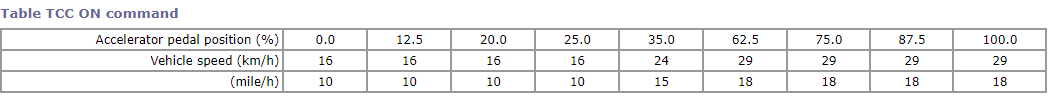

Does anyone happen to know the relation between the throttle position sensor and the torque convertor lockup on these cars? Is the lockup adjustable via the TPS is what I am getting at or not related at all? I ask because my TPS voltage on my truck directly affects lockup of the convertor

hillboy73 wrote:Does anyone happen to know the relation between the throttle position sensor and the torque convertor lockup on these cars? Is the lockup adjustable via the TPS is what I am getting at or not related at all? I ask because my TPS voltage on my truck directly affects lockup of the convertor
With the electronic "drive by wire" throttle in the car, there is not a TPS as such. The pedal sensor is used as in input for the computer in the car to control the throttle. The accelerator pedal position does impact when the torque converter lockup is allowed to occur, however any change to that would impact the way the accelerator pedal itself works. For those who are curious, attached is the data table from the service manual
TCC Table.png (4.86 KiB) Viewed 7839 times
