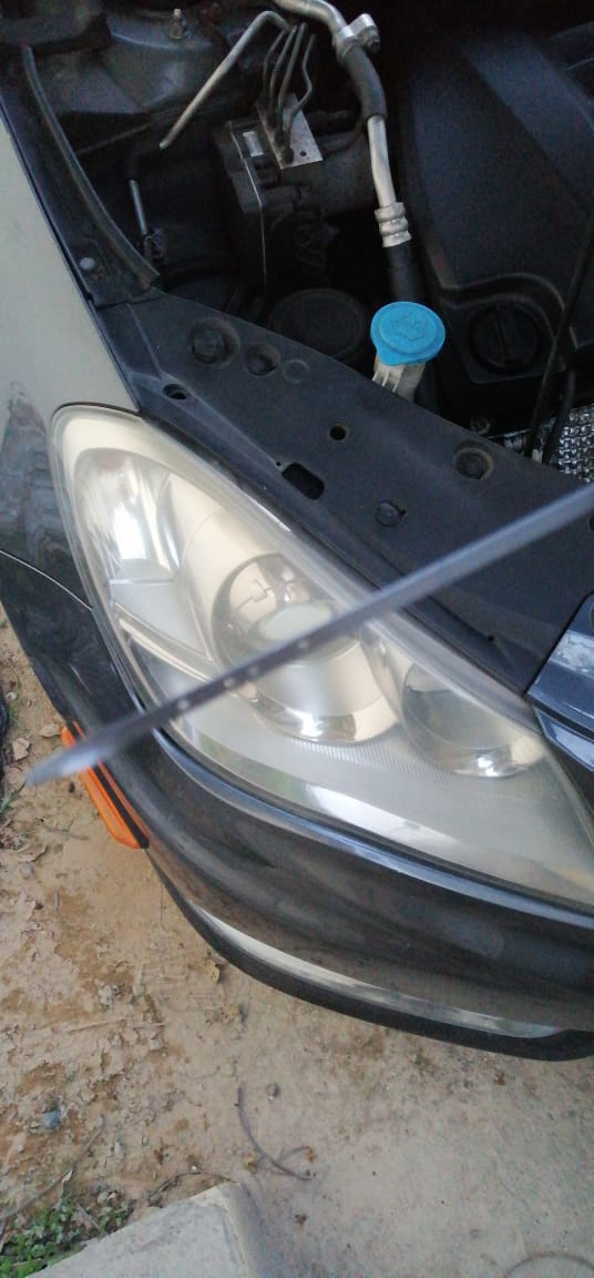

My 2013 Have Stick With Holes, That Indicate The Transmission Was Changed For 2010/2011 Model :lol: :lol:
Stick In Kizashi 2013

Quimicax wrote:The Right Stick Is For Last Model Of Kizashi? 2012-2013?
As I recall, due to the deeper pan the 2012/2013 would come with the longer stick, pictured on the left. The TSB about the pan / stick was around here somewhere. I'll see if I can hunt it down.
EDIT: See attached. The longer dipstick goes with the new, deeper, pan

The longer dipstick still has the holes. So without measuring it, I can't see enough in your picture to tell
