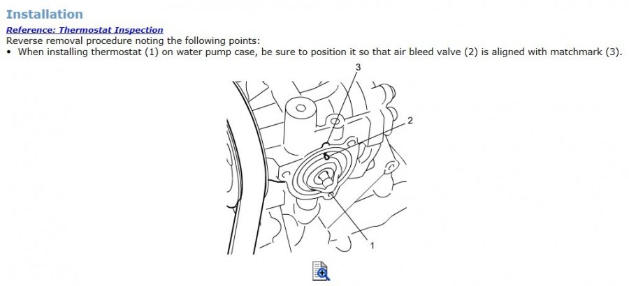

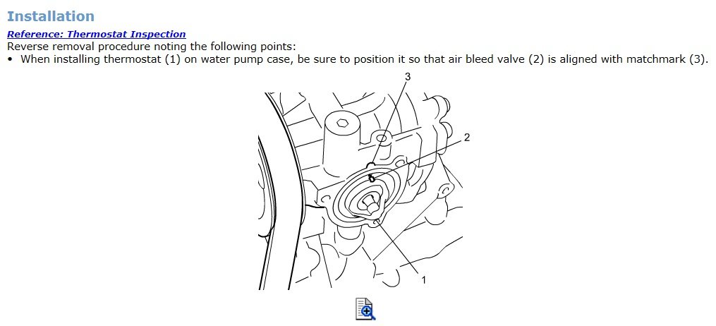

I think the thermostat has a bleed valve did you install it correctly?

It's hard to know if it is closed. I just replaced the thermostat and it is still not getting past the thermostat. I definitely installed it correctly with the bleeder at the top. I replaced the water temperature sensor, the thermostat, & the coolant. The thermostat is attached to the water pump, so something is making me think that the waterpump is not letting the water move past it to the thermostat at a reasonable rate of speed. The lower hose should be warm after idling for 30 minutes and raising the rpm's to 2400 for 5 minutes. Definitely getting heat into the car, but it stayed cool until I drove it. It overheated as soon as I put a load on it and drove it a few miles up the street. THEN the gauge moved over to hot, came down about 45 seconds later, then got hot, and the gauge started to approach the red line. Lower hose was still cool. Upper hose was VERY warm

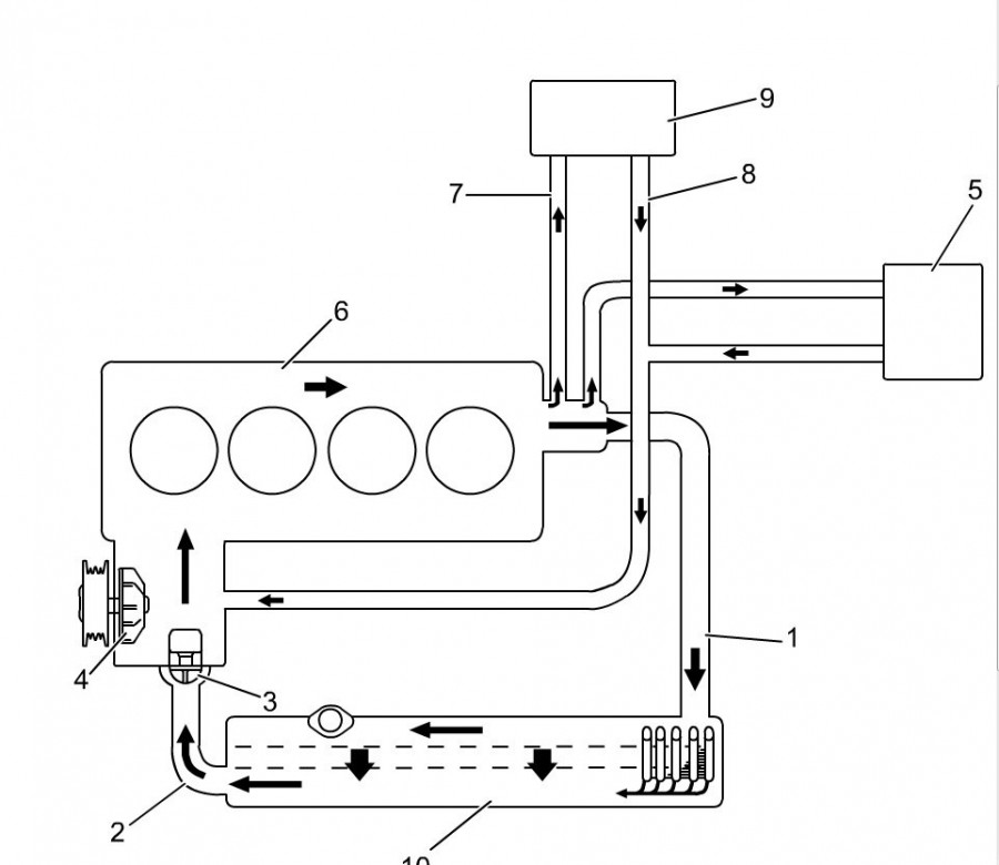

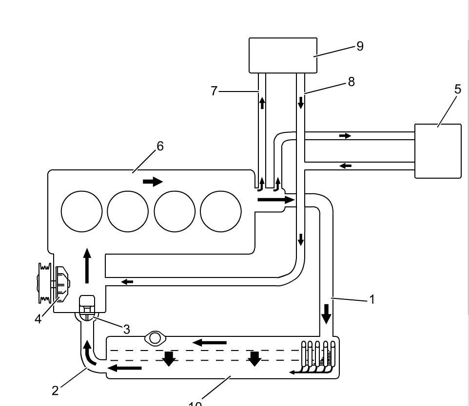

according to the service manual flow of water is from the radiator into the engine through the thermostat so it gets hot water last.

Now I'm worried. The antifreeze was super clean when I drained it. No rust or scale or anything nasty. It was a clean blue. I can't understand why, but maybe maybe the radiator has an issue. I guess the best way to find out is to close the draincock, and pour water into the upper radiator inlet and see if water comes out of the lower radiator hose?? I just bought a new water pump, and although the old one sounds a little noisy, it should've still worked. I always thought the the water pump fed water to the thermostat, not the other way around. The thermostat was tested in a pot of water that I had a temperature of 180, then 185, then 190, then 200. The original began to open at about 188 and didn't fully open until it reached approx 205 or so. I bought another one and it opens a little earlier.
