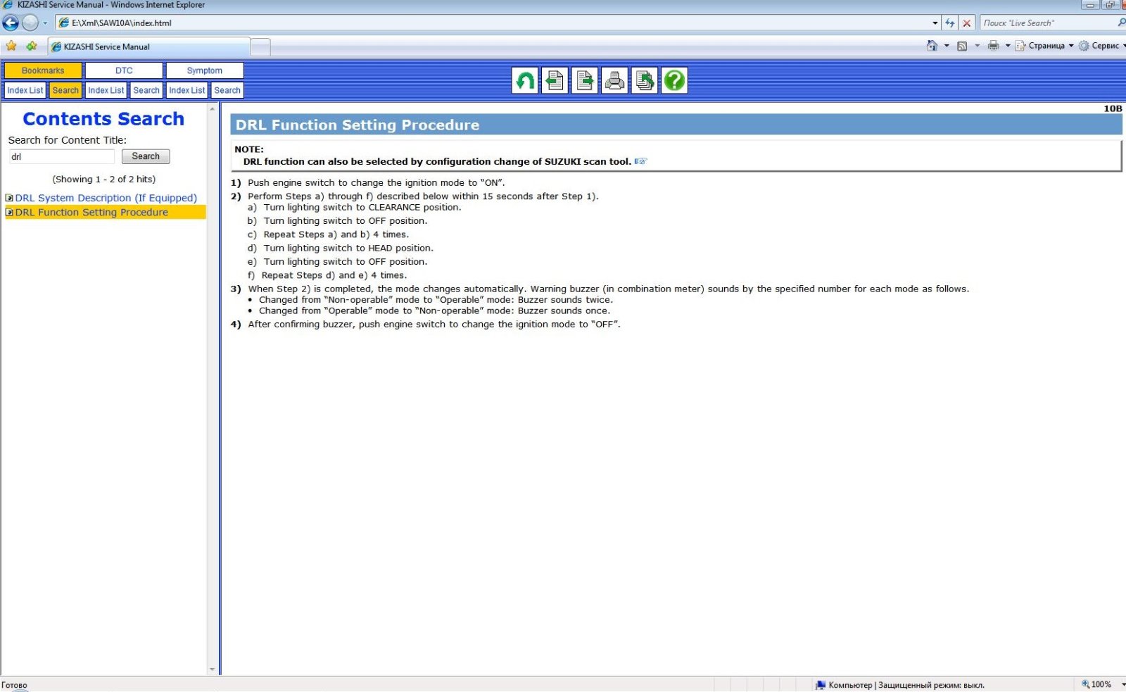

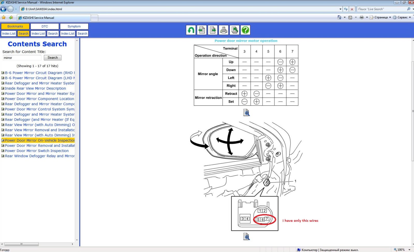

I have only this wires (see attached file "Connector"). All fuses I checked. I think must be code like DRL (see attached file "DRL"). I hope that some people knows it!
I agree with KuroNekko. There must be an aftermarket module somewhere. Pins 3 and 4 are needed to control the motor inside the mirror to fold the mirror. look for aftermarket wiring first from the mirror assembly into the door trim.
