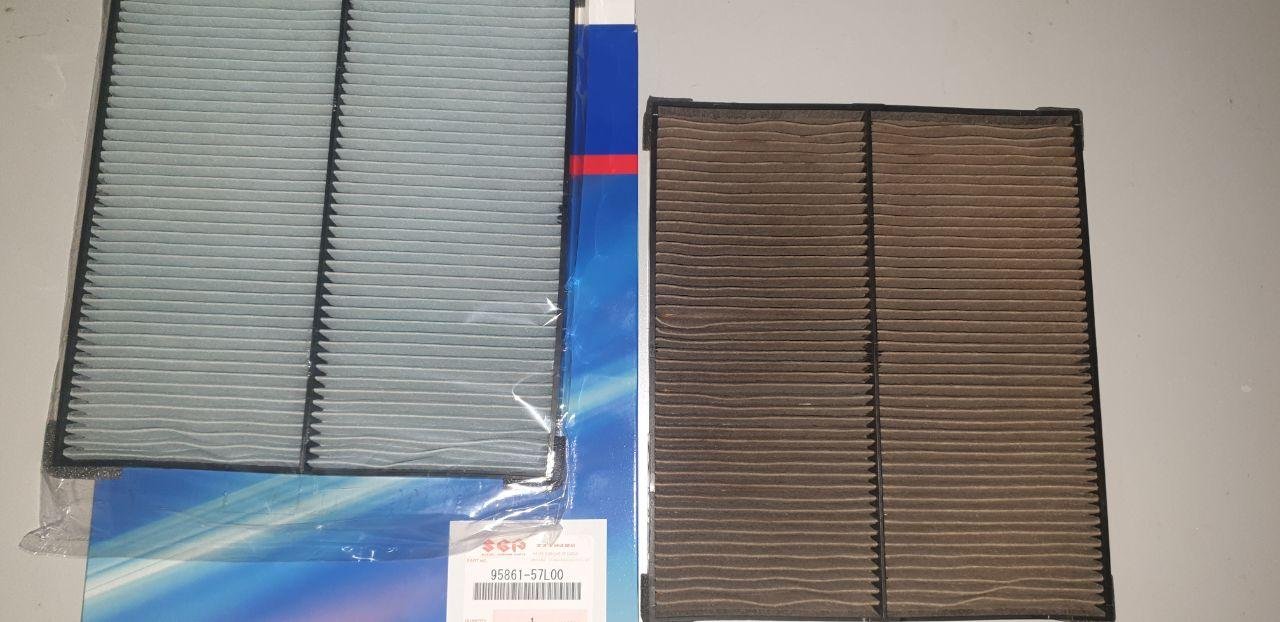

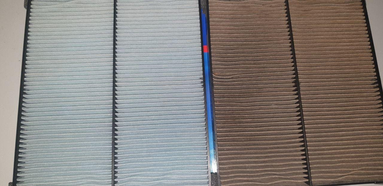

change cabin Filter after one year around 20K not bad for OEM

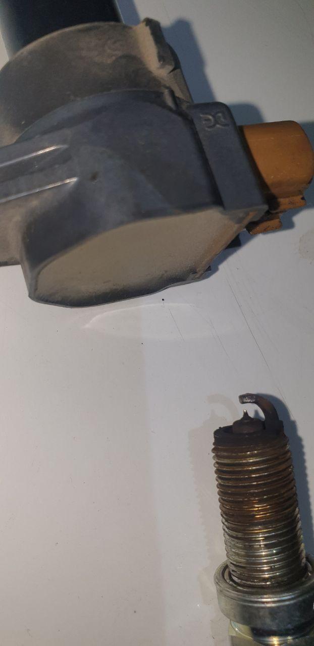

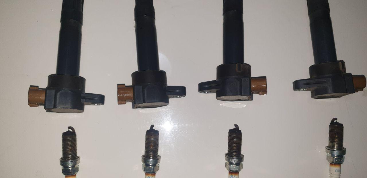

Today I checked spark plug and coil and also take some photos from inside of Kizashi cylinder by cheap Endoscope camera. my car is currently at 150Km and sparks plug at 50Km.

Damn This Piston Looking Really Good Condition, Dont Have Carbon Build Inside

Cabin air filter - easy but even more scarce

Spark plugs - Was surprised to see how worn the plugs were...60k miles as per the recomendation and central electrode was quite worn, gap on all were between .08-.09. Also noticed oil leaking into plug tube from valve cover so I replaced valve cover gasket.
