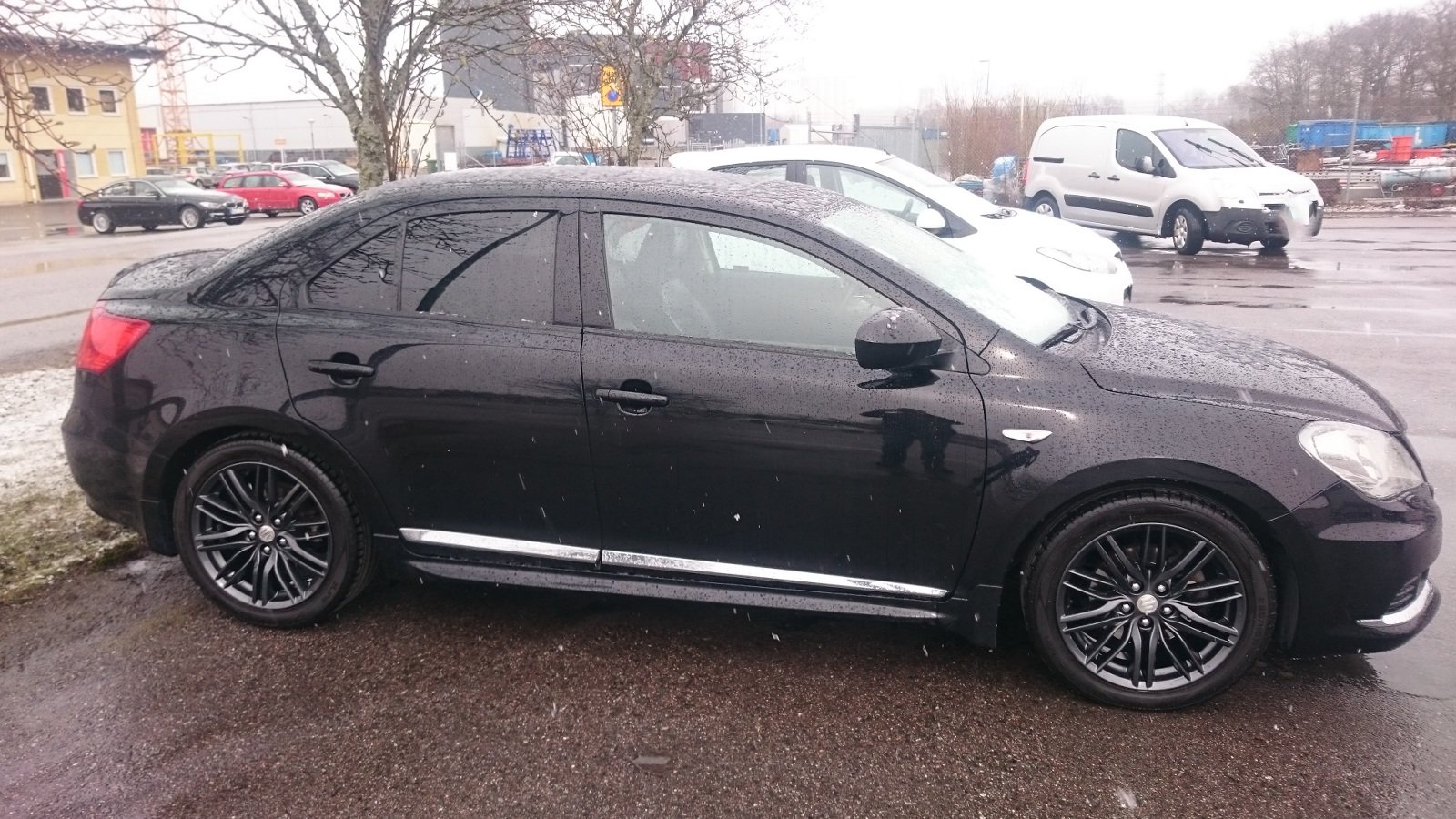

kizashi 6mt black
The winter is coming soon and I will have to change the tyres. Saying so, I saved the wheels from my previous car. The wheels are 5 spoke original wheels from Suzuki Vitara, and I put the Nokian winter tyres 225 45 R17 on it. The tyres are fast new and I only drove them 3 months last winter. However, I recently looked at the user manual and unfortunatelly Suzuki mentiones that for 17 inch Rim should come with 215 55 tyre. That means that I can not fit the old tyres on these rims, and I will have to buy the new ones. My only concern is will Kizashi look somehat silly wit those relatively fat tyres with 55mm sidewalls? Should I better buy the 235 45 R18 winter Tyres and put them on OEM wheels, and then buy some new aftermarket wheels for summer tyres? Is Kizashi somehow more comfortable on 55mm tyres, and does it affect the handling performance in a big way? Any suggestions or opinions?
A 225/45-17 tire+wheel combination is about 5% smaller in diameter than a 215/55-17. This is outside of the typically suggested +/- 3% fir tore sizing, but as long as the load rating on the smaller tire is appropriate for the vehicle, it doesn't present any particular safety concern. Your speedometer would simply read about 5% off. In this instance 5% smaller tire diameter means that with the smaller tires installed if the speedometer read 100, you would actually be going 95.NickL wrote:The winter is coming soon and I will have to change the tyres. Saying so, I saved the wheels from my previous car. The wheels are 5 spoke original wheels from Suzuki Vitara, and I put the Nokian winter tyres 225 45 R17 on it. The tyres are fast new and I only drove them 3 months last winter. However, I recently looked at the user manual and unfortunatelly Suzuki mentiones that for 17 inch Rim should come with 215 55 tyre. That means that I can not fit the old tyres on these rims, and I will have to buy the new ones. My only concern is will Kizashi look somehat silly wit those relatively fat tyres with 55mm sidewalls? Should I better buy the 235 45 R18 winter Tyres and put them on OEM wheels, and then buy some new aftermarket wheels for summer tyres? Is Kizashi somehow more comfortable on 55mm tyres, and does it affect the handling performance in a big way? Any suggestions or opinions?
If you wish to use the 17" wheels but want a more substantial tire a 225/50-17 (1.5% smaller diameter than 215/55-17) or 235/50-17 (identical to stock diameter) should fit on the 17" rim, and fall within the typical +/- 3% guideline. That said, I have a set of 215/55-17 Nokian tires on my car, and they perform perfectly fine.
