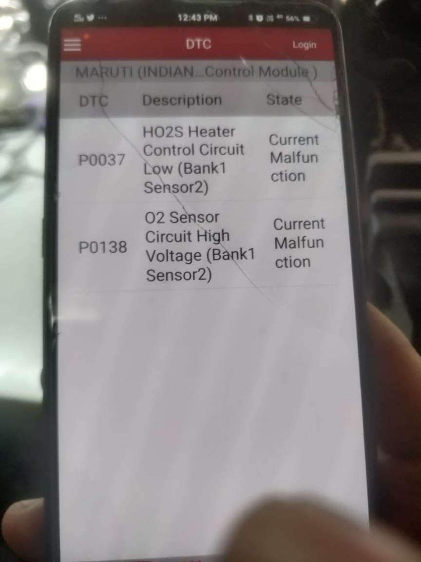

Hey, I went to a local mechanic and got it checked. There are two codes, and both seem to be related to the oxygen sensor.
I'm attaching a picture, so if any of you guys know anything about these code, or have dealt with them, please lemme know

Two different codes concerning the rear O2 sensor, sounds like an electrical problem or maybe a bad sensor. The heater for the rear sensor is not working, and the rear sensor is reporting a rich condition (too much fuel). If it's truly rich that could damage the catalytic converter, but it seems strange that the rear sensor says too rich and the front sensor sees no problem.
The proper way to diagnose this is to tap into the electrical connector for the rear O2 sensor while the engine is running and see what the voltages are. Inspect all connectors and wiring from the sensor to the PCM (computer). Unplug and replug all connectors between the two.
