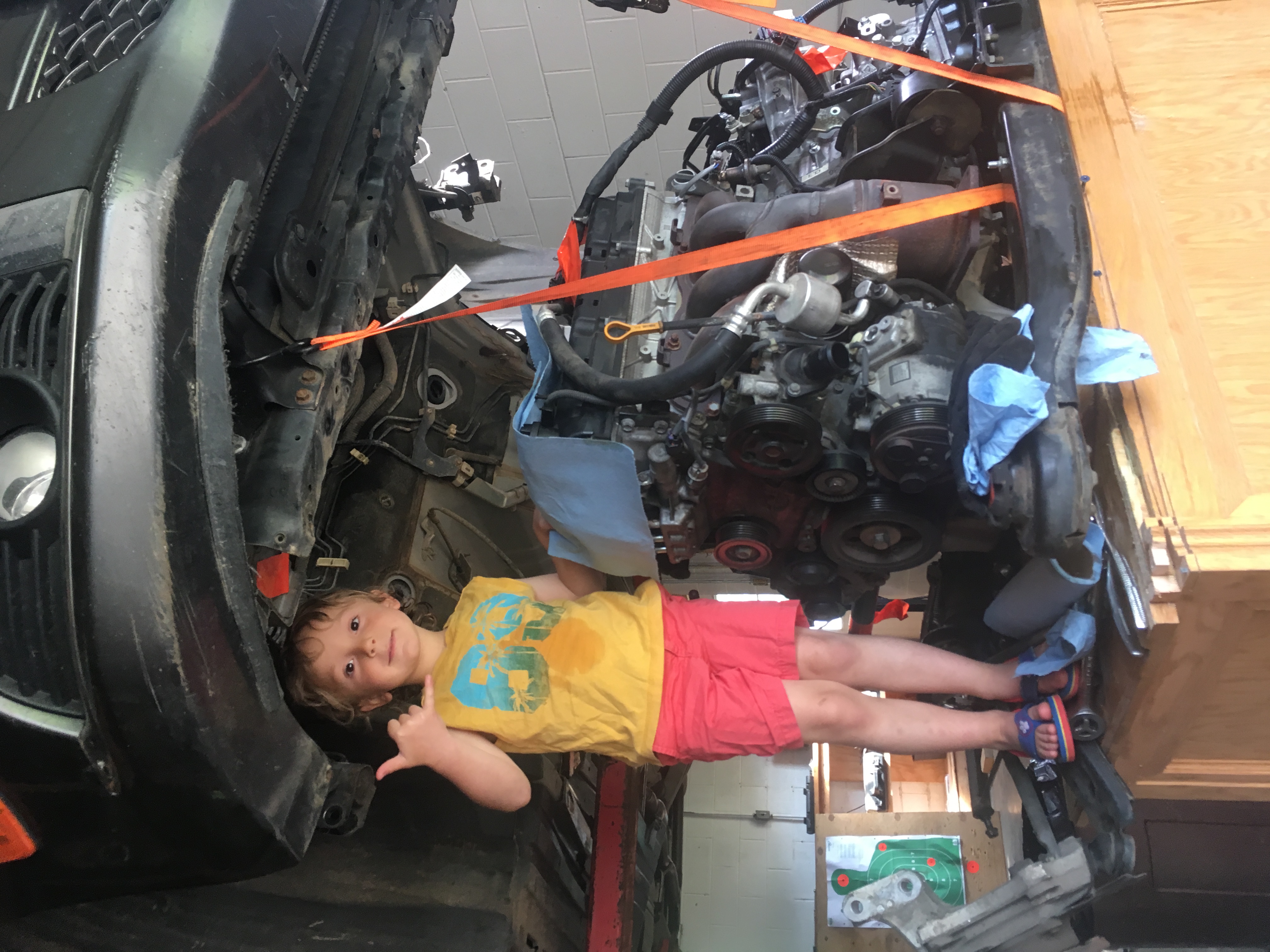

Hello fellow Kizashians. My 2013 AWD driving better than ever. 60k on DIY transmission over 5 years ago. My daughter just got her license, and we got her in a 2012 AWD since she loved mine. She couldn't be bothered coming and having me check the car. Didn't change the oil even though she was driving it a lot. I got a call she was broken down and I get there, and the car was running but was holding up traffic, so I just rolled it off the road. It never started again. It basically won't crank and when I try to turn the crank it won't budge. The motor is toast. When I drained it was a couple quarts low.
When I replaced my CVT I removed everything from underneath. Was not too hard but it was a 5 year old car. Now here I am needing to replace an engine in a 13 year old car which I already know will be harder than the first one. I am evaluating how I can pull this motor out the top and was hoping that it's been done. I did a Honda CRV out the top and was told it couldn't be done. The car still ran when it was junked 100k miles later. My concern with the Kizashi is will there be enough room to move everything over so I can access the torque converter stuff. I am excited to hear what the consensus is on this. Either way I need to do it just hoping to not need a lift this time. Thanks! Chris

You definitely can just pull the engine out of the top although you must get the engine to turn so you can get all of the torque converter bolts out. The biggest problem for most is getting the converter to slide back and stay with the transmission. The torque converters nose is a little bit longer than it needs to be and gets easily bound up. You really need the torque converter to stay put why during this procedure of removing the engine. I recommend leaving 2 adjacent bell housing bolts in place and backing them out a 1/4 " at a time keeping engine/ transmission gap even and walking back converter . Don't pull those bolts until you have freed converter. When reinstalling make sure torque converter, bolts do not get substituted with any other bolts. They are a special length and the other bolts will damage the converter thus damaging your transmission. There are five silver bolts and one black one you'll want to start with the black one as it has a centering taper on it.
