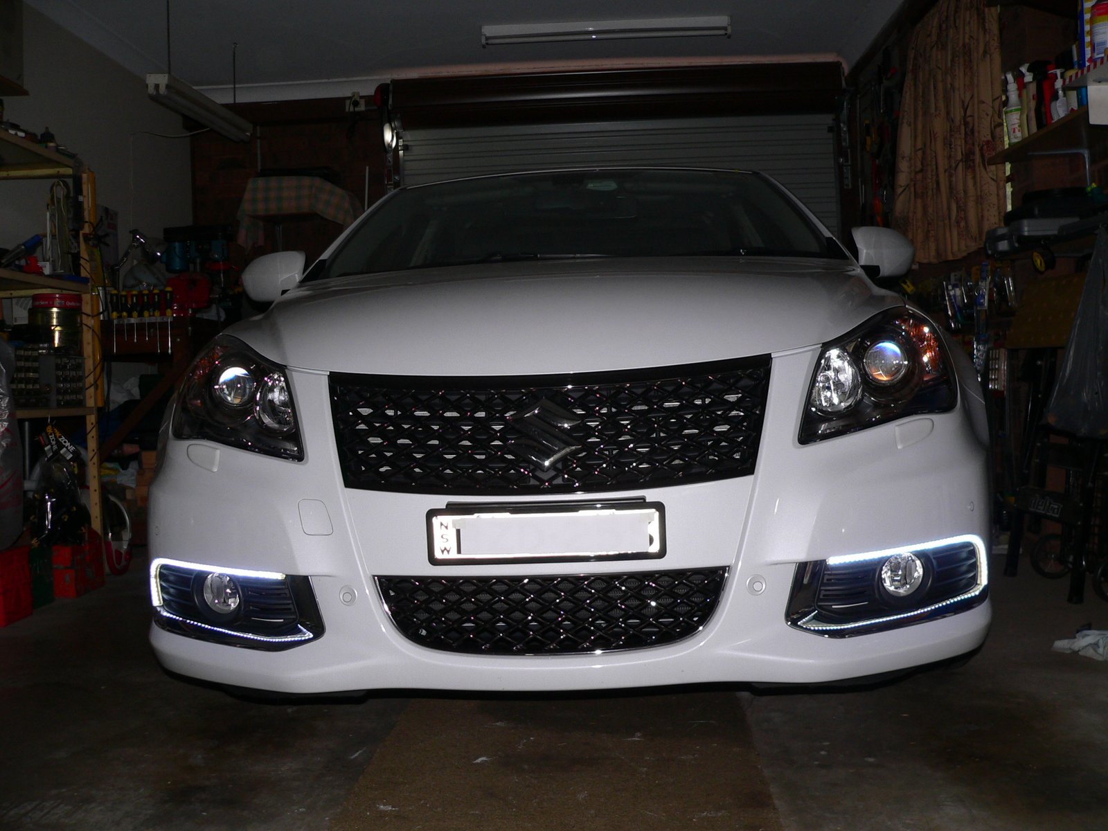

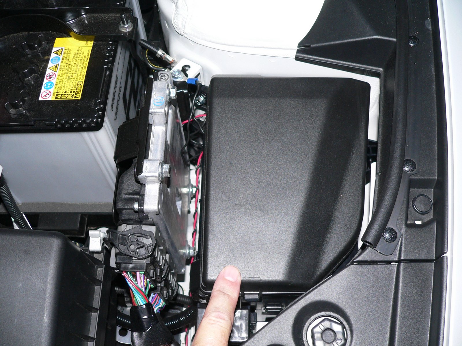

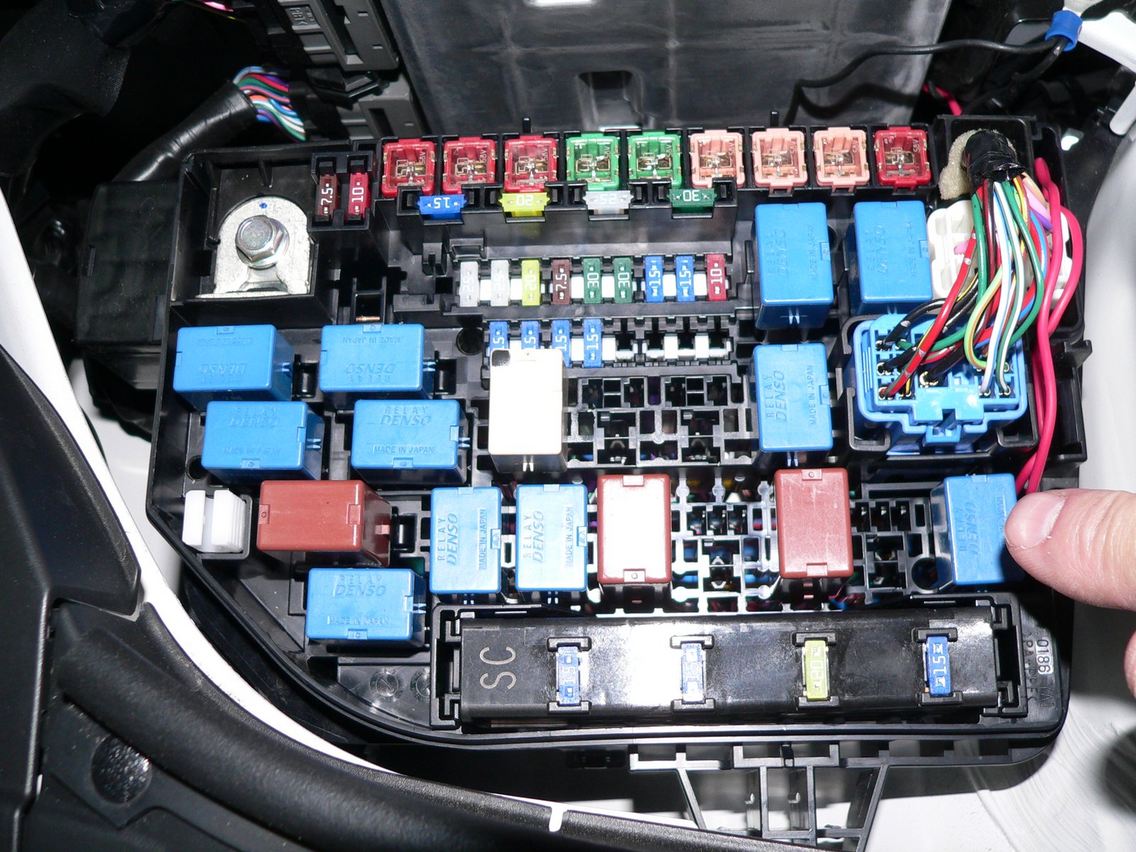

Well this is what the LED strip lights look like. Don't bother attaching them with double sided tape as I first tried that & they stayed put for about a week before starting to peel off. I then used Selleys quik grip advanced which goes on white & sets clear. This works well but notice that one of the globes on the lower end on the drivers side has already gone & they are only a couple of weeks old & I am not sure how easy they will be to remove should more go & I have to replace them. I thought these things supposed to last for ages? (not happy Jan). Anyway, you will have to attach extra wires as the lead isn't long enough to reach the power source. The engine bay fuse & relay box is located near the battery. Open the lid & power is sourced from the rear demister relay as indicated by my finger (thanks to a previous post for this info). Remove this relay & insert the 2 positive wires into the slot for the rear pin closest to the firewall as this one is powered with ignition then reinsert the relay. You can see the 2 red wires that I refer to. It's a bit crude but it works & saves you cutting or splicing any wires etc

Sorry, forgot to mention in the pic showing the relays you can see a blue connector top right of the pic with 2 black wires. That's the earth for the LED's. The earth is actually outside the relay / fuse box but I fed the power wires in from the bottom so I could close the lid without having to drill entry holes in it. Find the access hole, poke down a piece of stiff wire, connect this to the 2 positive wires & pull them back up

Thanks for sharing that! The LED's look great. I'm certainly going to put them on mine now, but perhaps in a different position. Will post some photos up to show once I'm done. :)
