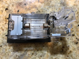

I screwed up the small metal brecket conduit - it popped out. So I ordered a new holder from ThatGMPartsGuy in Chicago area (about $22), which came with a bulb . I took a picture.
IMG_0776 (1).jpg (35.52 KiB) Viewed 20323 times
To get this in, I followed the above steps - then I found that there is a flat bracket that goes all the way across from the left license plate light holder to the right. The bracket is removed by unscrewing the plastic knobs which are located about on the outside of the plate light holders - and by removing the two larger head phillips screws on the trunk handle and letting the handle drop. Once you pull the bracket back toward the inner part of the trunk, the light holders pop out easily.
So you don't actually need to buy a new plate light holder of course because you can pop these holders out and that makes it much easier to pop the bulbs in.

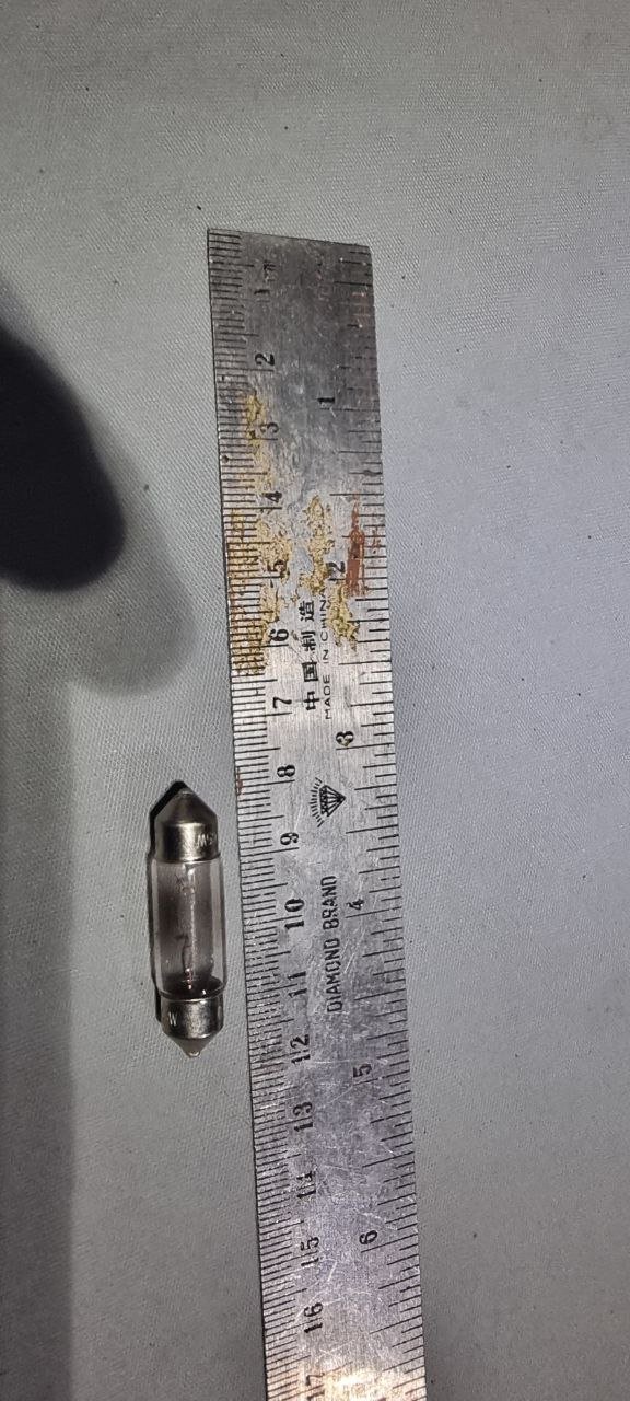

Learned last night my left bulb is out. Funny how in a lot of the how-to videos I found (for other cars), and in Petr’s images, the left bulb seems to die first more often. Going to AutoZone soon and replacing the bulbs tonight.
I wish I knew why Suzuki used this bulb on the Kizashi; other Suzukis seem to use the more common 194/168 style bulb, and so do most other cars. The only video I saw use this pointy pill style bulb was a Mini, of all things. The guy used a tool that looked like a dental scraping tool to hook around it and pull it out. Why does this bulb even exist :lol:

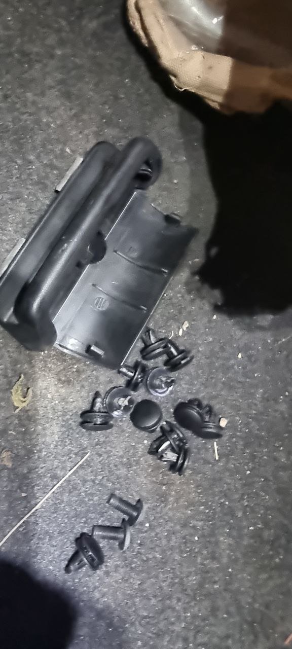

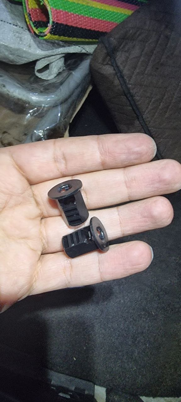

Ok it took me a while like I knew it would, and replaced the burnt out bulb. I didn’t replace the other bulb because I didn’t have enough time. Took forever to remove the bulb and then replace it with the new one. And then I had trouble trying to put the black plastic clips back in to hold the trunk lid trim. I broke three before I gave up lol.
Does anyone have any tips for how to reinstall them without breaking them? I feel like I’ve handled this type of clip before on a different part of my car, but for whatever reason I can’t get them to go in this time.
The trim seems okay since I was able to reinstall the handle, and getting that piece of metal by the emergency opening latch through the hole in the trim helps keep it up. I’ll try the clips again tomorrow. I also took some pics to fill in some of the experience of the bulb change, and I’ll add them to this post later.

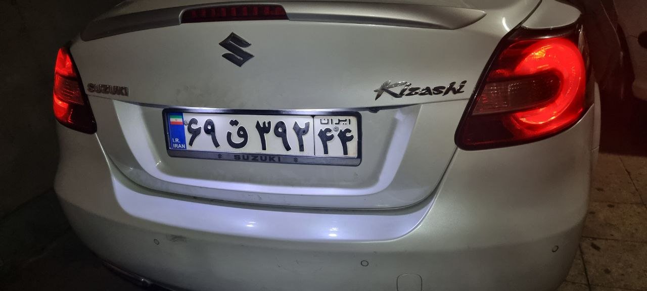

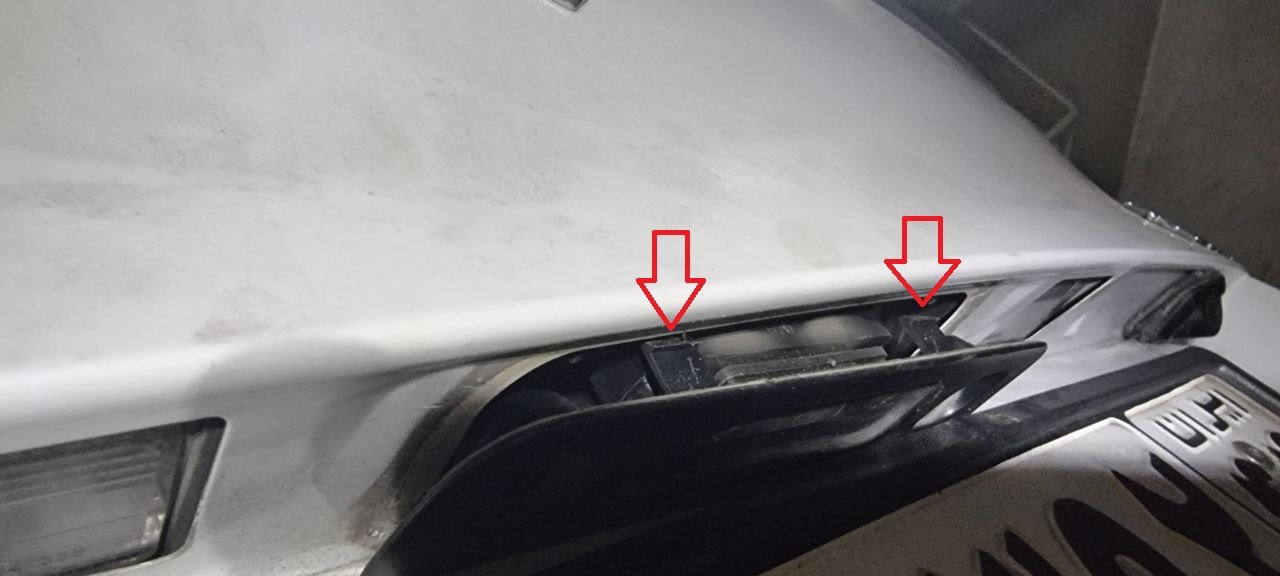

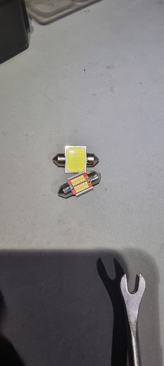

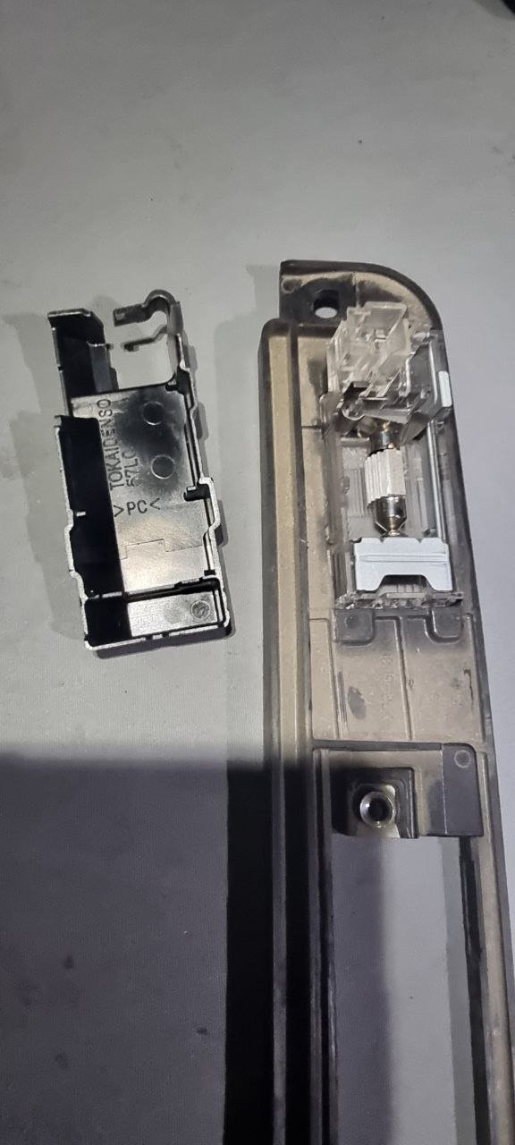

I just changed mine with a new LED type 36mm but decided to remove the whole LED assembly from the car and install it on the bench. I remove 2 Phillips screw bolts from the outside and 2 plastic on the inside and carefully release 2 plastic tabs separate led from the switch as shown in the pictures below.
