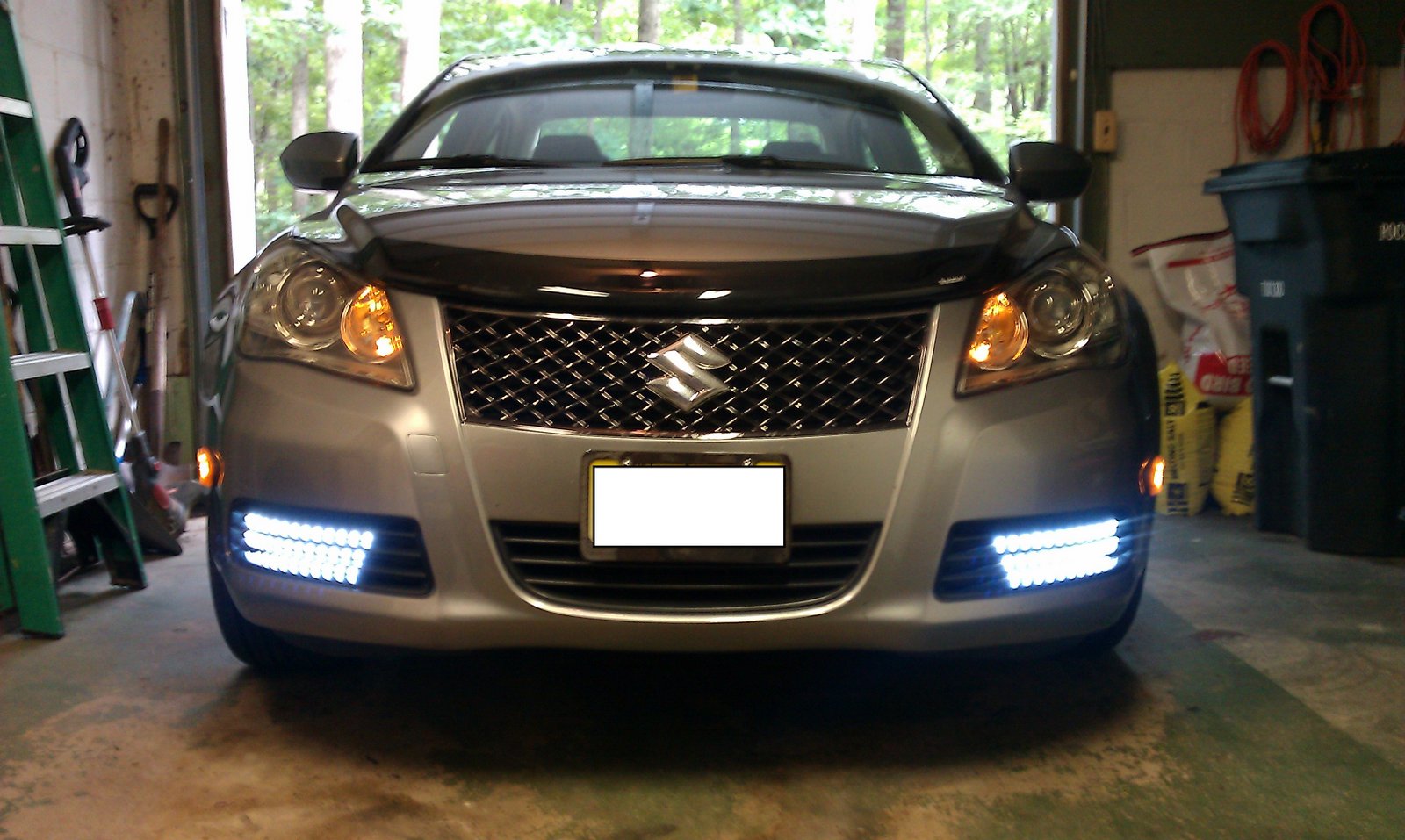

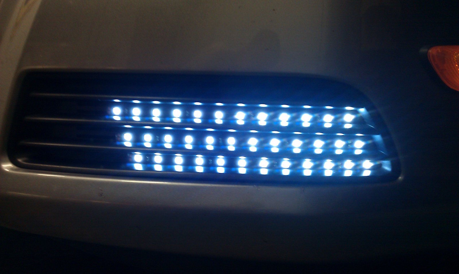

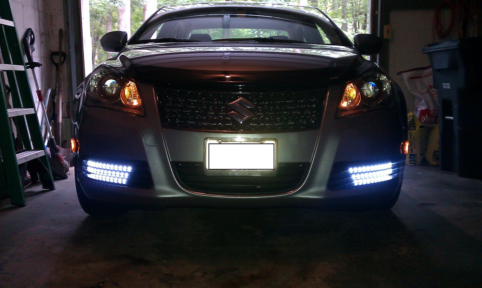

I think it's a little too busy for me, one strip on each side looks perfect imho
but as long as you like it~~

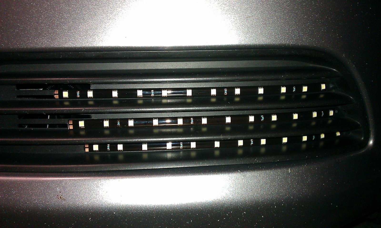

I just tapped into the +/- leads going to the side markers (yellow) about 1 foot away from the installation. There are only 2 wires on each side, and they are red and black so easy to identify. I used these wire splice connectors to keep it clean and made sure everything was finished off with electrical tape. I also bought 2 extra led strips just incase of failure, since they were cheapos from china.

1) I did not have fog lights
2) I had to remove the bumper. This sounds intimidating, but it is really easy. Just screws along the bottom, a couple in the wheel wells, and 3 on top of the grille. Just pops off.
You pretty much have to do this as the fog grilles are screwed in from the back. It will be much easier for you to access and do the wiring this way.
