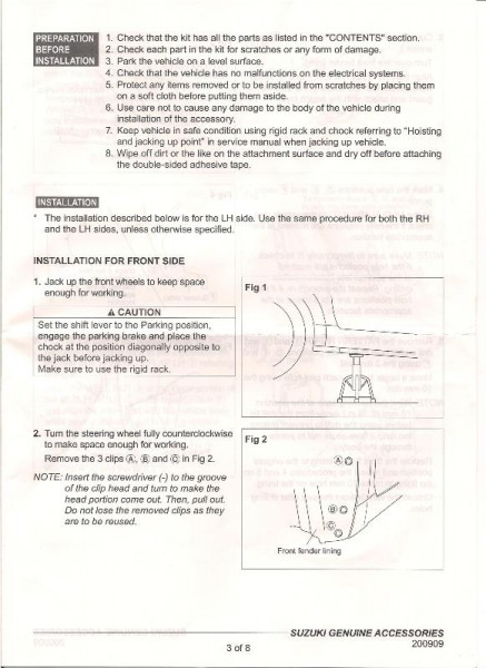

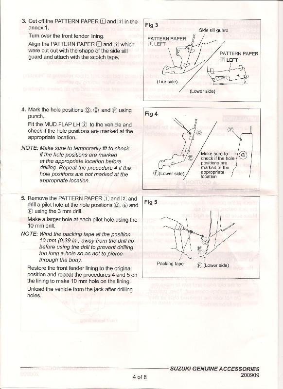

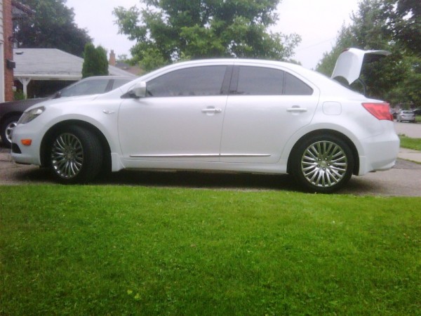

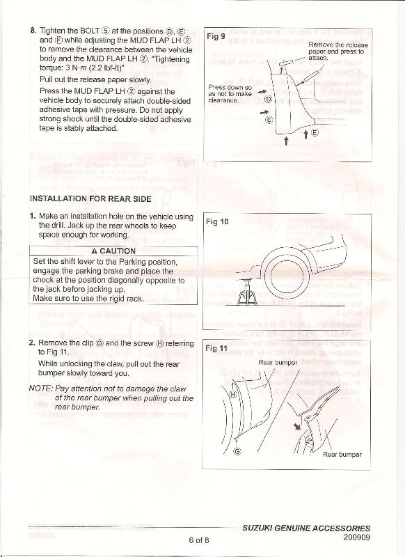

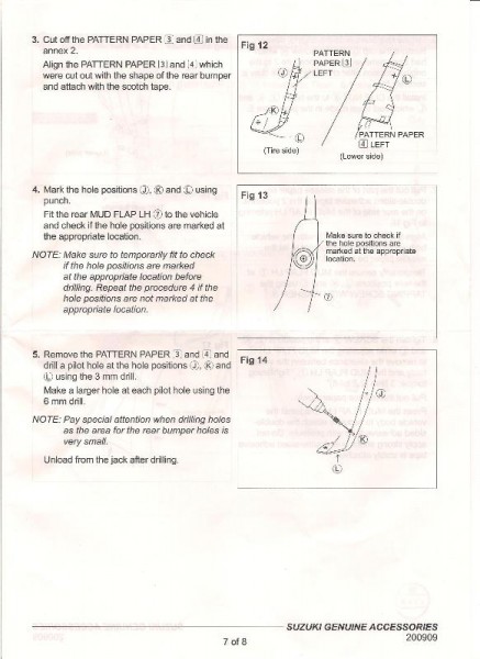

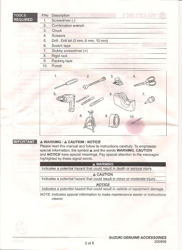

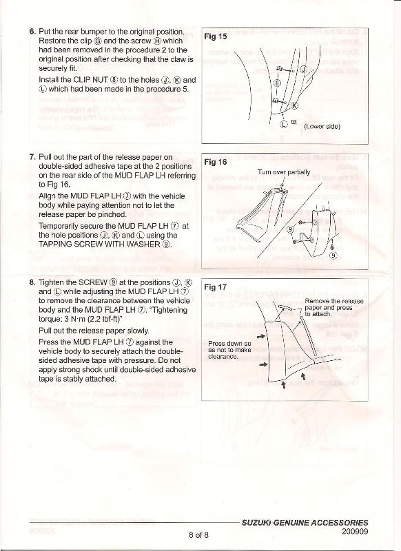

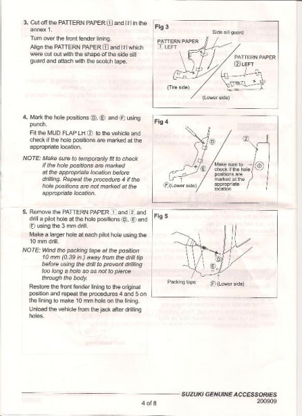

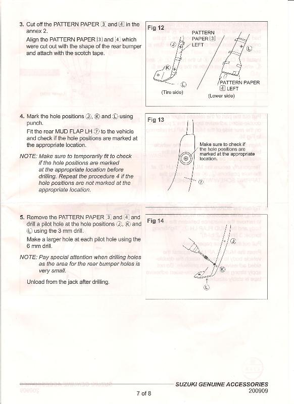

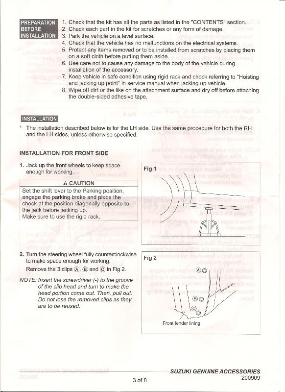

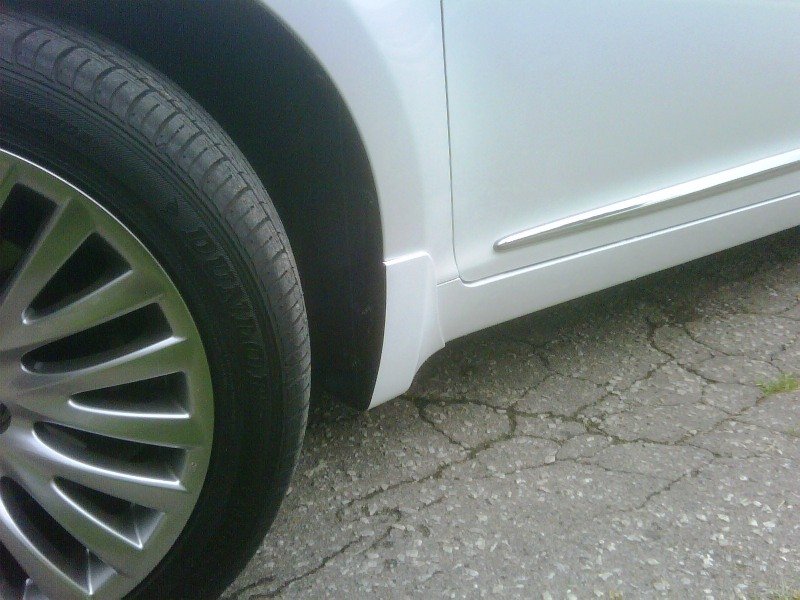

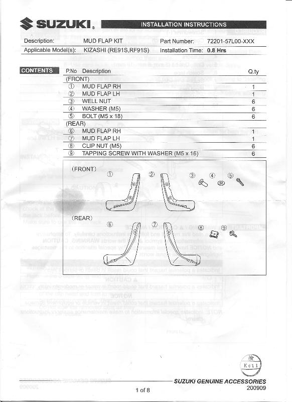

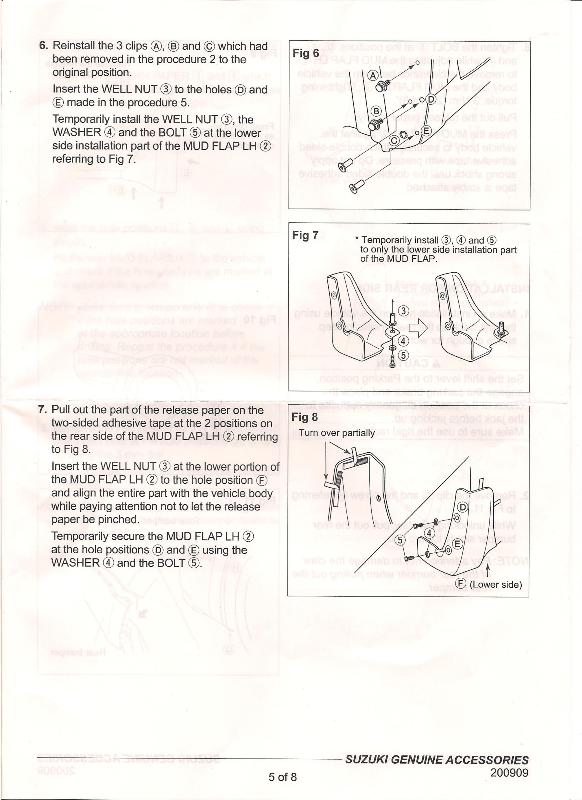

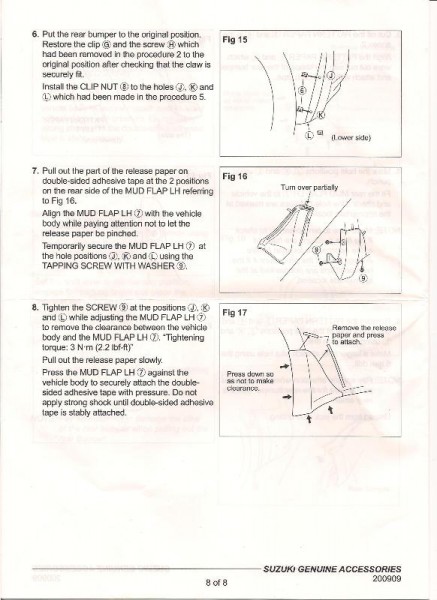

I installed the mud guards today. I painted them and turned out nice.
I scanned the installation manual if you'd like to know how to install install the mud guards.
Key phrase:
kizashi splash guard installation manual.
kizashi mud guard installation manual.

that looks really classy especially now that you have painted them.
Thanks for the manual..it's good stuff :mrgreen:

I ordered the paint from an auto body supply. They will match any paint color and put it in a spray can.
They can only match the base color and not the glittery/pearl effect because in order to get the pearl effect it has to be a three stage paint: Base-midcoat-topcoat. I skipped the mid-coat(pearl effect).
Materials used:
1 can Plastic Primer (i used white)
1 can Base Coat - (custom color)
1 can clear coat
1000 and 2000 grit sandpaper - used to sand down imperfections.
painter's tape - mask parts not to be painted.
optional: buffing compound
