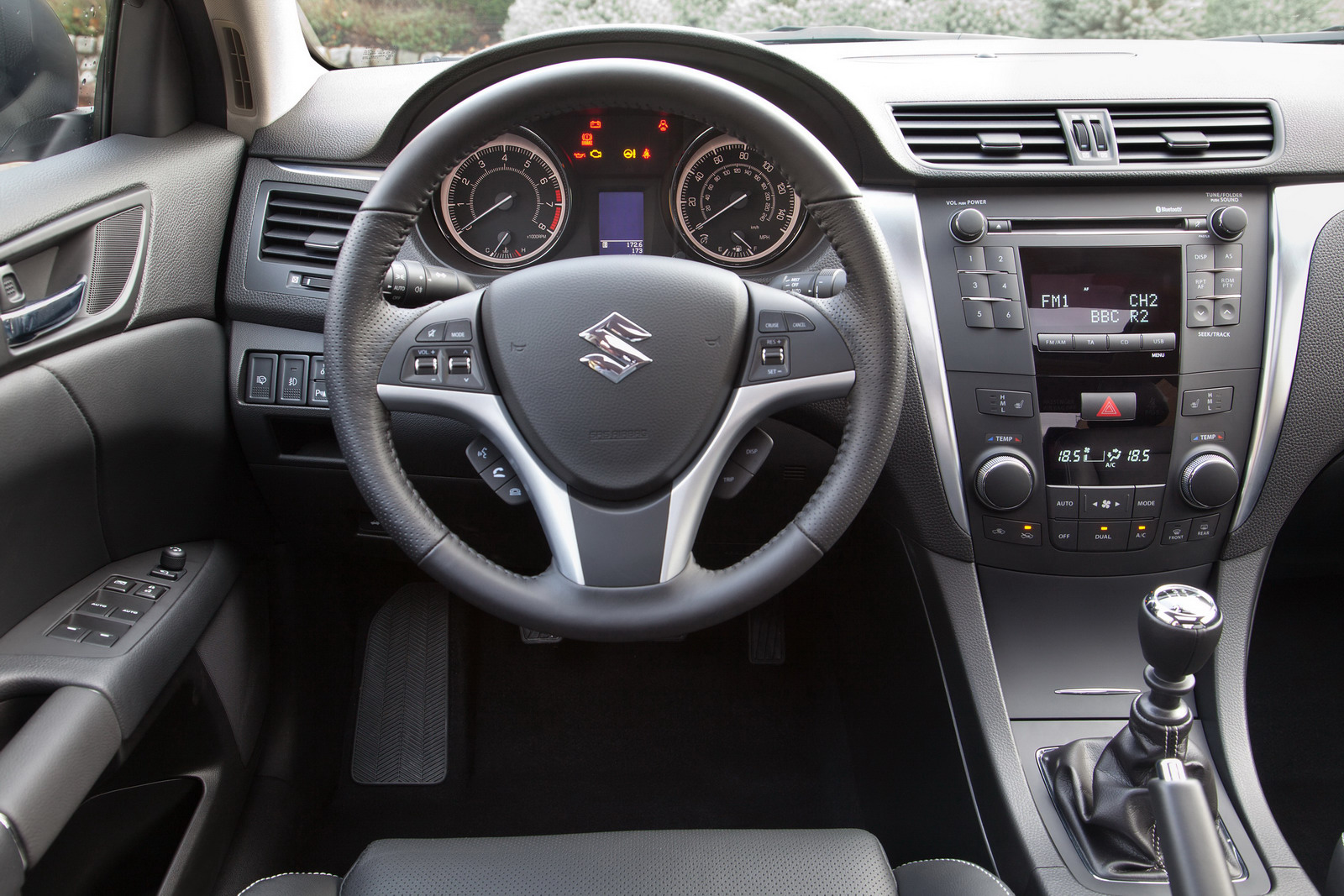

I never realised there are two different style leather steering wheels. The Sport variety has the silver highlights (obvious difference), but also perforated leather. Then there's the other leather style wheel that appears to be the same as the non leather (apart from extra buttons).
non leather below?

Installed a GTS steering wheel on my base S with manual transmission and I now have cruise control. Seems cruise control is "Plug & Play" on the base S! All it needed where the switches to turn the cruise control on. The GTS steering wheel provided the switches. I followed Studbike's excellent instructions with a few additional steps since I had a GTS steering wheel with the additional Bluetooth switches and paddle shifters. I took some time to determine the bluetooth switches only effected the radio. Since I had no need for the paddle shifters (manual transmission) I disconnected the wires to the paddle shifters. Now I'm ready for a long road trip.
