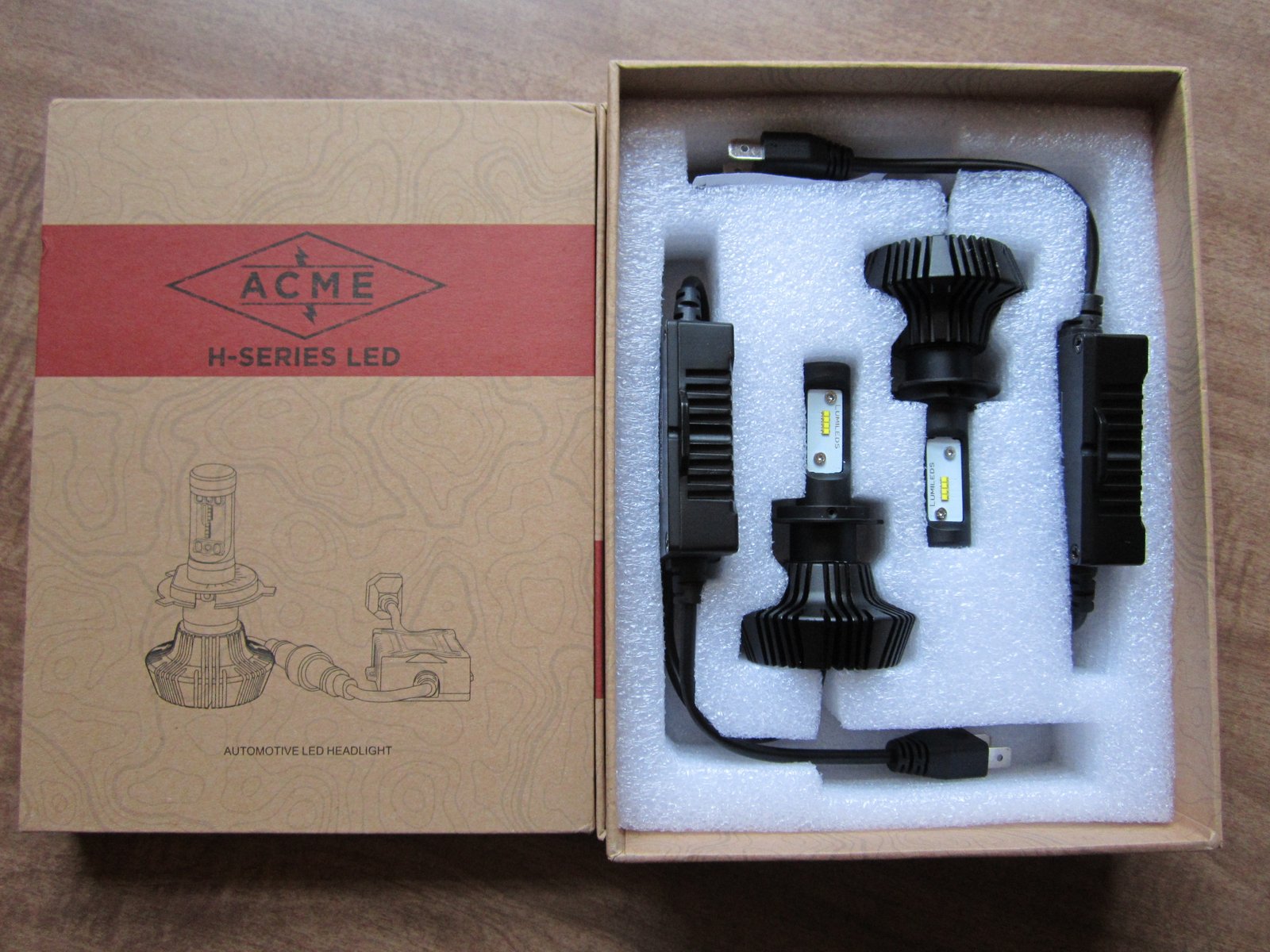

I found the kit on clearance at http://www.theretrofitsource.com which is where I got my Morimoto HID kit in the low beams and my HID fog light bulbs. Not only was the price of $35 very good, the design was something I was actually looking for. The Acme H7 LED bulb is a design with multiple Philips ZES LEDs designed to mimic an H7 halogen bulb's filament and uses only a heat sink instead of a fan. It's rated to consume 25W yet outputs 4000 lumens. The design was also something that would fit inside the headlight with the dust cap on.
Here are some photos of the kit:

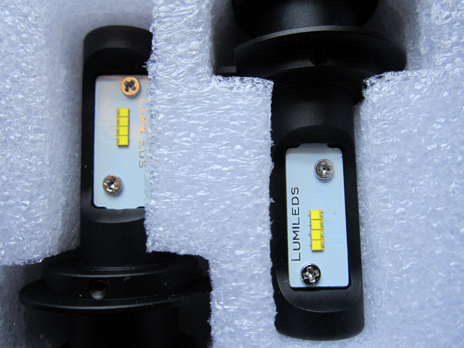

The kit itself is very impressive. The bulbs have a full metal construction as well as the driver housing. The machining quality is very good and the LEDs are mounted flawlessly onto the bulb. The Lumileds branding indicates these are Philips ZES series LEDs. The bulbs are also waterproof to an IP65 rating which practically means they can get wet without a problem. Many vendors of these LEDs dunk them in water containers to show their waterproof characteristics.
The back has some specs on the bulbs:
IMG_1219 II.jpg (308.38 KiB) Viewed 16114 times
The bulb has two sides with 4 LEDs on each. The most important characteristic of this LED bulb is that the base can be rotated for adjustment. This is very important in optimizing the output and the major difference between this kit and the old one. The old one could not be adjusted and had the LEDs fire up and down which is actually not how the headlight reflector was designed to reflect the light for optimal throw. This why the light output was a flood with the other kit. While it was bright, it cast a short range flood of light which wasn't very effective as a high beam on dark roads. This bulb's features allows for more possibilities.

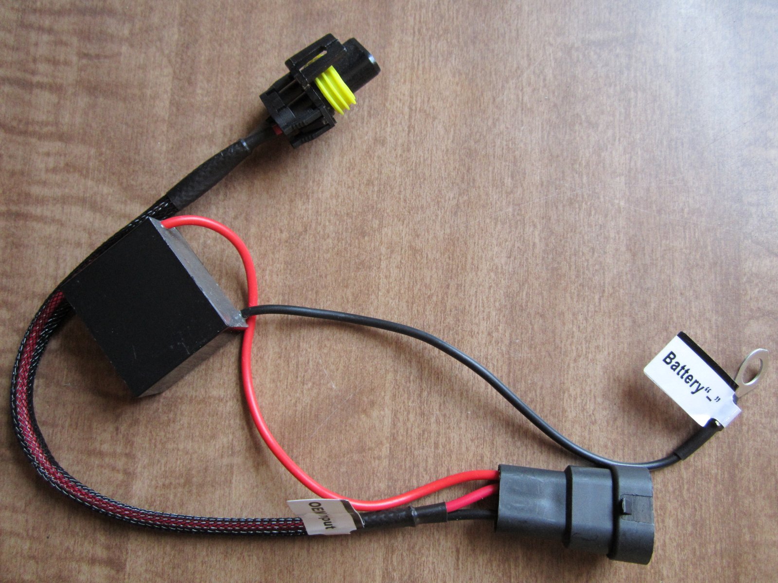

The first attempt also gave me the experience to know that capacitors are necessary to prevent the flickering of the bulbs from the PWM DRL system. The issue is that the current isn't constant therefore causes flickering in any bulb other than a halogen. Capacitors resolve the issue by stabilizing the current and releasing it to the bulb as a stable current. However, this causes the DRLs to operate at a higher output than intended. While the result is that the DRLs are bright, they aren't too distracting given the more common use of bright LEDs as OE DRLs and that they are intended for use in daytime.
Pictured below are the inline capacitors I also ordered from http://www.theretrofitsource.com along with the LED kit.

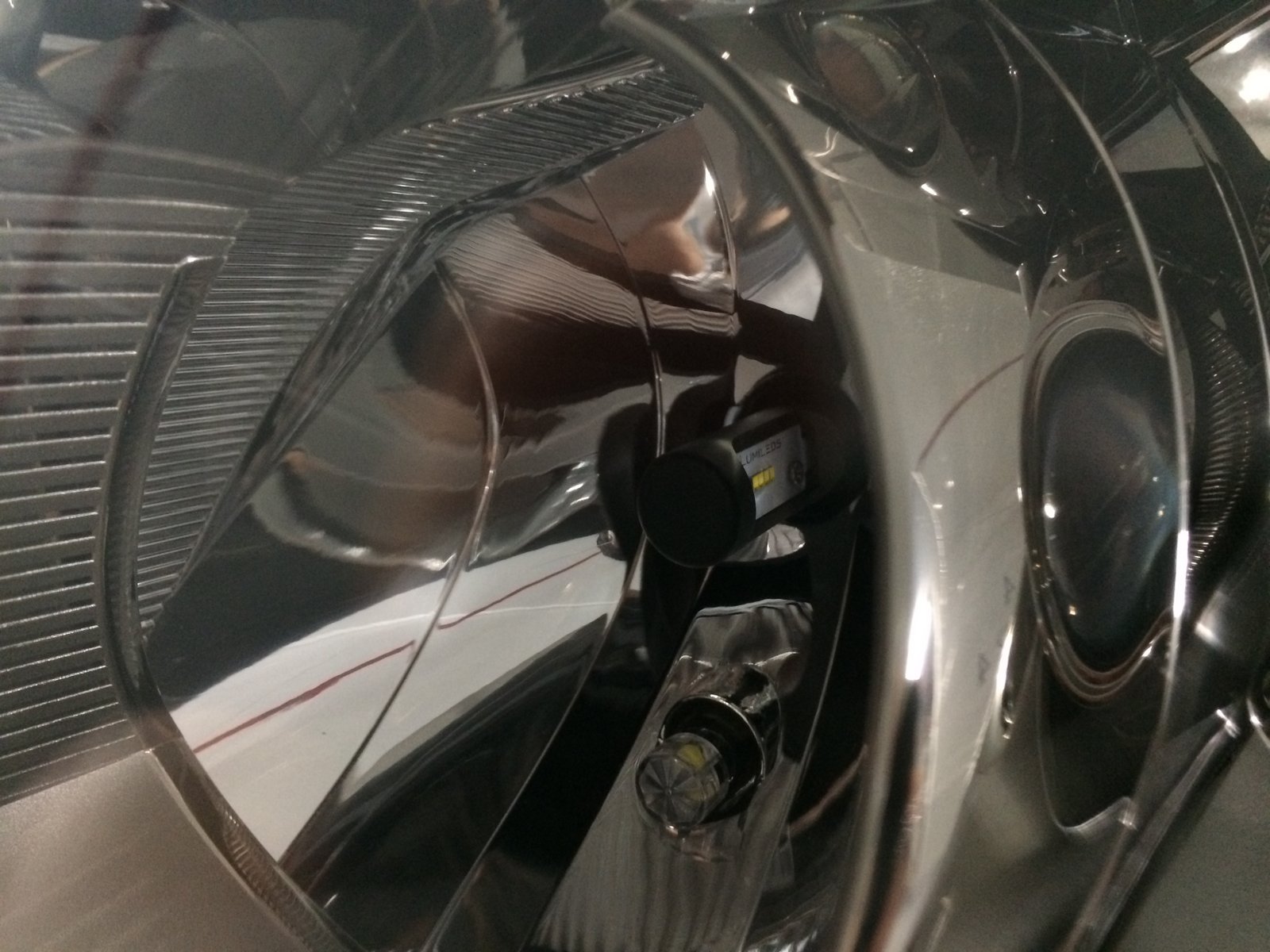

The image below shows how the bulb fits into the headlight. The heat sink is detachable which is imperative for installing the bulb and affixing the retainer clip. It's also necessary for bulb adjustment. The process of adjusting requires you to loosen a small hex screw in the bulb base, rotating the LED bulb to the optimal position, and then tightening the base with the hex screw. I will cover adjustment a little more later.
Once the bulb is in place and the retaining clip positioned, the heat sink can be screwed on to the bulb. The clearance is just enough for it to fit. It does contact the dust cap's retaining tabs a bit, but it does not prevent the heat sink from being properly attached. The bulb's threading also features thermal paste. The dust caps do feel like they contact the heat sink when tightened on, but they do fit.
Having drilled holes in the dust cap from the previous kit, I threaded the new bulb's wires out of the cap to the externally mounted LED driver. I then connected it to the capacitor which I mounted next to the driver. The wiring from the capacitor then runs back into the cap which connects to the headlight's H7 connector inside. I taped up both connections at the harnesses with electrical tape. The driver and capacitor are affixed to the underside of the headlight with 3M mounting tape. Upon installing the headlight to the car, I affixed the capacitor's ground wire to an optimal grounding location which I also used for the HID low beam's capacitors.

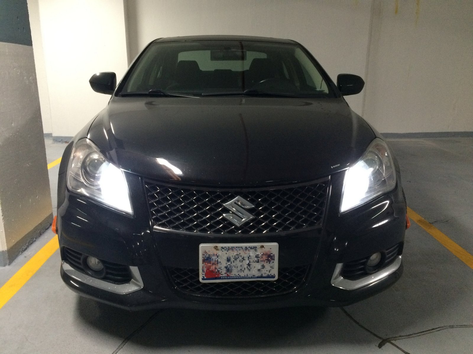

Here are some photos of them installed.

Yes, you need additional capacitors as they are directly connected to the wiring for just that bulb. I have a total of four capacitors for my headlights; one for each low beam HID and one for each DRL/high beam LED.
You could possibly swap the capacitors for your HIDs to the LEDs to save money if your HIDs don't have a flickering issue.

I apologize I never got around to taking on-the-road photos. However, I haven't had the time to remove the headlights to fine-tune their reflection in the headlight as well. They are basically as is from when I installed them.
The light output is rather scattered, but not useless. It basically scatters the light up and around in a somewhat circular pattern rather than a focused hotspot like with halogen bulbs. While it's not as useful as a halogen's output in distance illumination, it does work as a high beam, greater enhancing road illumination on dark, unlit roads. It also casts a good amount of light downwards to help you spot road imperfections. LEDs also seem to reflect road signs and other reflective materials a lot better, helping you notice them more easily.
To attempt improvement of the reflection pattern, I'd have to rotate the bulb after loosening the bulb's base. Once an optimal reflection pattern is cast, the base is tightened with a small Allen screw so the bulb maintains its position in the headlight. I'll get to this one day, but I'm overall content with the LED bulbs as is. After all, I did get them more for their DRL purpose than high beams. As DRLs, they are bright, but not as bright as when used as high beams. As noted in the first post, I have capacitors attached to them due to the Kizashi's PWM DRL system. As a result, the LEDs are very stable and have not flickered at all. I also think the bright yet cool white color temperature of the DRLs adds to the premium look of the Kizashi, especially if you have HIDs for the low beams.
Overall, I'd say that these LEDs aren't an improvement in high beam performance over halogens, especially compared to high output H7 bulbs, but are rather impressive overall. When used as DRLs, they are a lot brighter than the yellow halogen output and will not compromise bulb longevity like the halogens. For the low price of $35, it's definitely worth it and the greater consideration would be whether to spend the time installing them or not.
