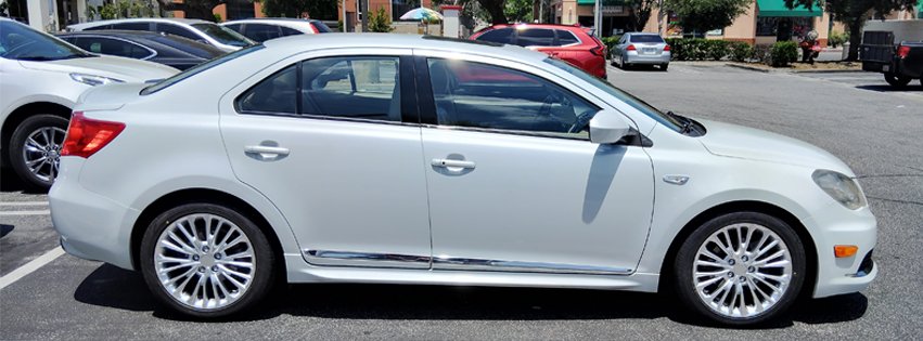

Better late than never, but better never late, here's what lives in my garage now:
So far the experience has been mildly superb and the next steps are things like LEDs to replace the H7 headlamps and a good detailing job. I will post more pictures as time allows.

Looks great and glad to hear you're liking the car. Getting it tinted?
In seeing a photo of the actual car, I have to point out that your Kizashi appears to have the older 18 inch alloy wheels of a Model Year 2010 SLS before the Sport models were introduced in Model Year 2011. Basically, when the Kizashi debuted in 2010, the GTS and SLS trims had 18 inch alloy wheels that looks like your current wheels. In 2011, the "Kizashi Sport" was offered and all GTS and SLS trims became these Sport models. They had lighter-weight 18 inch alloy wheels that look different. The odd thing is that your car is a model year 2012 thus would have been equipped with the Sport wheels, not the ones you currently have. However, Kizashis wearing different or repainted wheels isn't surprising given the paint on the 18s of any model year was very poor. The paint on the wheels often chipped or flaked off in chunks. This happened to me personally when a body shop power-washed my wheels thus I had my Sport 18's repainted.
I just wanted to point out that the wheels your 2012 Suzuki Kizashi Sport has are not the original wheels for that car in case you were not aware. Looks great anyway and I can tell your Kizashi is the Kizashi Sport given the front fascia, side sills under the chrome trim on the doors, and the small spoiler. These are all features only found on Sport models.
Window tint's on the shopping list KuroNeko, but the LED conversion's in the catbird seat at the moment.
I am aware these are the 2010 wheel design. I guess it's the car designer in me, but I prefer the relative simplicity of the earlier (and heavier) wheels. I looked at getting the original 'sport' ones refinished, but an additional appeal the ones on the car had to me is that they're NEW. Stumbling around the web looking for a set of aftermarket wheels as a quick and not-so-expensive way out of my peely Sport wheels, I stumbled across this:
https://www.mrwheeldeal.com/buy-wheel-o ... 1a-18x8-50
The price was right and as I mentioned, I prefer the somewhat simpler design and bought a set, though I know I have altered the 'purity' of the original 2012 STS Sport package. I must admit I never heard of the maker (Road Ready Wheels) but that didn't stop me.

Again, these are new production. You could have knocked me down with a feather when I saw these at that website. They also have what I think are the 17-inchers that came on other Kizashi models.

Ah, that makes sense. While your current wheels resemble the 2010 SLS wheels, they do look more whitish silver than I think the OE wheels were. It makes sense they are aftermarket and I'm glad you were able to get OE-looking wheels that better suited your tastes. They do look great on your white SLS.
