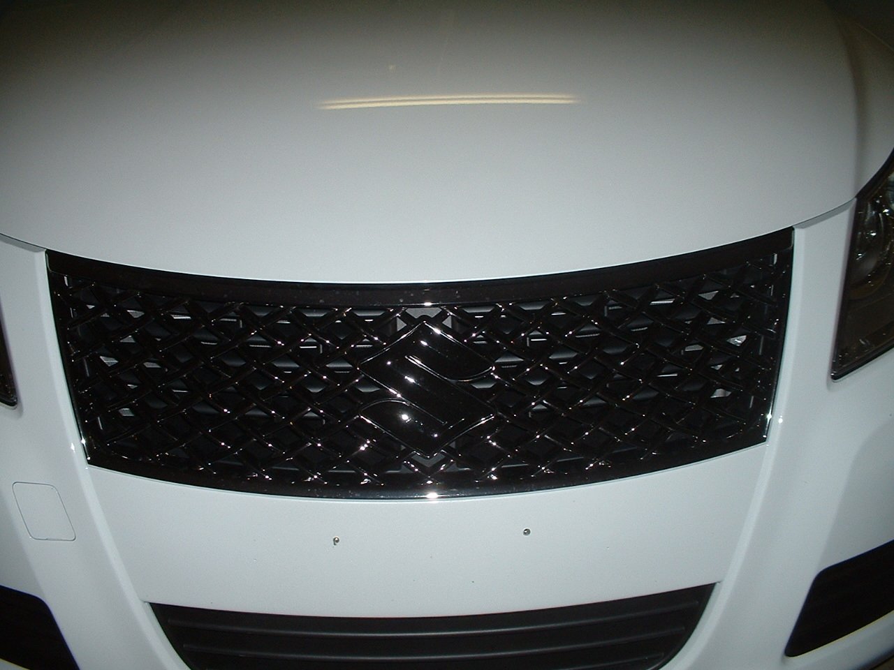

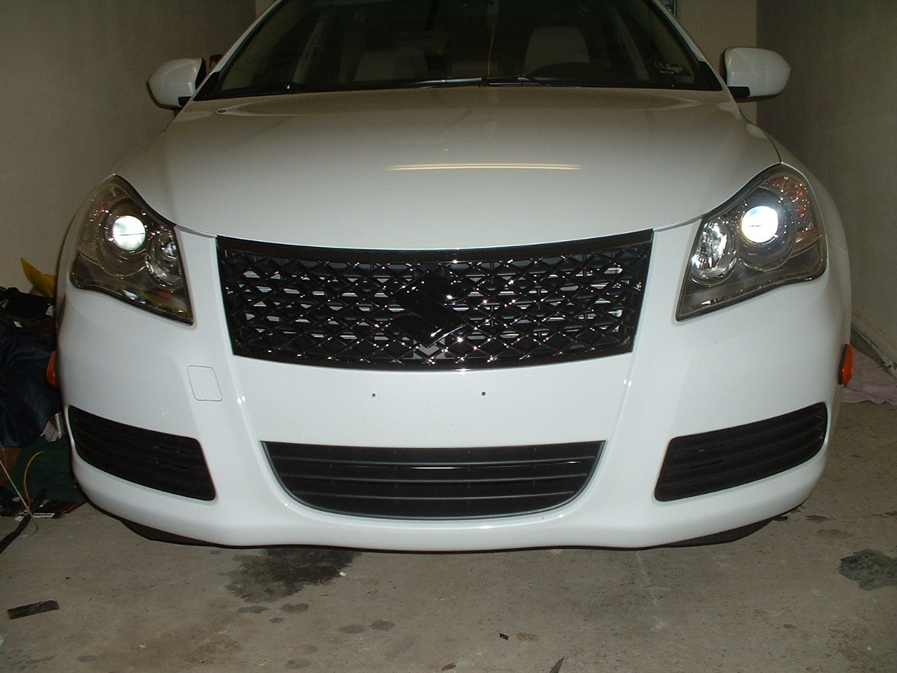

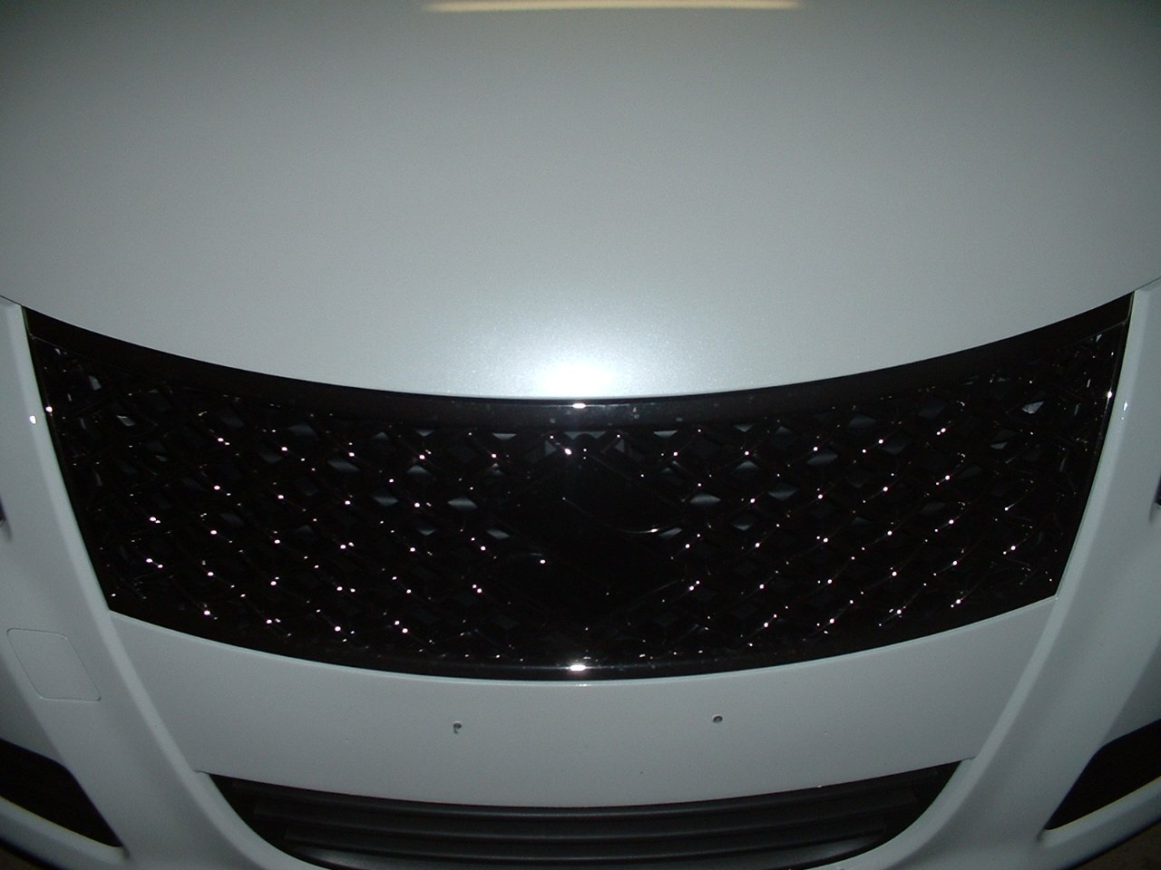

Here is a pic of my black S in the grill. I used a table knife to carefully pry it out of the grill, cleaned it and let it dry, then sprayed it with Rust-Oleum BLACK LACQUER. The trick is to use the Lacquer paint! I also sprayed mine with clear Lacquer for shine. ****Be sure to trial fit the S into the grill cause a little bending occurs when prying it out, just re-bend it a little back into shape! Then use mounting tape, that double side 3M stuff to put the S back in.
***DONT SPRAY THE S ON THE GRILL, THE GRILL IS A BLACK METALLIC AND IT WILL LOOK FUNNY IF YOU JUST SPRAY THE AREA AROUND THE S.*****
Notice no paint chips on the front of my Pearl White front end !

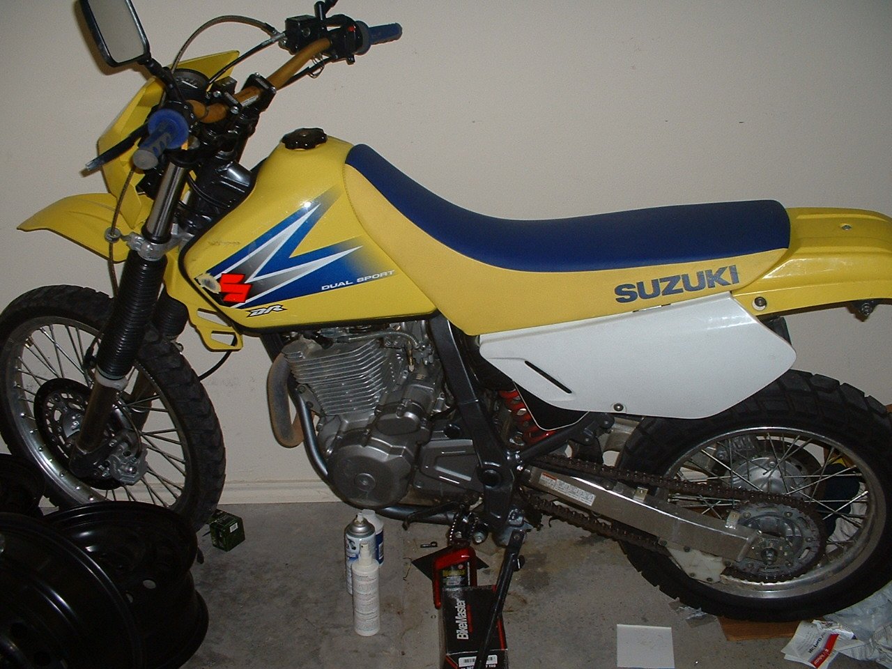

Pic of my other Suzuki with 20K trouble free miles!
