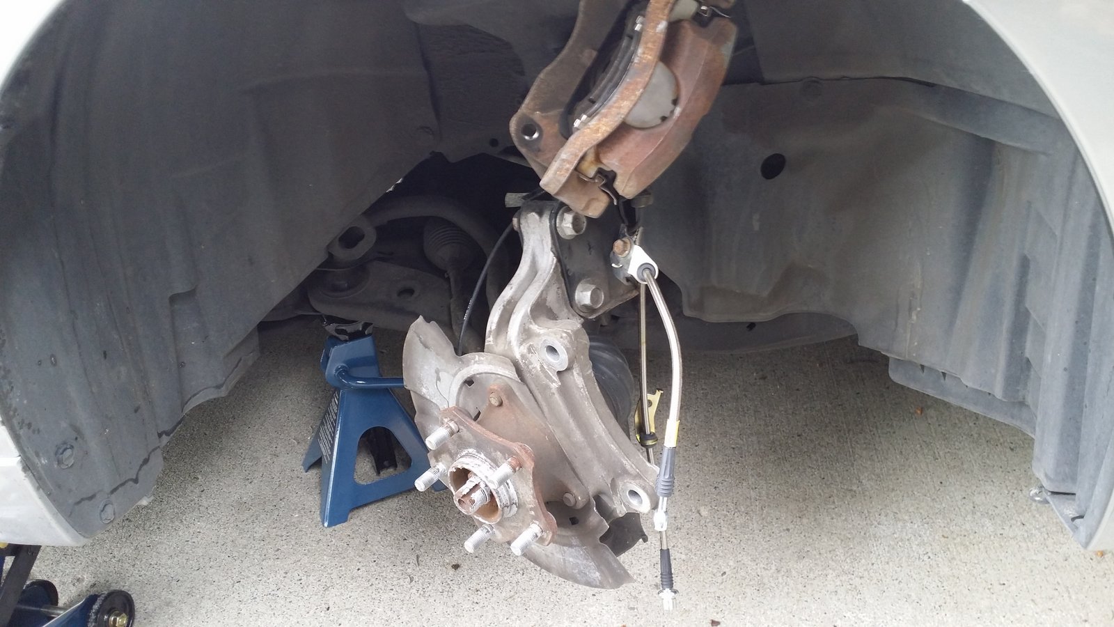

CALIPER AND ROTOR EXPOSED

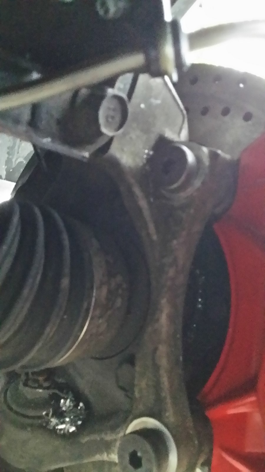

REMOVE CALIPER BRACKET BOLTS
REMOVE ROTOR SO ONLY THE HUB IS SHOWING

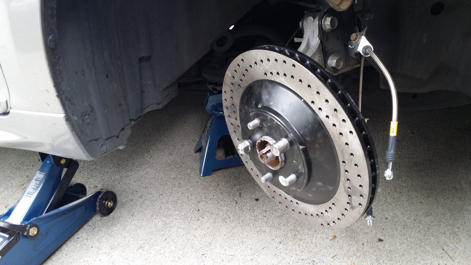

PUT ROTOR ON HUB
PUT ROTOR ON HUB
I USED DRILL BITS TO LINE UP THE HOLES TO BE SURE IT WOULD FIT
NOTICE THE GAP NEED TO HAVE SHIM MADE

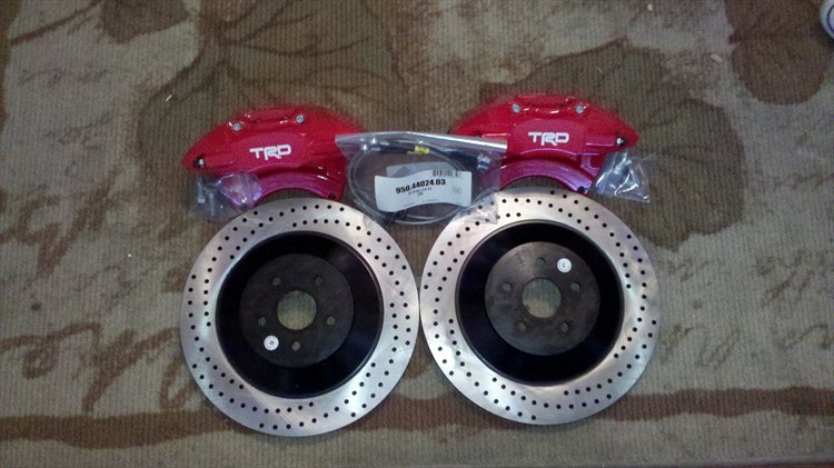

STEP 1 PICTURE WOULD NOT LOAD SO HERE IT IS TRD SCION XB BIG BREAK KIT INCLUDESCALIPERS ROTORS PADS AND STEAL BRADED LINES

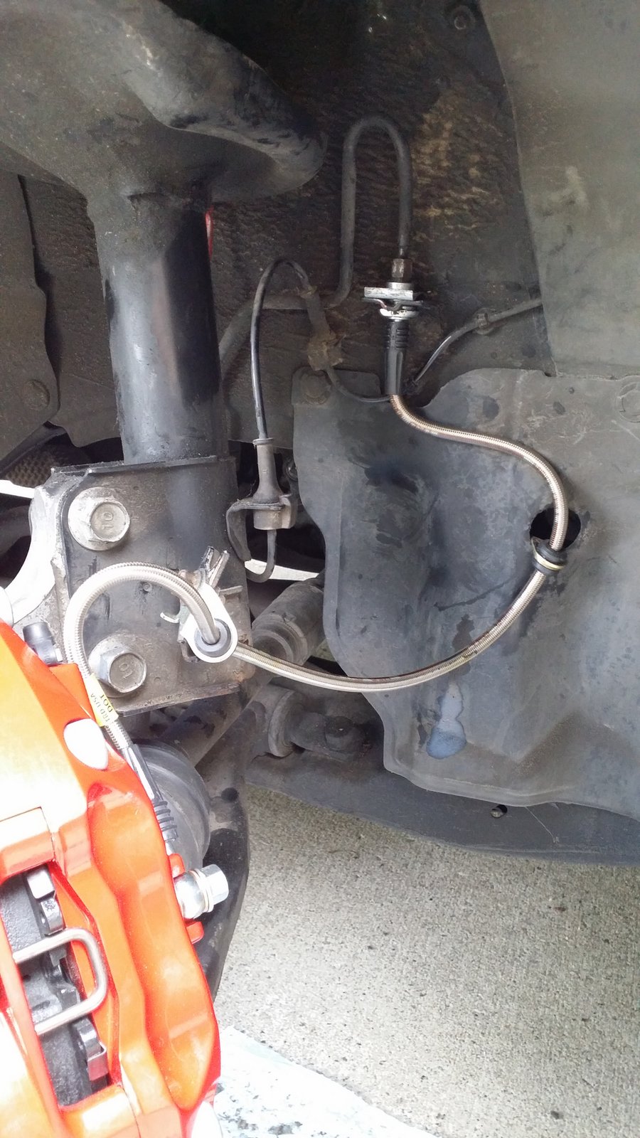

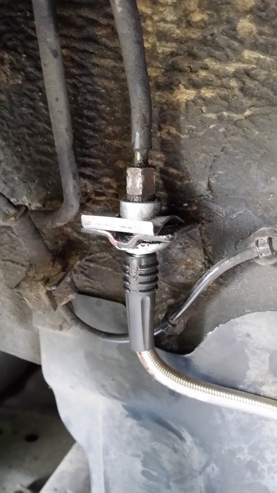

**BRAKE LINES**
** Post side note**
(When you remove you lines the new line will fit the kizashi line you will have a hard time getting the clip that holds the line in place back on, have not figured out what i want to do so I tapped it on with hammer hoping for the best lol)
** BE CAREFUL NOT TO STRIP YOU BRAKE LINE GET A PROPER LINE WRENCH** BE FAST SO YOU DONT LOOSE ALL YOUR BRAKE FLUID
ATTACH OTHER END TO CALIPER WITH COPPER WASHER THIS WILL STOP THE DRIPPING
**DO NOT GET FLUID ON ANY PAINTED SURFACE**
THE LINE WILL BOLT UP TO FACTORY LOCATION ON THE STRUT
SHOULD LOOK LIKE THIS

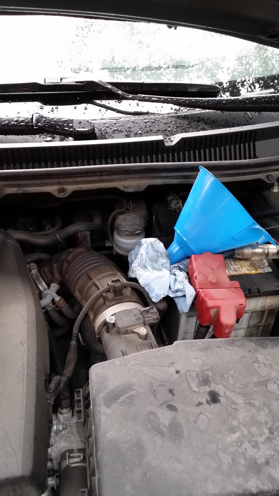

TOP UP FLUID USE DOT4 NOT DOT3
DONT FORGET TO BLEED YOUR SYSTEM PROPERLY FROM THE FARTHEST POINT.
NOTICE THE HOLE THAT I USED TO JUST DROP THE BRACKET IN FOR THE LINE MAKE SURE YOU MOVE THE LINE ARROUND TO LOOK LIKE MINE SO THE TIRES DONT RUB THE LINE WHEN WHEEL IS TURNED ALSO THERE IS NO HOLE IN THE LEFT SIDE OF THE VEHICLE PLASTIC USE THE DRILL AND MAKE A HOLE
MY LINE AGAIN

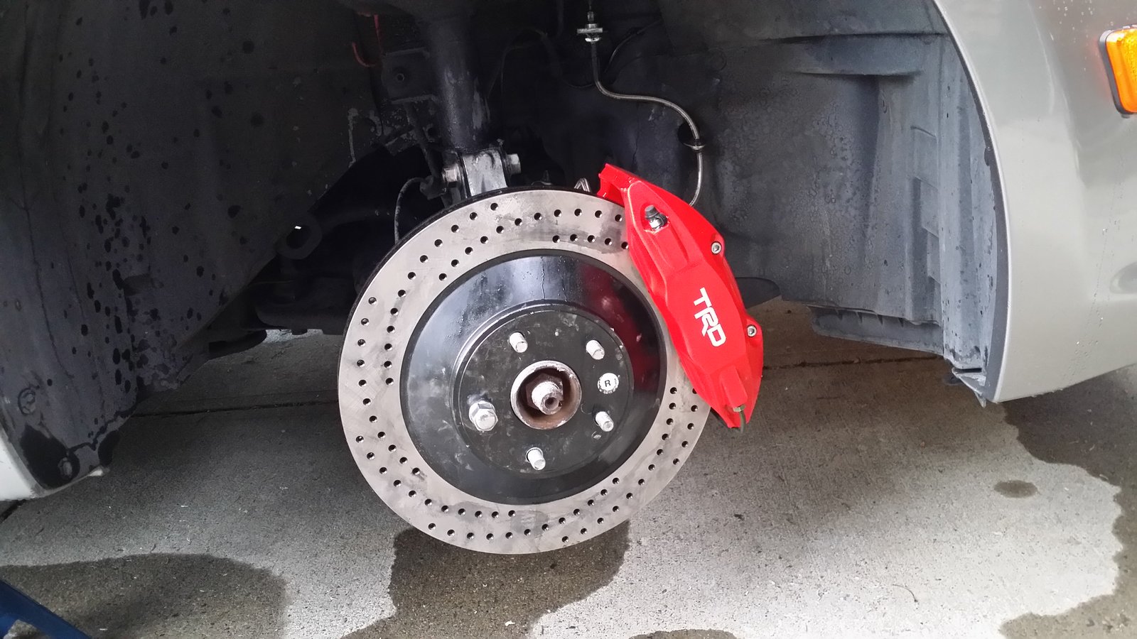

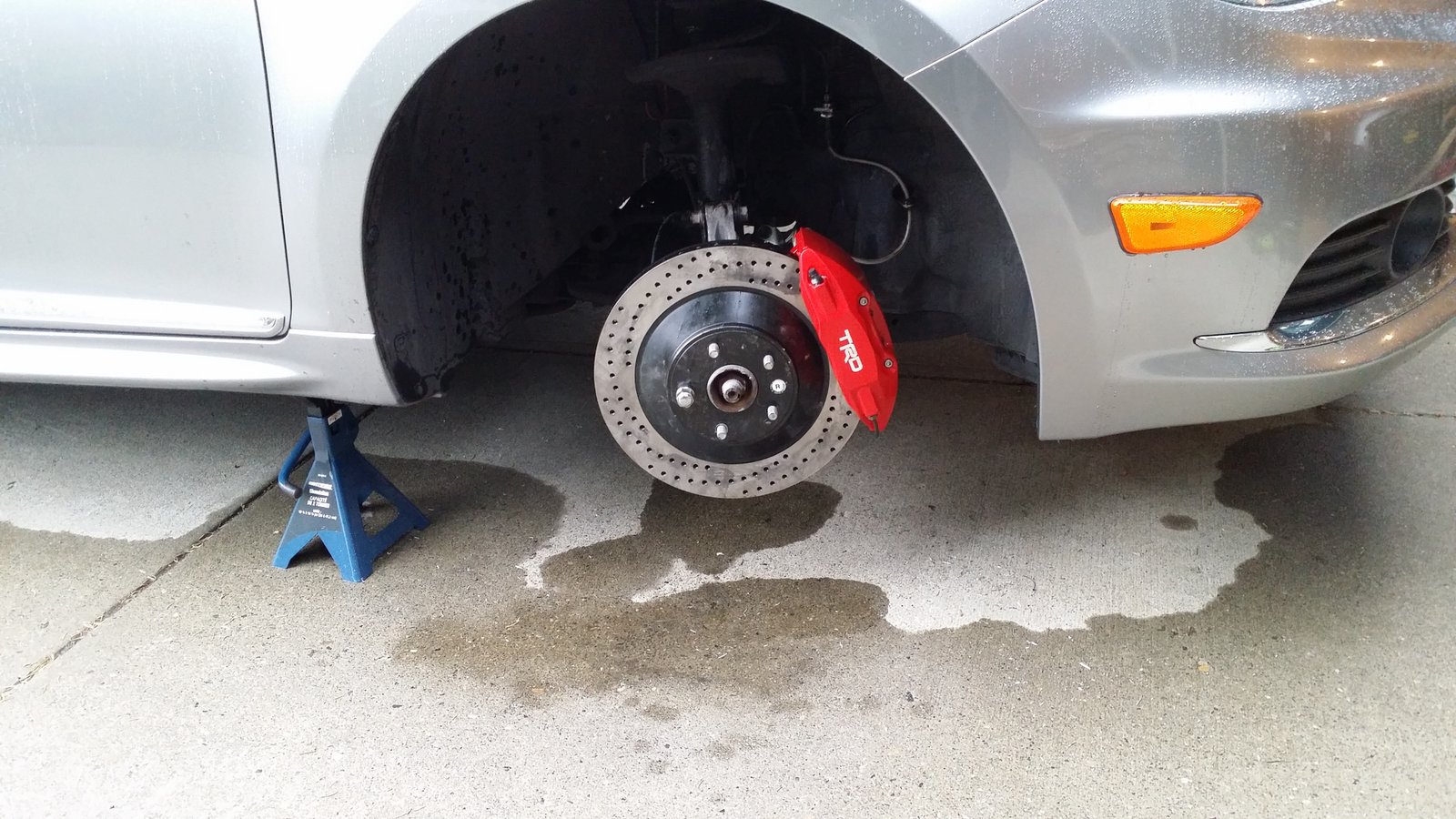

STEP 5 FRUIT OF YOUR LABOUR

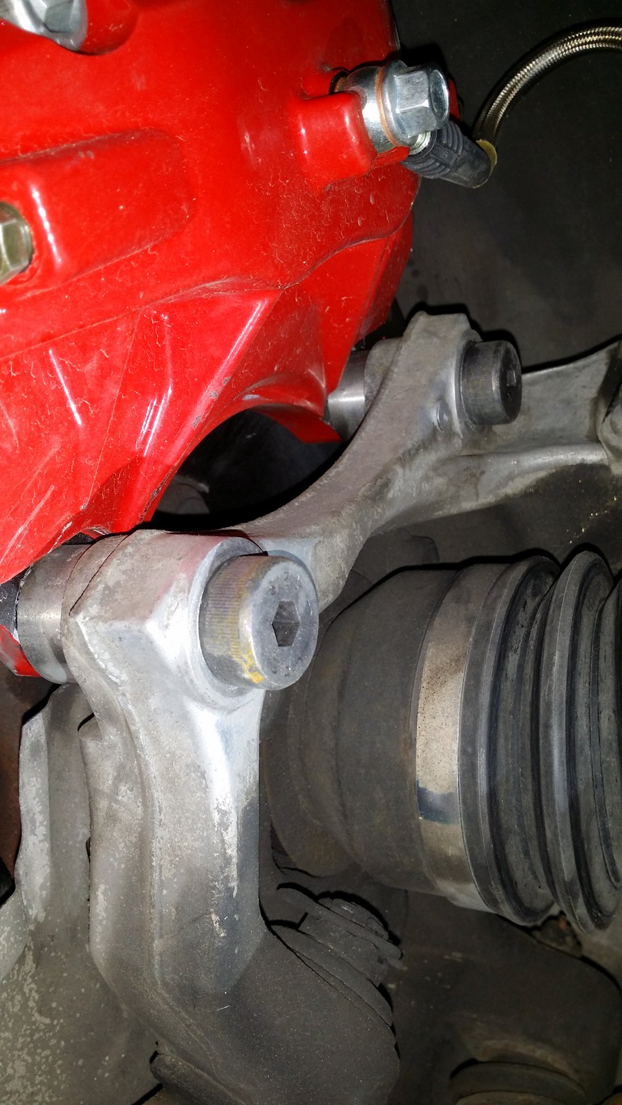

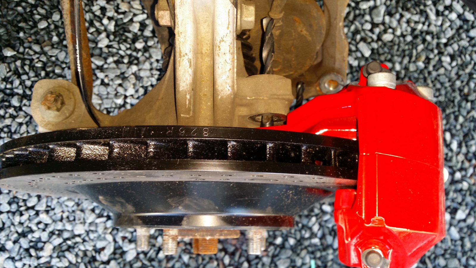

HERE IT IS BOLTED UP WITH THE SHIMS AND SPECIAL BOLTS I PUT THAT SILVER ANTI-SIEZE ON THE THREADS TO MAKE THINGS EASIER TO GET OFF IN THE FUTURE IS NEEDED.
ANOTHER PICTURE OF THE BACK
ANOTHER PIC
ANOTHER PIC
ANOTHER PIC
ANOTHER PIC
SPRAY EVERYTHING DOWN WITH BRAKE CLEAN

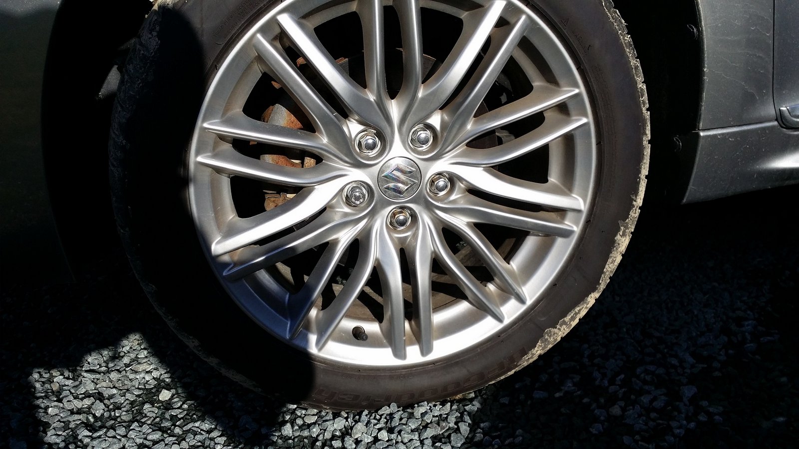

PUT WHEEL BACK ON AND CHACK FOR RUBBING MY WHEEL WEIGHT WAS HITTING CALIPER AS ITS RECOMMENDED TO HAVE 19" WHEELS I JUST FILED THE WEIGHT A BIT AND ITS FINE
** MAKE SURE YOU BEND YOUR DUST SHIELD ON THE BACK IT WILL RUB ON THE ROTOR**
