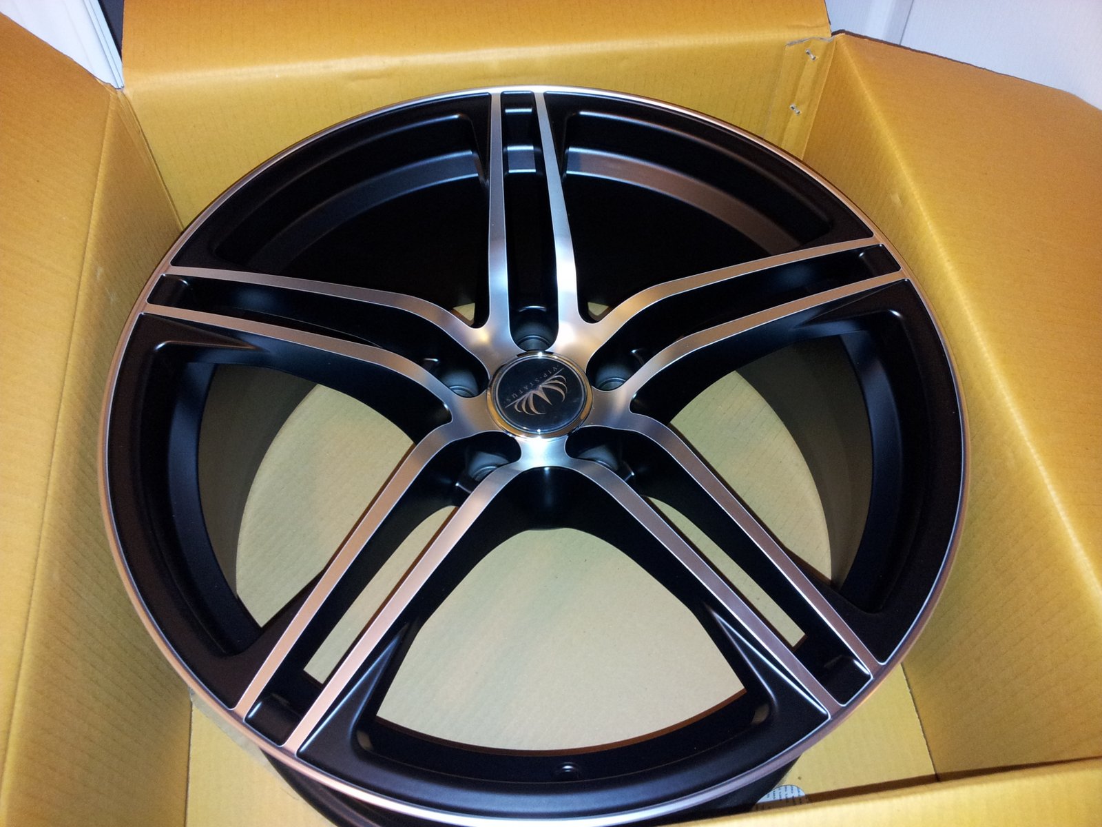

picture of my new rims.

cant wait until next spring to put them on. 19" vip status ar-2 8.5 wide
What is the max width of tire that our car can handle.

Tire Rack doesn't list 19" rims sizes (strange as they list 18" and 20"), but for an 8.5" wide 20" diameter rim they recommend a 245mm wide tyre. So, it should be a safe bet (depending on wheel offset) to fit 245mm wide tyres of a suitable sidewall profile. All their 8.5" wide rims listed for a Kizashi seem to be in the 40-48mm offset region.
245/40R19 is probably the closest diameter tyre that will fit, but it's slightly oversize (your speedo will read 0.9mph too slow at 60mph.)

i would suggest 235/40/19. The Kizzy doesn't need more tire unless you're boosted. You will save $, weight, fuel. Handling/ braking will still improve from the shorter sidewall provided you get a tire that has at least as good a tread/ sticky rubber.
For comparison with 245/40R19, the 235 tire is a better fit to OEM specs. When your speedo reads 60, you are actually travelling 60.2 mph

edit- love the rims, BTW

alright thanks everyone for the info. I have a black 2011 sport and cant wait to take pics with the new rims on it to post.
Yes, 235/40 will be closer to original diameter. I had a quick check and it appears that size is also okay for the 8.5" rim width.
