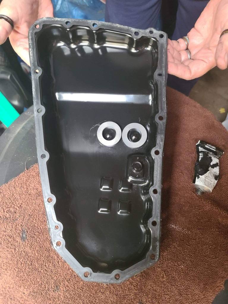

old tech wrote:At this point, this is what I recommend. Drain fluid( using drain plug) into clean container. reinstall plug. remove pan bolts starting from rear and leaving 1 or 2 front bolts so you can slowly drain remaining fluid from the pan . Lower pan and post here a picture of contents in pan floor so I can advise. Yours just might be in great shape. Dont buy anything except fluid. Sorry to bum you out in earlier post . My intent was to give confidence that these cars are being cared for with know how and needed part availability on this site.
You're good OT. I was on this early this morning.
I went out and picked up 7 quarts of Valvoline full synthetic CVT fluid and a pu filter for a 2012 Altima....
The fluid looked pretty good! No odd chrome shavings or chunks, filter looked very clean with just a small amount of gunk. It took 6 quarts of new fluid. Feels snappier and smooth! Much more at ease now.

As long as there was no chrome slivers -peelings , you are golden. This service needs done every 30k miles no matter the fluid condition appearance on the stick . More often, even better.
