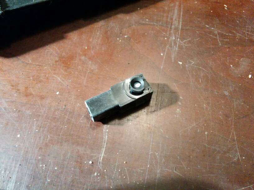

Took the panel off and I don't think there's an easy way to replace the LED. Disappointing as the amber color doesn't really match anything.
Here's a picture of it
How keen are you? You could cut the loom and join a red LED onto it (remember you'll need a suitable sized resistor in series) or look into disassembling the module.

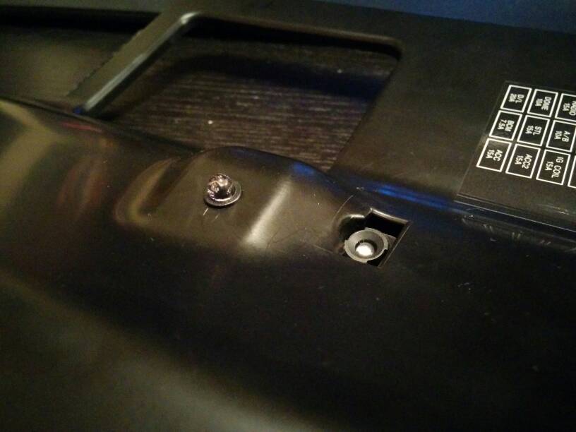

Here's the driver side panel with the new LED in. There's a nice flat spot right next to the stock light. I used wire taps on the stock wiring for power (white is +, gray is -).
The use of LED holders allows me to simply pull the LED out when I remove the panel in the future.
