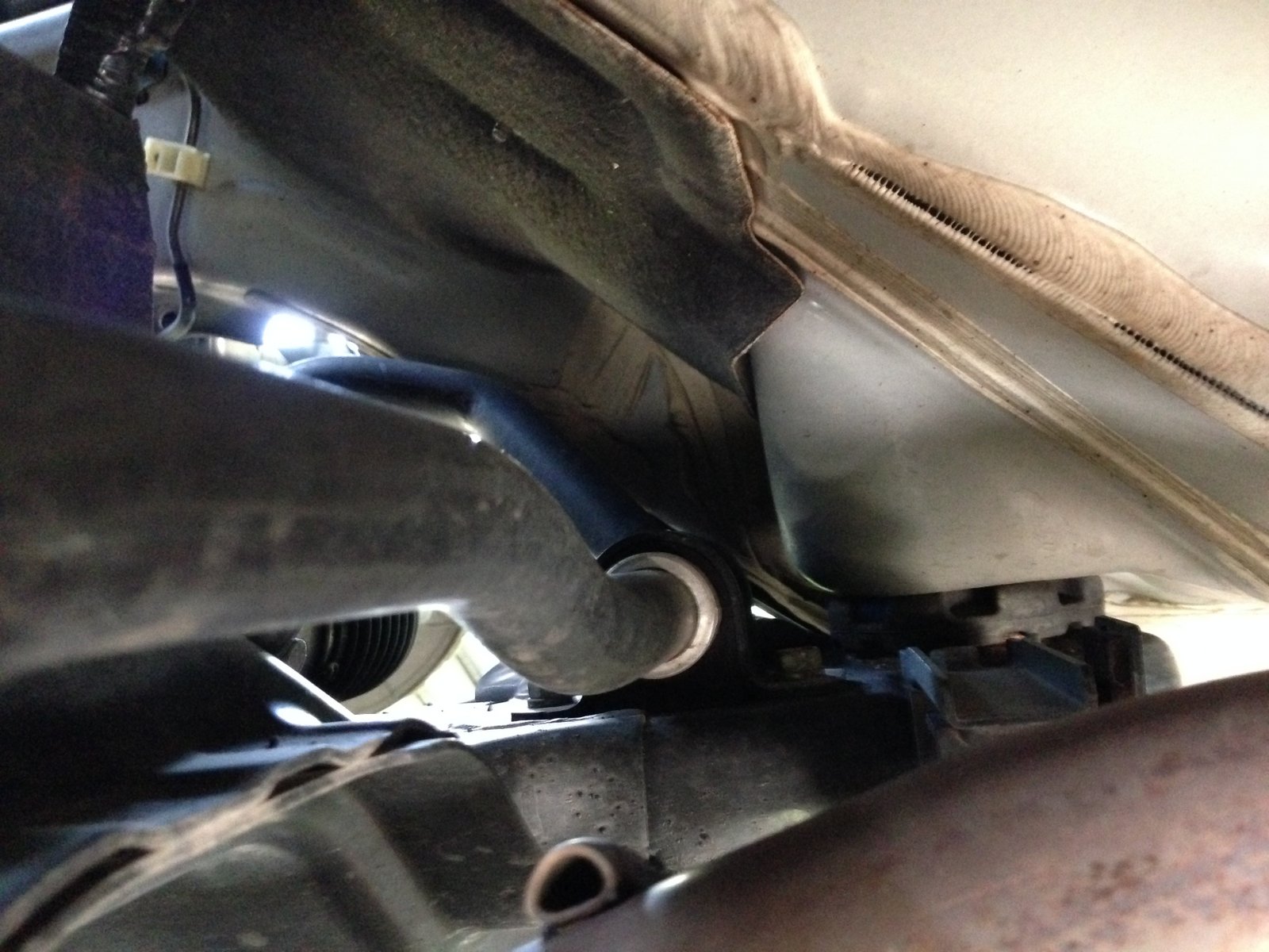

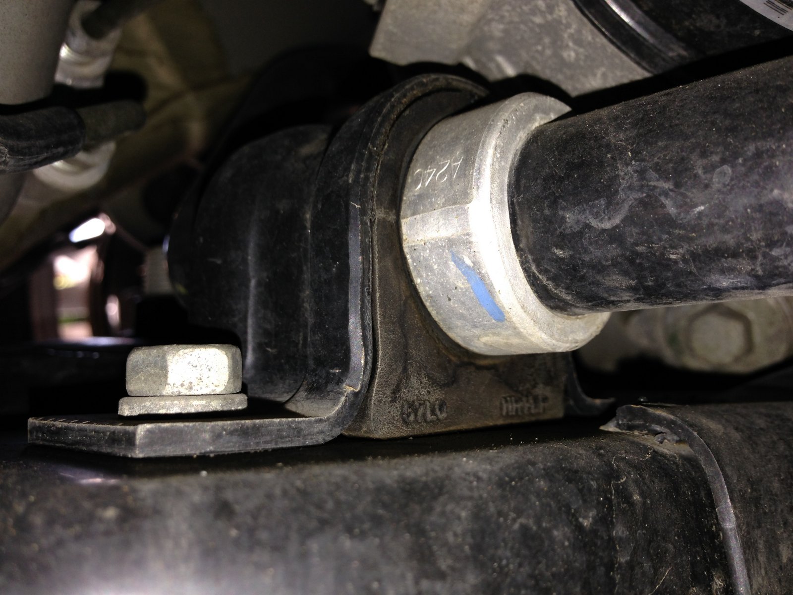

I changed the oil today in my Kizashi and while I was under the car, I took some photos for you and made some observations regarding the front sway bar bushings.
They are accessible without removing the sway bar though the RH side will be a pain due to little clearance in removing the bolts. LH side will be relatively easy. I don't know whether the crossmember needs to be removed to remove the sway bar, but the removal of the sway bar from the car looks very tricky. Best to just try go at the bushings themselves without trying to remove the bar. I know the bushings have a slit in them so they slip on and off the bar once the clamp is unbolted.
I must note that having seen the front sway bar, I'm no longer wondering why there was no aftermarket front sway bar for the Kizashi. The factory one is very thick. At least 21mm which would make it thicker than RRM's rear sway bar (19mm) and the factory rear (15mm).

Thanks. It doesn't look impossible to just change the bushes, just a challenge.
I'm about to go have a look at mine - being RHD it might be the mirror opposite?
PS: Front bars are normally a lot thicker than the rear.

BTW, the front bar diameter on my 2011 FWD non Sport is 24mm at the ends (it should be the same diameter at the D bushes.) I'm guessing yours might be the same KuroNekko given the "A240" part number on the bar collar (indicating 24.0mm?)

24mm for the front sway bar sounds about right. I did not measure it, but simply eyeballed it and took photos. That's why I said it was at least 21mm meaning it could be thicker but no less than 21mm. It's one beefy bar up front.
