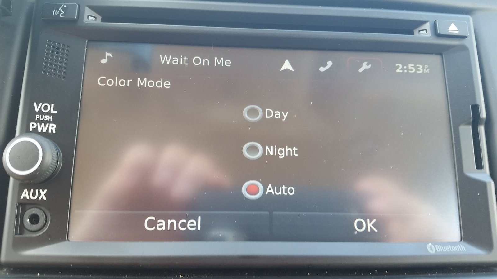

I have. Please see pictures.

That is set like I have mine.
Is the time on the head unit working (syncing) okay and reading the correct time? (I'm guessing the auto setting works on the time of day???)
Does it also switch to "night" if you manually select?

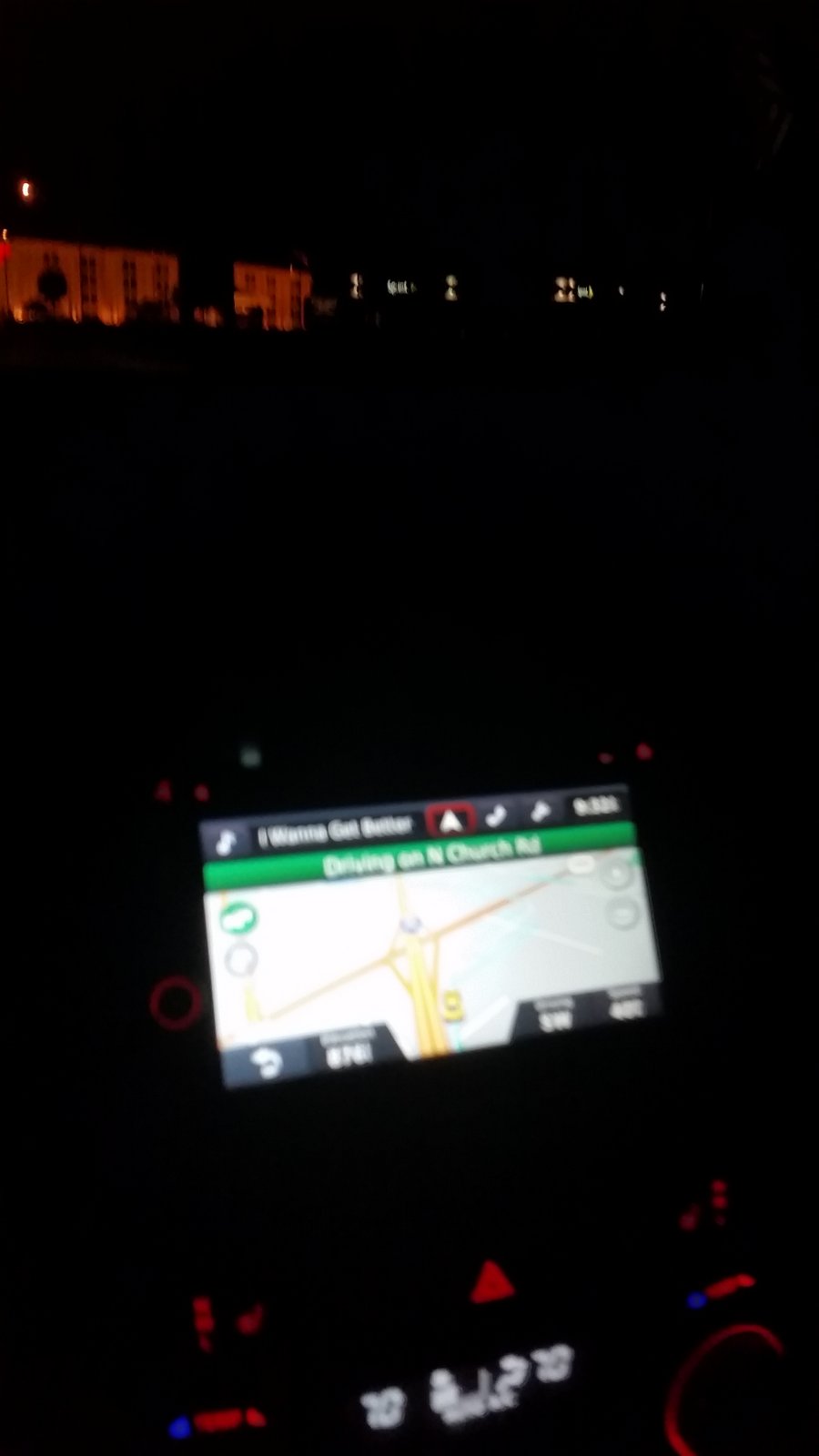

It will switch when when manually selected. Brand new head unit. I didn't notice the time so i will check into that . good catch. But in looking at the time on the above pic it is registering the correct time. One more thing. When I switch on my headlights from off to ON (non automatic) the screen tries to change to dark mode.

jcorcione wrote: When I switch on my headlights from off to ON (non automatic) the screen tries to change to dark mode.
By "tries", do you mean it flicks to dark and then back to day?

yes it does try to do that. I have seen it happen with the display going from night back to day.

I was reading thru that posting thread u sent, I am thinking there may be a separate photocell that may be involved. The thing is that what ever it is it's not detecting Dusk or Darkness, the head lamps come on at dusk or dark but does not change the head unit. There is a disconnect somewhere. Frustrating.

Update... well o figured out that the dashboard setting for the brightness of the gauge cluster cannot be turned all the way up. If that is done your color auto display will not work. So the dashboard setting is turned up just inder maximum so now the auto color workd in the NAV unit.
