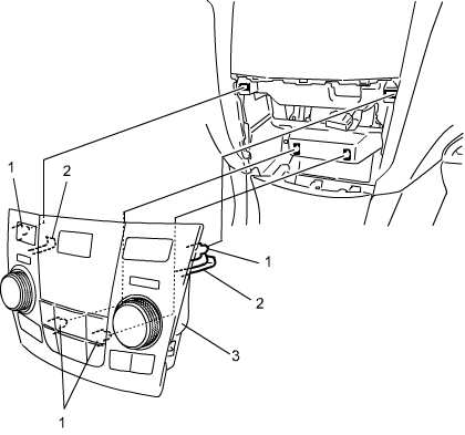

It seems that the AC panel should be removed in prior to install a new head unit. I found a service manual in this forum which tells me to "release tabs and claws at position 1 and 2. But... How to reach those tabs and claws? I can't feel them by stretching my fingers through the pocket door under the AC unit.

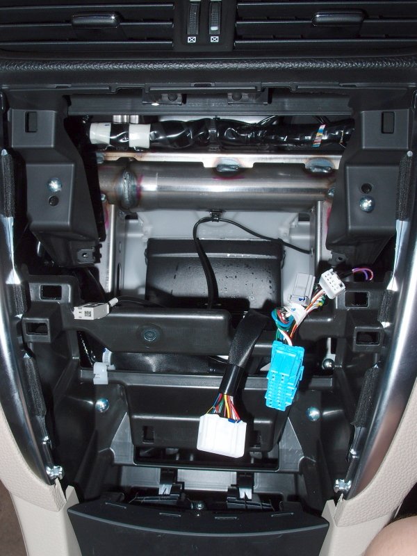

Here is a photo of all cables and harness. Looks like all kinds of harness have already been wired; anything more needed here to install a new head unit?

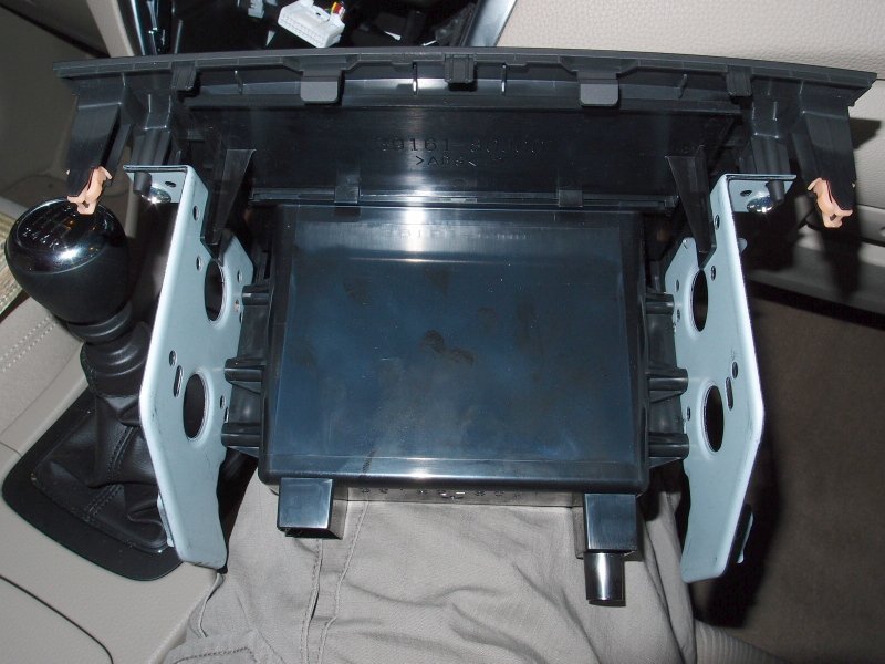

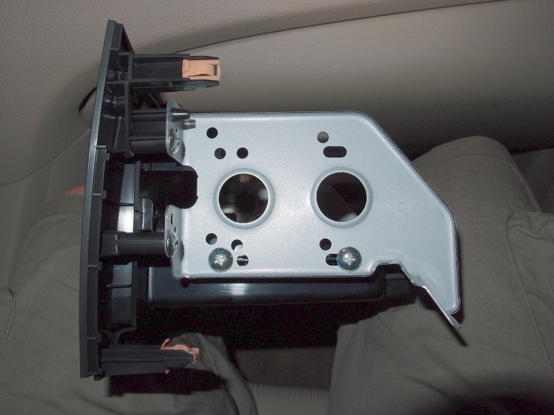

I have also taken two photos of the stock dummy panel. It seems just the same as scosche kit, so do I still have to buy the scosche panel?

The dummy panel has a blanking plate and a pocket? It looks like you're in business, no need for a dash kit. Just pop out the blanking plate, and the pocket if it's a 2-din, and the new stereo will bolt to the metal side plates. You just need the antenna adapter (the square grey plug is the antenna) and harness adapter (blue connector), or use t-taps on the wires, or if you don't care about retaining the factory plug just cut and splice. I have an unused harness adapter here, it came with my complete kit but the RF system has a different plug.

Thanks! By the way, which harness is for steering wheel control? So far I knew the left gray one is for radio, the big blue one is for audio, the lower big white one is for AC, but what are the other two above the blue harness?
