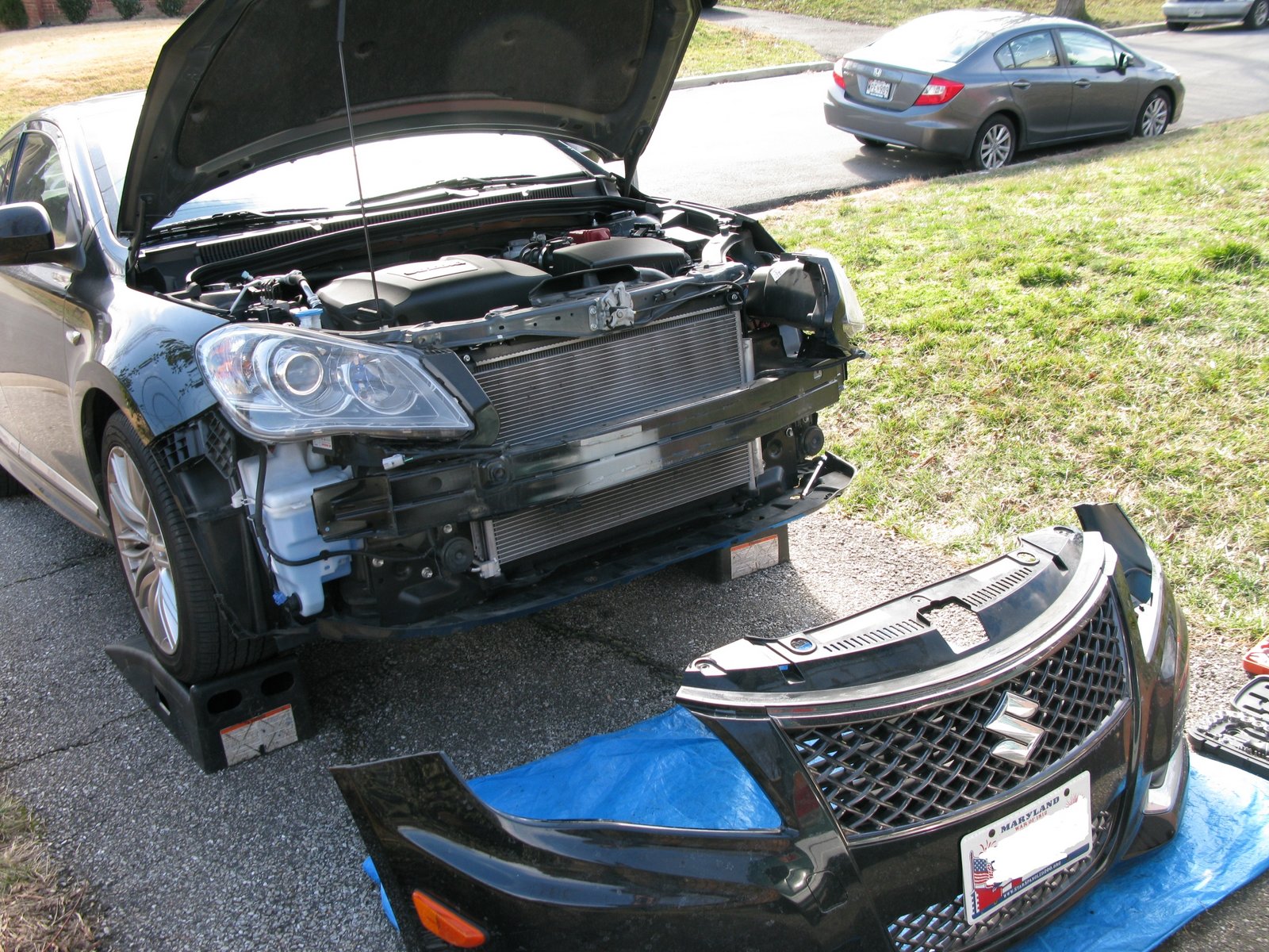

1) Remove the front bumper. It's true: to even replace the headlight bulbs, the bumper has to come off. This is the worst thing about the Kizashi it seems.
2) Remove the headlight. After taking off the bumper, remove the screws and the tab that hold the headlight to the car. Disconnect the single connector that connects the headlight wiring to the car. All bulbs are wired to the single connector instead of having a connector per bulb.

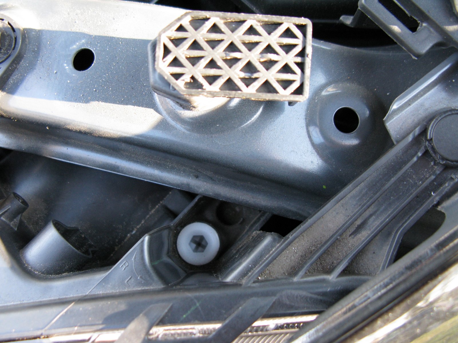

5) Under the cover, there is the adjusting screw, much like the Up <--> Down adjuster.

Remove the bumper and the headlights to have full access to the adjuster cover. Access to the rear of the headlights is key.
Remove the cover by prying at the bottom from the back where it is exposed. It pops off easily with no damage.
Removing the cover exposes the adjuster screw for access. The way it should have been from the start!
