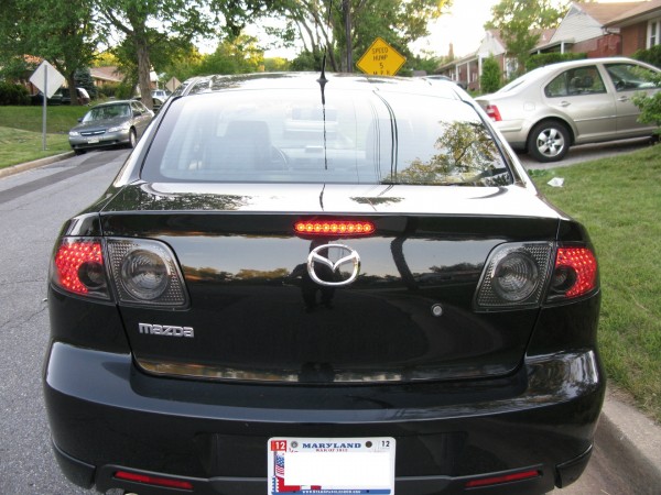

The problem with LED bulbs is that they don't light up the tail light housing too well. They have a light output that is more focused and does not spread out well. This makes them look like dots in the housing instead of really illuminating it. I've experimented with LED bulbs for turn signals and back up lights, but came to the conclusion that they were not good for light output.
The reason why LED bulbs make your turn signal faster is because they consume too low of a voltage in the circuit, therefore the car thinks the bulb is out. The faster blinking is a feature many car companies use to alert the driver that a turn signal is out. You have to install a capacitor as another post mentioned to prevent this. I personally think it's more hassle than it's worth.
Personally, I think the way to go is to wait until someone makes custom aftermarket LED tail lights for the Kizashi. I had smoked LED tail lights in my Mazda3. The light output was much better than stock tail lights because it was built to be LED. Unlike "black out" tail lights, smoked lenses don't really reduce the light output of the LED or bulb, but still look great.
Here's a picture of my Mazda's smoked LED tail lights:

Even the 3's LED lights look very dim compared to the high mount centre brake light. Most likely due to a reduced viewing angle compared to the stock units?
