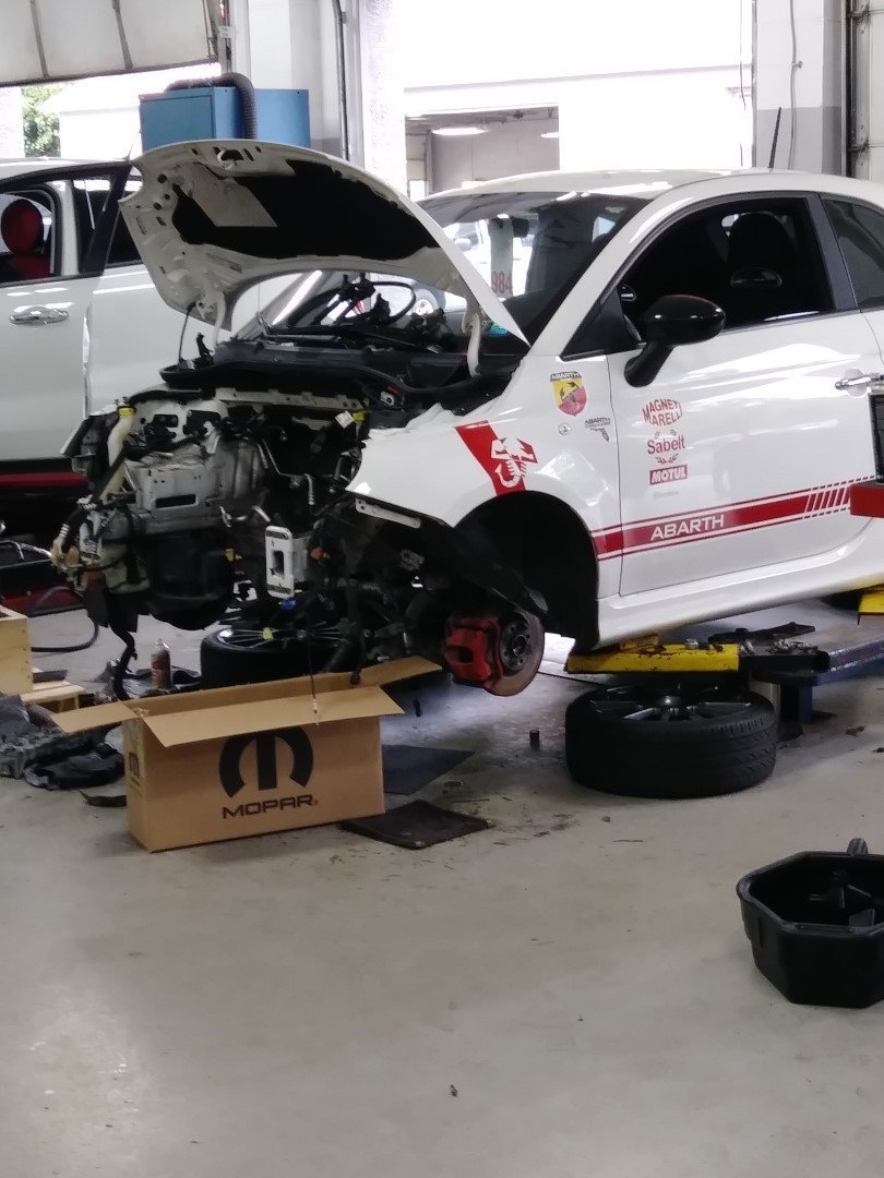

Nothing good can come of the average joe 'mechanic' severing your cooling and A/C systems, dropping the engine/trans cradle, having your car in this state
(Gutted Abarth at Alfa/Fiat ex-Suzuki dealer where I get my OE parts and supplies)
laying around for who knows how long, separating the two, rebuilding a CVT that there's little specific information about out there by some guy making a little over minimum wage and who's likely having a bad day for one of a million reasons and then putting it aallll back together again w/ pretty much zero guarantees on any of it. Nothing good is going to come from that vast amount of money spent. Take that cash and put it down on another ride. You already spent too much having some guy that didn't know what he was doing charge you for playing parts darts.
