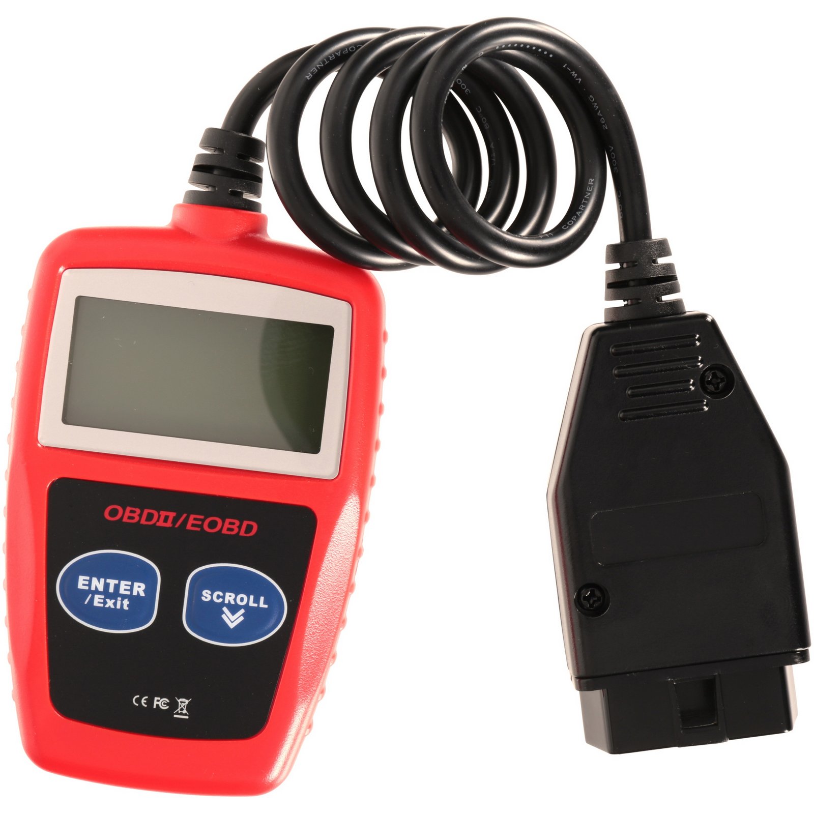

Also a new thing came up. So, I have two OBD2 readers. One is Bluetooth by FIXD and another one is Hyper Tough OBDII CAN Diagnostic Code Reader (Image is with this message). Now my issue is, I scanned my vehicle with both readers.
FIXD Bluetooth Reader: P304- Cylinder 4 Misfire Detected (This is all I get)
Hyper Tough OBD2 Reader: P300, P302, P303, P304 Misfire Detected
To confirm which OBD2 reader is right, I disconnected my battery from the car for about 2 hours then checked again. The readings are similar to before. FIXD says only P304 whereas the other one says P300 (Random Misfire), P302 (Cylinder 2 Misfire), P303 (Cylinder 3 Misfire) and P304 (Cylinder 4 Misfire).
Which one should I believe?

Posts: 1197
SSHREST4 wrote:Also a new thing came up. So, I have two OBD2 readers. One is Bluetooth by FIXD and another one is Hyper Tough OBDII CAN Diagnostic Code Reader (Image is with this message). Now my issue is, I scanned my vehicle with both readers.
Ahh, the old proverb springs to mind. "A man with a watch always knows what time it is, a man with two watches is never sure."
Could be thaat one is reporting the current problem and the other is reporting the problems stored in memory. The random misfire and specific misfire for all four cylinders makes me think electrical problem. Either a bad ground or a problem with the crankshaft position sensor, which could also be a bad connection. It's never a bad idea to unplug and replug every connector you can get your hands on, and to loosen ground wires and retighten them. Connections go downhill from the second they are first connected. Renewing them might just clear up some problems and doesn't cost you anything.
