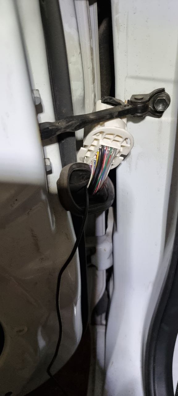

AIM wrote: Wed Aug 10, 2022 1:22 pm Also the passenger door lock/unlock actuator stooped working too, any idea if you or any other member faced the same ?
Thank you all
yes, my friend's car had the same problem at first with the door bottom light did not turn on after a while door switch failed. I found a problem with the door connector water passed the dust cover and damaged the connector.
