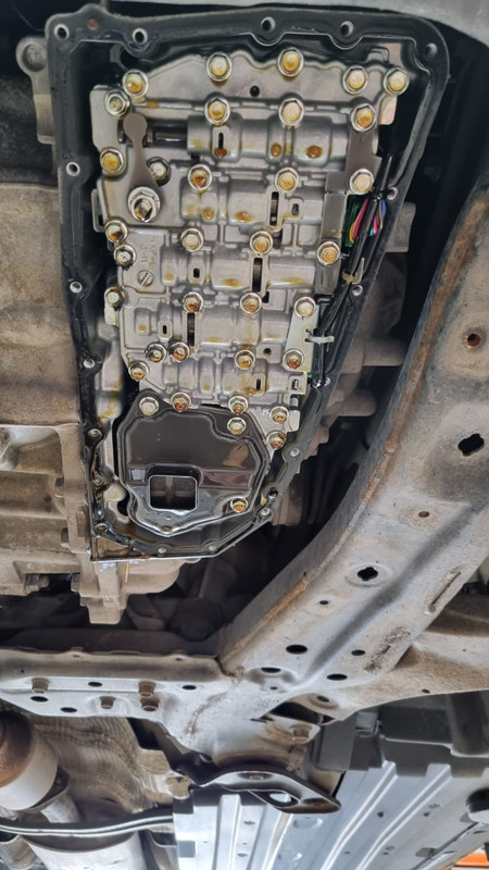

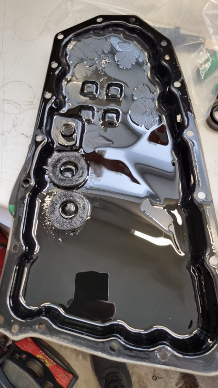

So they simply told the transmission is bad, so I have to either pay 11000€ to REPLACE the entire transmission or they can remove the transmission and send it to other nearby service that is specialized in transmissions, to have a look at it. They also made these 2 pictures of the transmission.

Great pictures. The filter screen is clogged with teflon from the primary pulley sealing ring. The steel peelings is from primary balls and piston. From what I see, You will need Primary pulley asm, belt, new flow control valve and oring at the torque converter. Parts are$400 plus shipping .Package would weight 50lbs. Primary would be converted to long pin and ready to install.

Yes. Your primary pulley only has six balls , two per flute. It’s just not heavy enough. I source my pins from eBay and are bearing steel pins. Here’s a picture of what I normally find when this transmission comes to a stop
This damage can be fixed quite easily going through the back of the transmission. You just have to know how to get it all back in there. The rest of the transmission holds up very nicely with the exception of the flow control valve. If the fluid has been kept nice and clean and the miles are 150,000 or less the flow control valve will be pretty nice and not necessary to go after. It lives in the front of the transmission in the pump.
