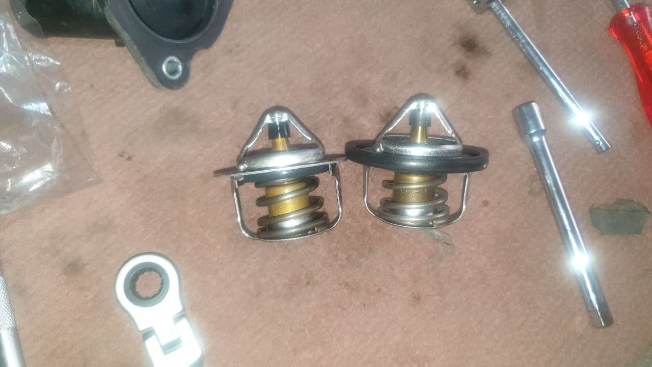

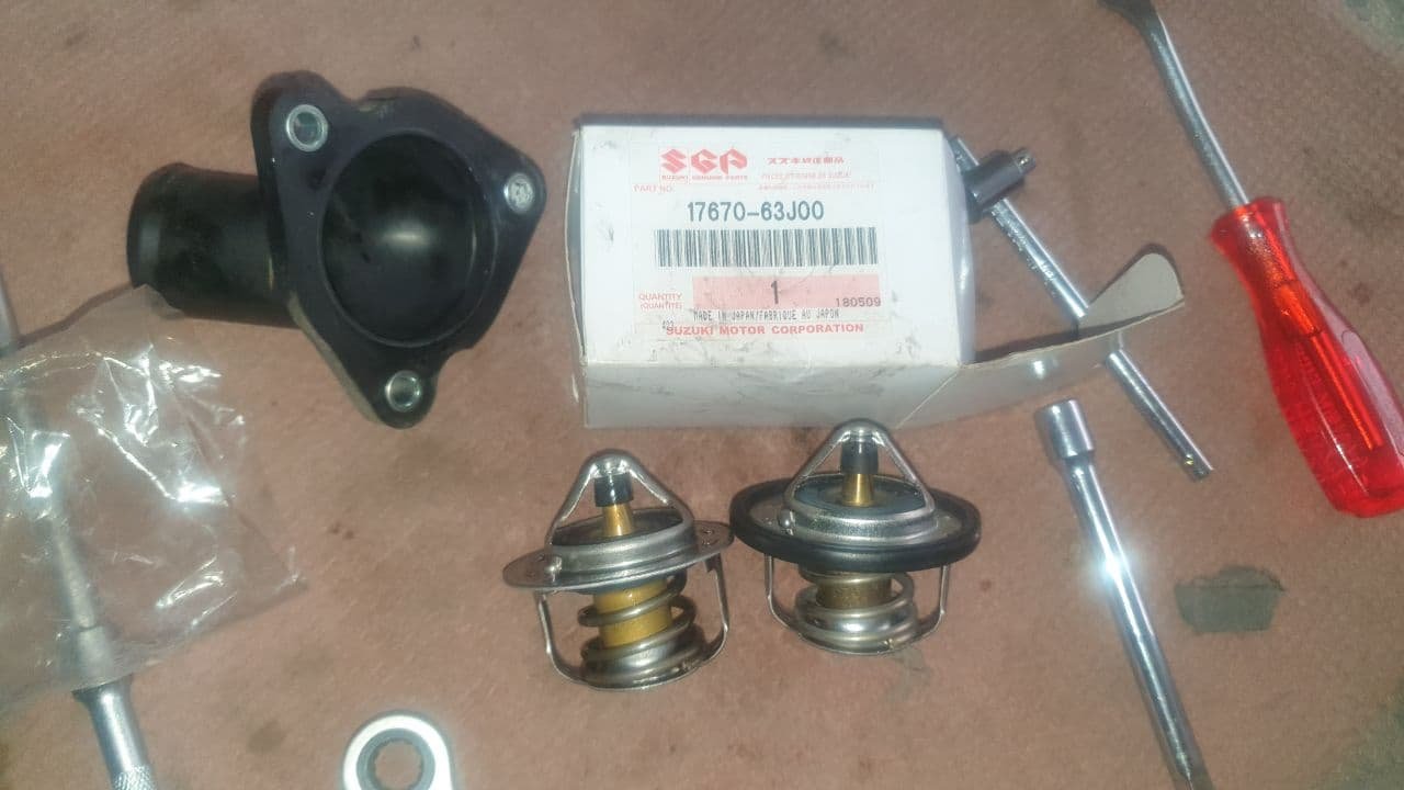

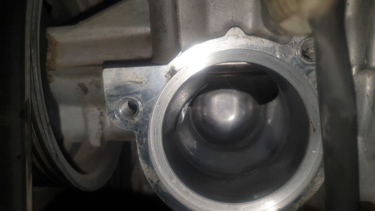

it's been around a year since I changed my coolant from Blue into Toyota SSLC (the red one). I decided to remove the thermostat to check for any corrosion. and here is a result
inside of water pump
no corrosion :D since I removed the thermostat I decided to change to the new one :
so I guess changing blue coolant to red done no harm to the engine.
