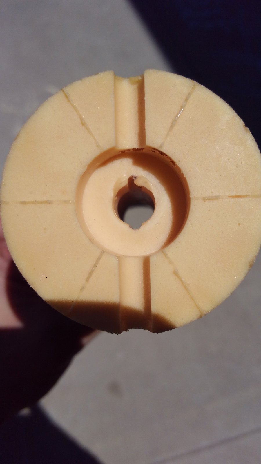

The KYB SB113 bump stopper/boot have a different shape and design from the OE part. A major difference is the diameter of the bump stopper in that the KYB part is larger and this posed a problem: it's too big for the Kizashi's rear shock mount. It literally did not fit into the recessed housing on the mount given the larger diameter.
The picture below is the mount on the top of the bump stopper. The top of the bump stopper was too large to fit into the mount without some cutting modification.
While I considered reusing the OE part given it was in good condition, I considered the fact that, A) the revised part didn't really prevent corrosion, B) I already paid for and had brand new SB113 parts, and C) I no longer live in a climate where humidity is any significant consideration. Thus, I opted to cut around the top of the KYB SB113 bumper stopper's foam to make it fit. There was no way it was going to fit without this modification. Once I trimmed a bit to make the top of the bump stopper fit into the mount, I installed everything. During the installation, the bump stoppers and the shock mount did not stay mounted to each other so I had to rely on simply driving on the road and subsequent suspension travel to place the bump stoppers back into the mounts naturally. Both sides are now properly seated into the mount and fit nicely. Though I did not reuse the OE bump stoppers, I kept them. I cleaned them and will keep them stored in case I ever need to resort back to them for whatever reason. They were in good condition and could be reused.
