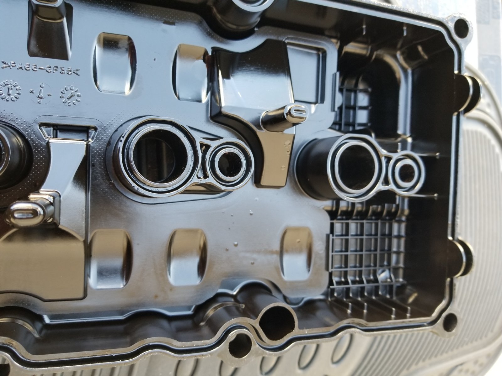

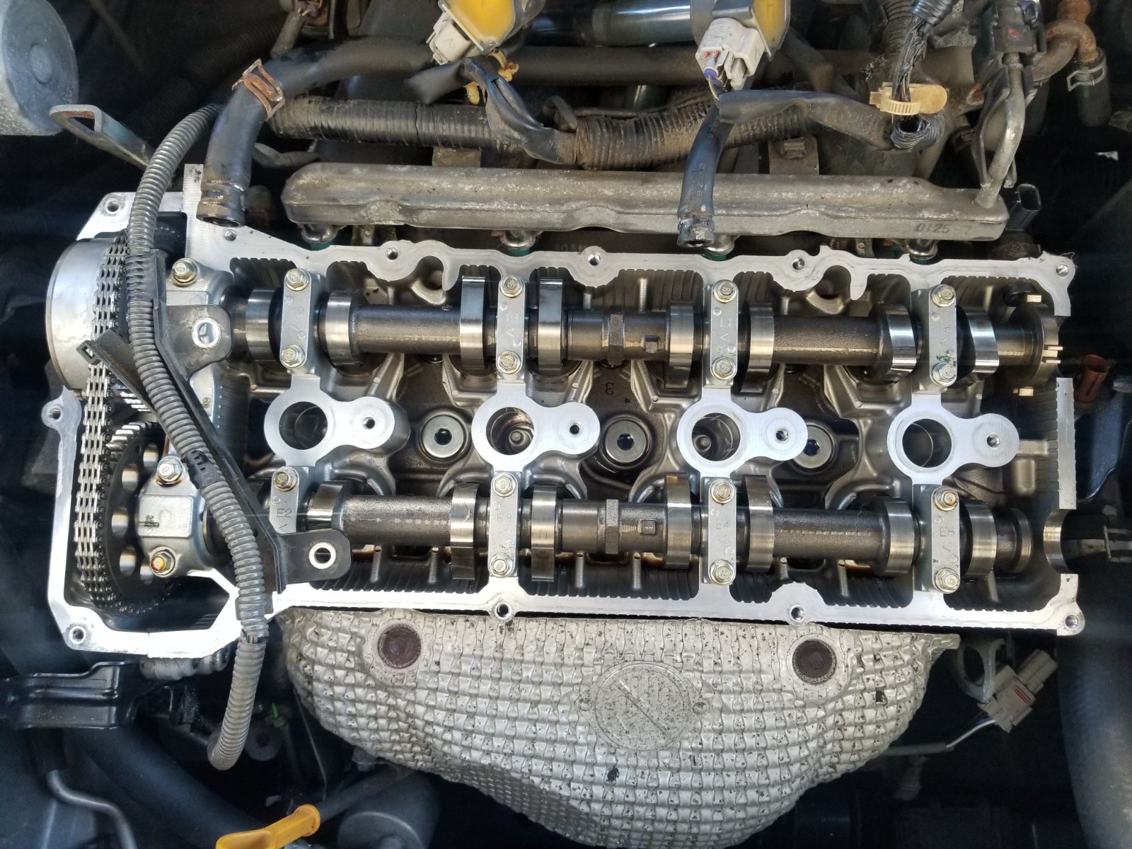

Forgot to mention the car has 110k miles
The engine looked amazingly clean when I changed the valve cover gasket
See attached photo
