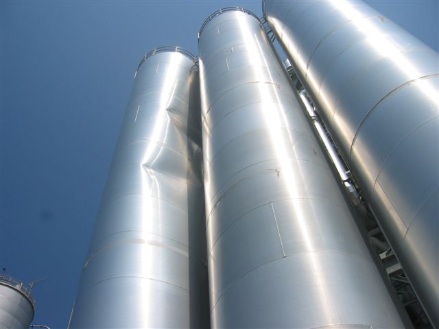

Finally found this pic during a start-up I'd done demonstrating the destructive power of negative pressure...all because some guy didn't follow installation instructions on the silo's venting device. Failure to remove a simple (and small) piece of paperboard packaging:

Yes..this happens a lot. Everything closed on a tank and while pumping out of the tank you create a big vacuum. Pressure difference witH outside gets huge snd tank will implode.
@work i saw this happening with a tanktrailer of a truck and also with one-cubic container which we call IBC's over here :D
