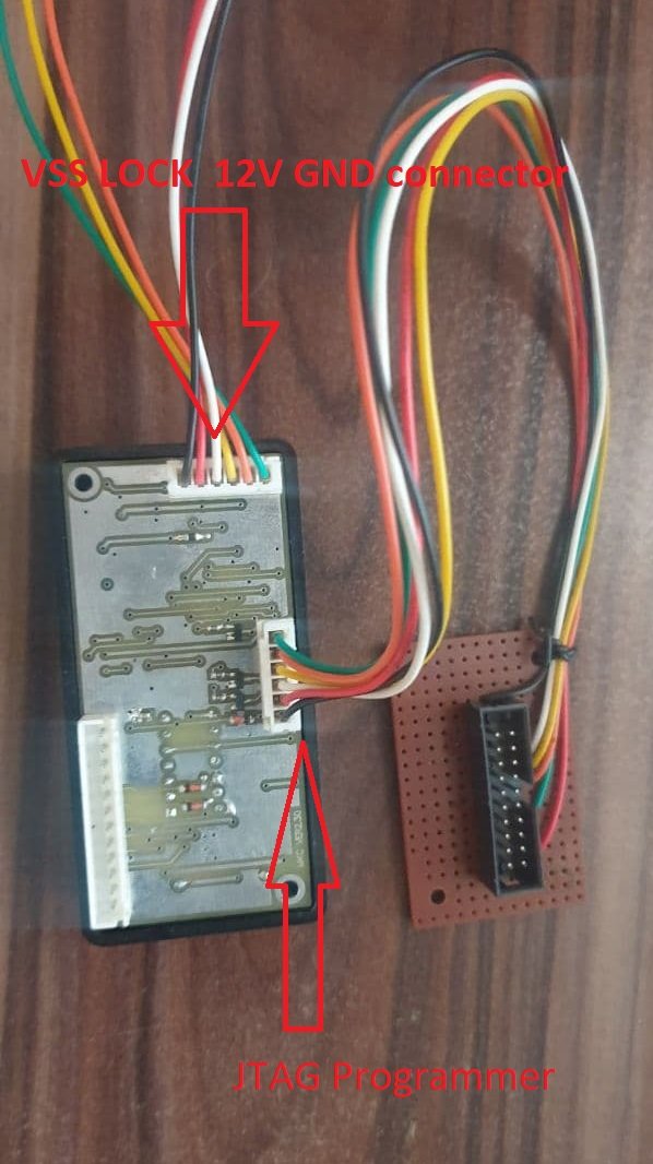

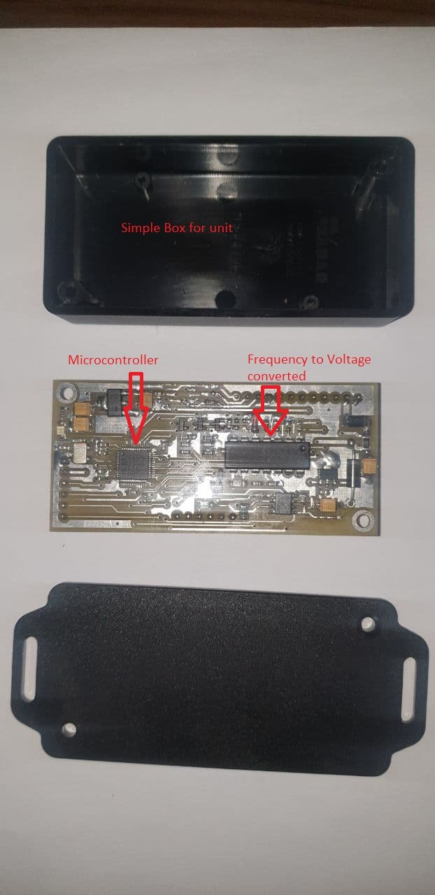

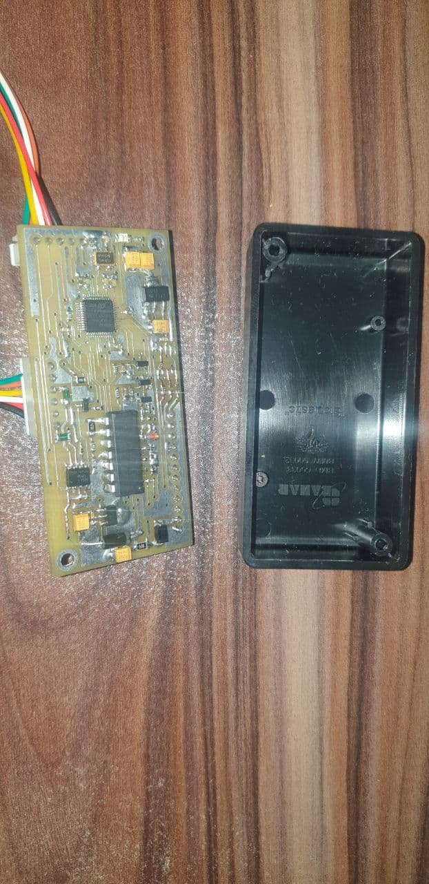

this is my unit to control some task in my Kizashi
it a simple 2 Layer Printed Circuit Board(PCB) which I designed, make, and assembled and black BOX to mount.
this PCB has 2 types of connectors one for tapping into car signal wires such as VSS(vhicle speed), DOOR LOCK, ACC(12V) and GND and one for programming microcontroller inside PCB.
in order to work this thing first, I tap into the car signal and connect that cable to my unit then press the car start button once to provide ACC power to unit after powering up the unit then I connect the programming cable to the unit and program its internal flash of microcontroller and that's all disconnect programming cable and now the unit is started and running every time I start the car.
if the car is off then the unit is off so there is no power leakage problem.
I mounted this unit in the back of the headunit and all of the required signals can be accessed through the head unit connector.
that's overall use case of my design. sorry for the bad presentation

SAEED_KIZZY wrote: this is my unit to control some task in my Kizashi
