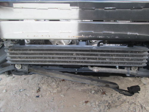

The Kizashi's OEM cooler is tiny in comparison though possibly longer in length. Here's an Ebay listing where you can see it well.
http://www.ebay.com/itm/10-12-SUZUKI-KI ... 1291162633
In case that link goes down, I've copied the photos from the listing (and of RRM's cooler) and have uploaded them below.
RRM's CVT Cooler:
Suzuki OEM CVT Cooler:
Something isn't right. I don't think the picture from RRM is the actual cooler as it would be way too dense for a 8.5"x11" radiator. It wouldn't be the first time RRM used random photos; the Kizashi's rear sway bar photo is from a Civic.
Also, I don't have the exact measurements of the stock cooler (looks like ~4x20"?) but I don't think the RRM cooler will be an improvement.
The surface area of both coolers appear to be very similar. However, the stock cooler has the advantage of greater frontal area. Also, I believe longer tubes are more efficient.
I could be wrong though!
