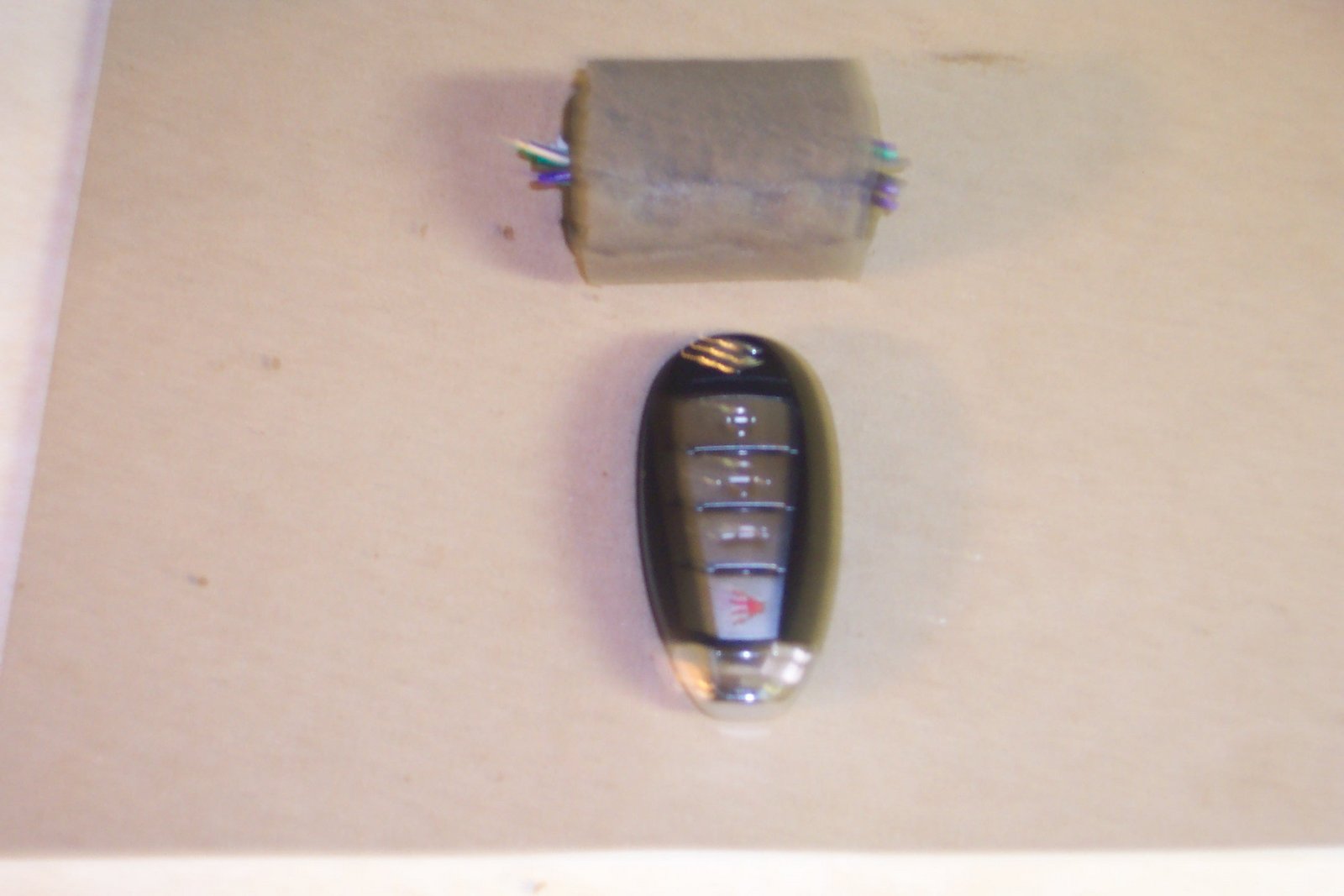

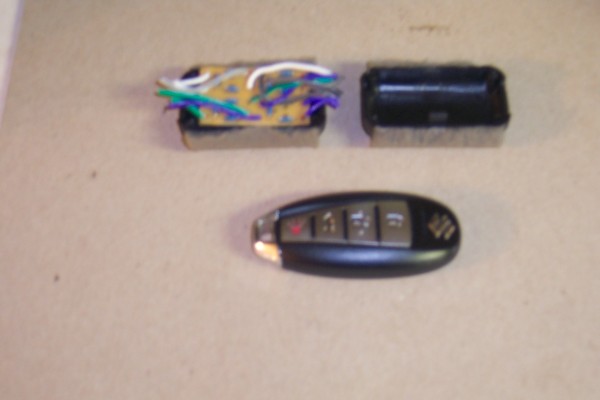

I called Rockford and asked them if a approved Rockford sound installer was allowed to look at my car without worry of dealer bullshit over warranty and who works on it. Well turns out they are allowed to work on my car. They spent probably 1hr 45 minutes combing Kizashi websites and forums over my issue. They couldn't believe all the things dealers are doing to solve this issue. After close examination they found Suzuki used several types of head units and thus they ended up putting another inline crossover in the wiring harness. This is not a good thing as they explained it will cause every issue posted here to date. With my approval they pulled the Suzuki wiring harness out (section) and removed the crossover as the stereo has a better built in one as explained by the stereo guru. So I spent $107.00 in labor and can't believe how this stereo woke up. Everything is clearer and punchy we cant listen to a DVD over volume 10 its just too loud.
So if your the proud owner of a Kizashi take note if you dont have this problem its just a matter of time before you do. This is a engineering issue that needs to be adressed by suzuki. Rockford said they made those changes after they designed the system without consulting us. So there ya go the fix is posted now go beat up your dealer/warranty company to pay you back for out of dealer work is almost never payed for if there is a dealer close by.

You say you have the NAV, which I am pretty sure contains the crossovers in the head unit, so with inline units, I can see how all the nav vehicles will have problems with potential signal loss.
Where exactly were the crossovers located (so we don't have to pull the entire wiring harness out of the vehicle looking for them?)

I just got my Scoshe 106b wiring adapter (I am about to fit a double din "all in one" unit to my Rockford Fosgate equiped Kizashi) and that looks exactly like the above pictures. As far as I can see it isn't a crossover but a "line out converter" that converts the (high level) speaker output of a standard stereo, to the (low level) rca inputs normally found on amps.JakeRam wrote:Has anybody else tried removing the crossover? Confirm where it is? How hard to do??
As this is the only adapter cable I have been able to source I would bet that this is what the aftermarket installers have been using, even if the head unit has a suitable pre-amp out for the amplifier. While it works, if you have a preamp outputs from your new stereo, you will get better quality by using these and bypassing the LOC (line out converter).
