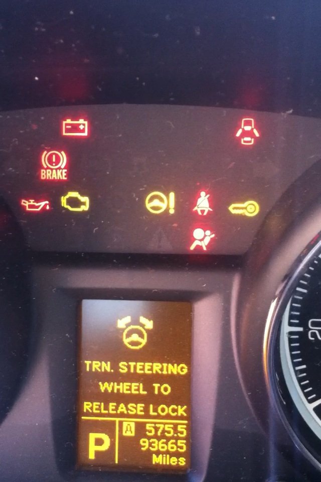

My 2010 Suzi won't start

Tells me to turn steering wheel to unlock and it won't start iv had it at the dealer but they can't figure it out

Russell22

Iv tryed turning it but il try alittle harder but its not locked when it says that i just don't get it
I'm confused, so the wheel turns? Or is it locked?

Yeah the wheel turns and it still tells me that. It dont make sence to me cause it dont do it all the time
It sounds like a sensor has gone bad or there's a wiring issue. Is the car still under warranty?

Well, you said this happens intermittantly. Do you see pattern? Does temperature make it happen more or less? What about weather like rain? Bump roads? Smooth roads? Weekdays? Weekends?
Finding a pattern will give you some clues to follow to the source of the issue. My gut instinct is that it's a loose wire or ground.

It happens more when its cold but still will when its warm also
Can you you hear the steering wheel lock disengaging (on mine I can hear a soft "clunk")? Perhaps in the cold weather it is seizing up a bit and isn't fully disengaging, not triggering whatever senses the wheel is unlocked? It could be something as simple as a microswitch not being activated.
Some gentle thumping around the steering column might help? Be careful of course not to damage anything.... The lock mechanism must be somewhere around where a traditional key would be inserted.
