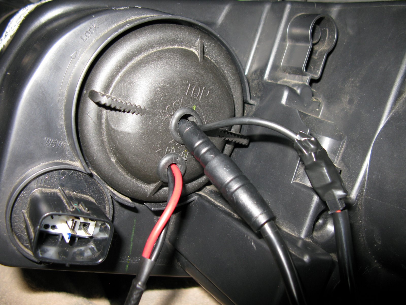

No, I've had no issues at all with condensation in the headlights or tail lights. However, I make sure the dust cap is sealed. I also have drilled holes in both the low beam and high beam dust covers, but the holes are closed well with rubber grommets around the wires. When I had my LED kit installed in the high beam and ran the capacitor harness out, I drilled two holes in each high beam cap. When I removed the kit, I bought rubber caps and used them to fill the holes. This way, they maintain dust and water resistance.

So this is what it looked like when I grounded my capacitor harnesses. I ran the LED driver and the entire capacitor harness outside the headlight. To do that, I had to drill the high beam dust cap, install rubber grommets, and run the wires out.

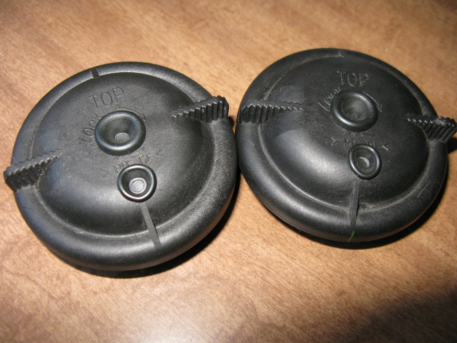

Now that I removed the entire kit, I bought rubber caps to fill the drilled holes to seal them up. I've had no issues with condensation inside the headlight and I live in a humid area and it has rained quite a bit since.

SamirD wrote:Nice. 8-) I was wondering what you were going to do with the holes. I would have just bought replacement caps from the dealership. :oops:
That would have been a pain and required a special order. However, finding the rubber caps was much harder than I expected. Home Depot, HFT, and local hardware stores did not have them. I ended up having to order a set of grommets and caps on ebay. However, these are perfect and high quality.
They even included caps that were 7/8 inch so if I ever needed to seal my low beam dust covers (they have the HID wires through it via a grommet), I could do it.
