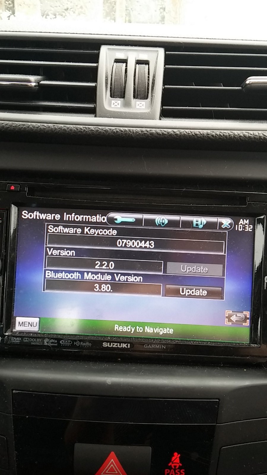

Everything above appears to be fairly straightforward and simple, with one exception. According to the instructions to update the Kenwood firmware in step one above (link to PDF instructions: http://www.kenwood.com/cs/ce/mm/firmwar ... rup_en.pdf) and following the steps to check your current firmware version... my unit currently says it is running firmware version 2.2.0.

I've attached a photo of my software / firmware screen for reference in the case that I'm looking at the wrong info on the unit or something.
