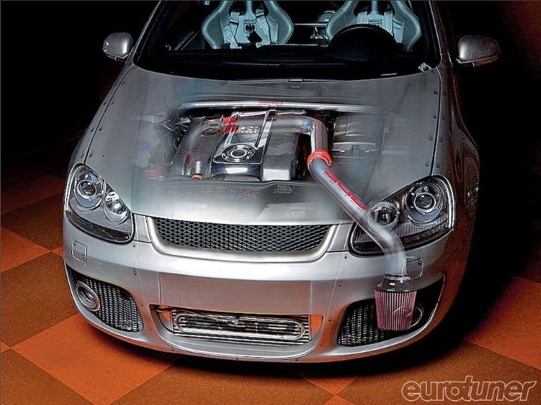

Yeah, there is no point if you do it wrong.
Most people do it off to the side, not around the radiator. The imagine below shows how most professional CAI installations are done.
