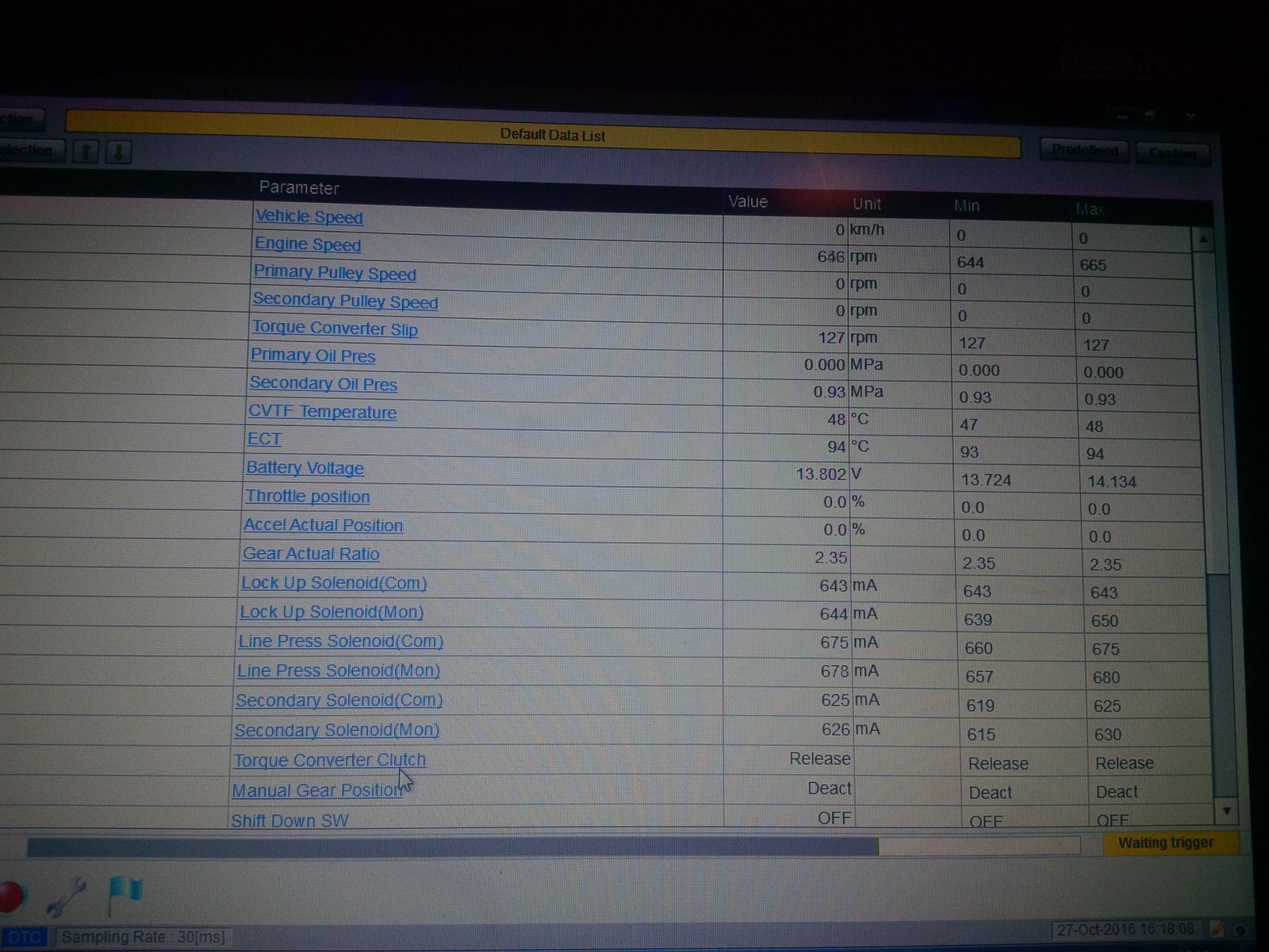

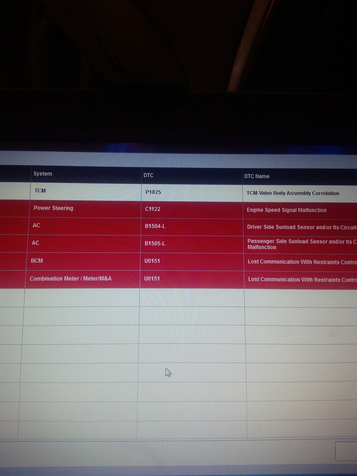

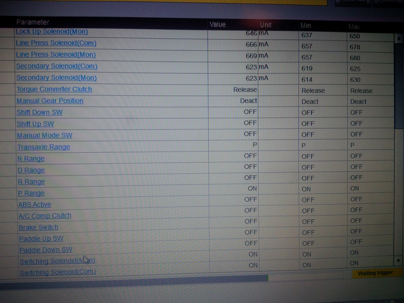

my kizashi gear box nit workig on DTC findings are as per attach picture
bijupat
Posts: 9
Joined: Fri Apr 08, 2016 8:53 am
it show primary pull y pressure not adequate
solonide valve are perfect on DTC
no errors in DTC
WHAT SHOULD BE PROBLEM
ANY TROUBLESHOOTING GUIDE?
I know very little about the Kizashi's CVT given I personally own a 6 speed manual. However, I came across this website a while ago that covers the issues typically found in the JATCO JF011E in other vehicles, but that's the same CVT in the Kizashi.
Hopefully, the info in this technical article can help. It does discuss some of the issues that Kizashi owners experience such as the delayed shifts between Drive and Reverse.
